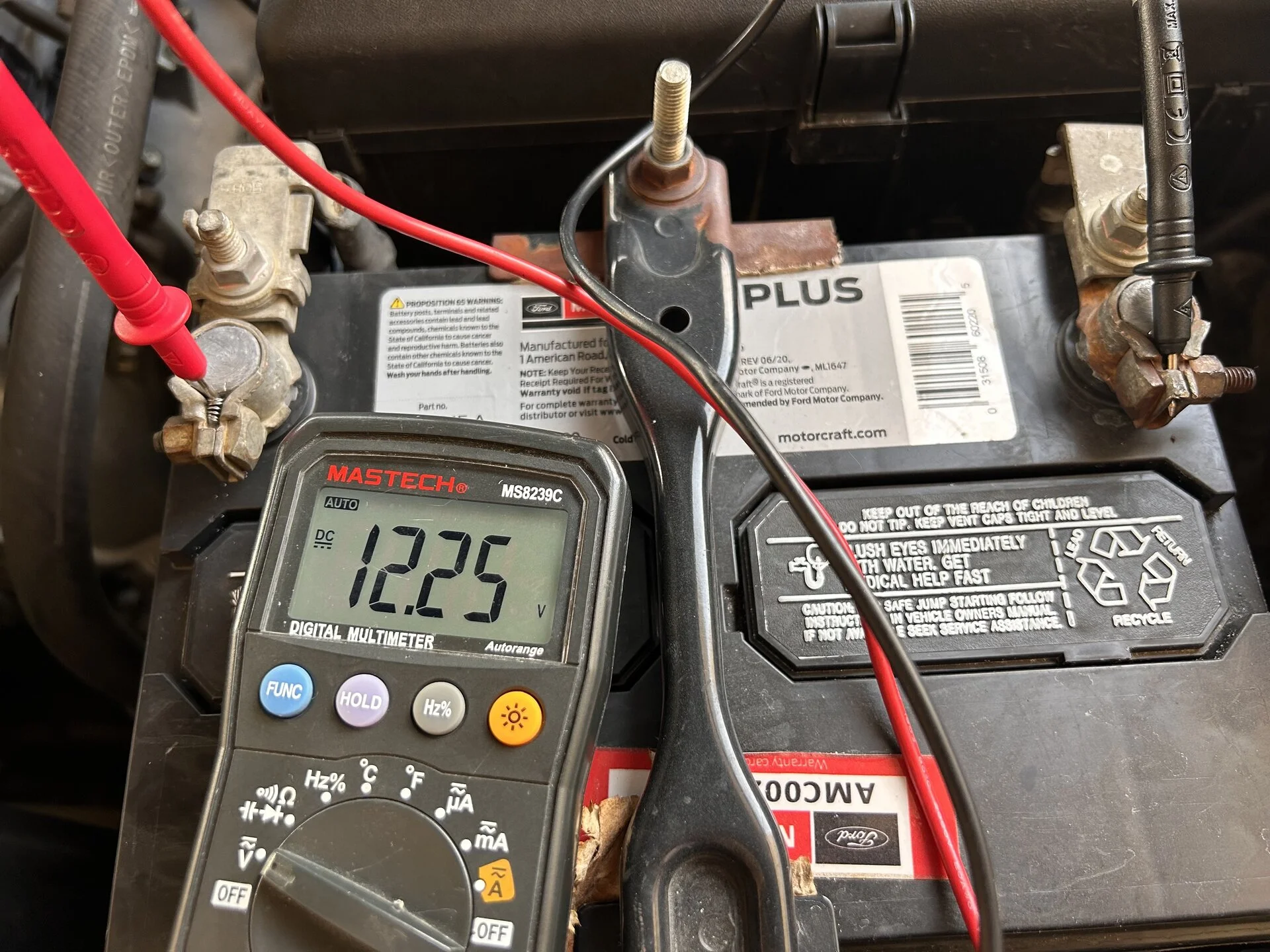

Battery health is good. Connections are tight.
Starter is original.
Milage: 320k Km

For what it's worth in regards to the battery I just went out for my weekly start on my truck out back and decided to put a meter on and record. Not necessarily apples to apples as my truck is much newer (2018, 60k) but my battery voltage sags much lower than yours during start and it fired up like brand new. Voltage bottomed out at 9.25. If it were the battery itself I'd expect a lower voltage under load. It could still be a high resistance connection between battery terminal and starter causing less voltage at starter though. Putting a jump start pack on would be a good test though if you have one.
Or maybe it's just because it's a Ford battery... jk.
An often overlooked connection is the negative to chassis. The connections at the battery are just part of the equation, speaking of which I would advise removing existing and wire brushing. Just because there is no visible corrosion doesn't mean none exists at metal to metal.
A multimeter on terminals won’t tell you if that battery is good. It will just tell you the float voltage but not cranking capacity. Would suggest testing it using a proper tester before diving into the starter.

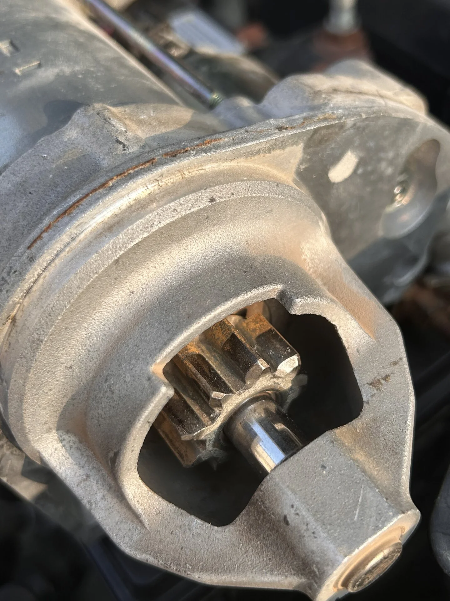

Replaced the Starter motor (used part), now cranking is normal, no hesitation or grinder noise.
See photo of old starter:

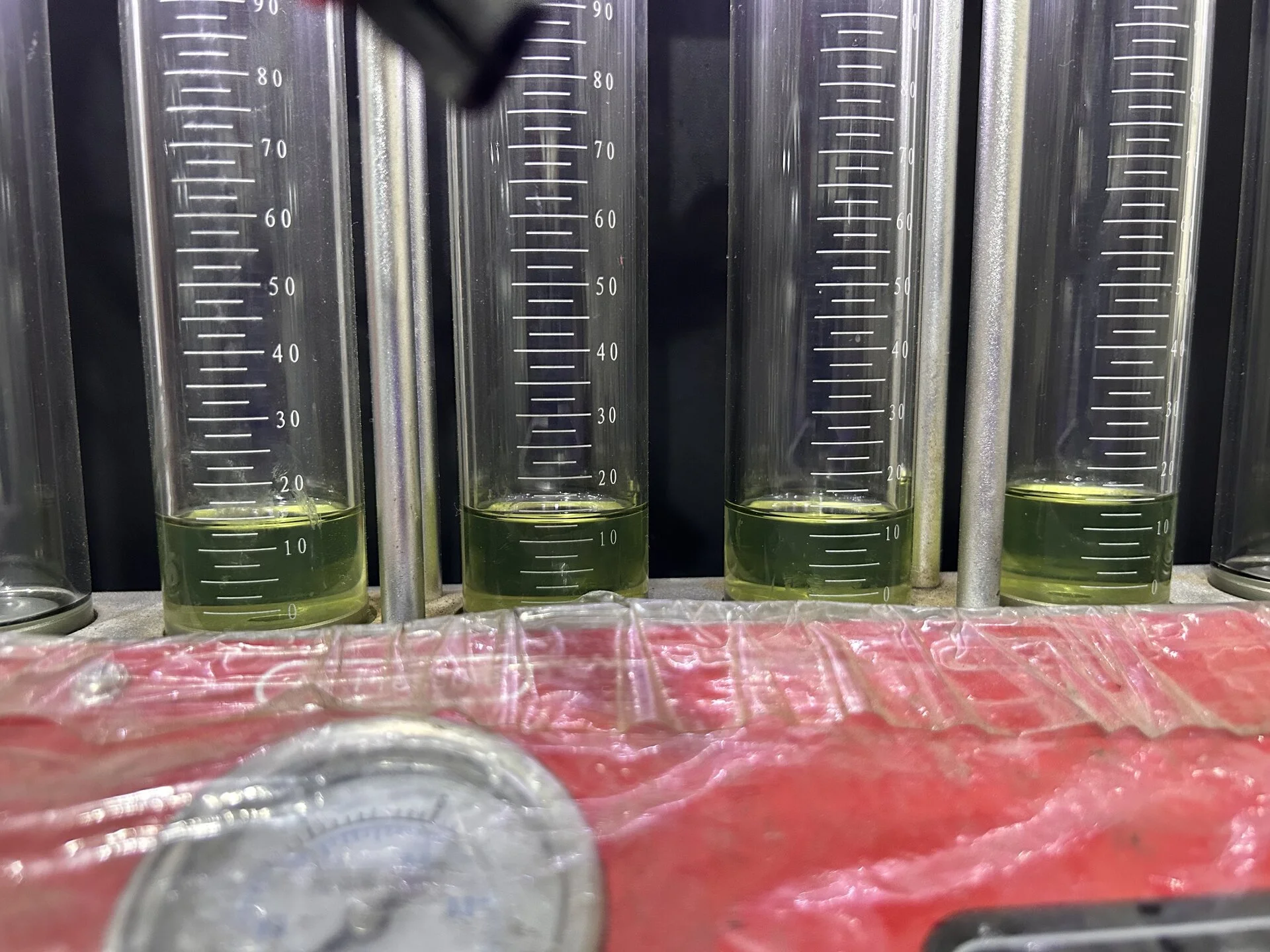

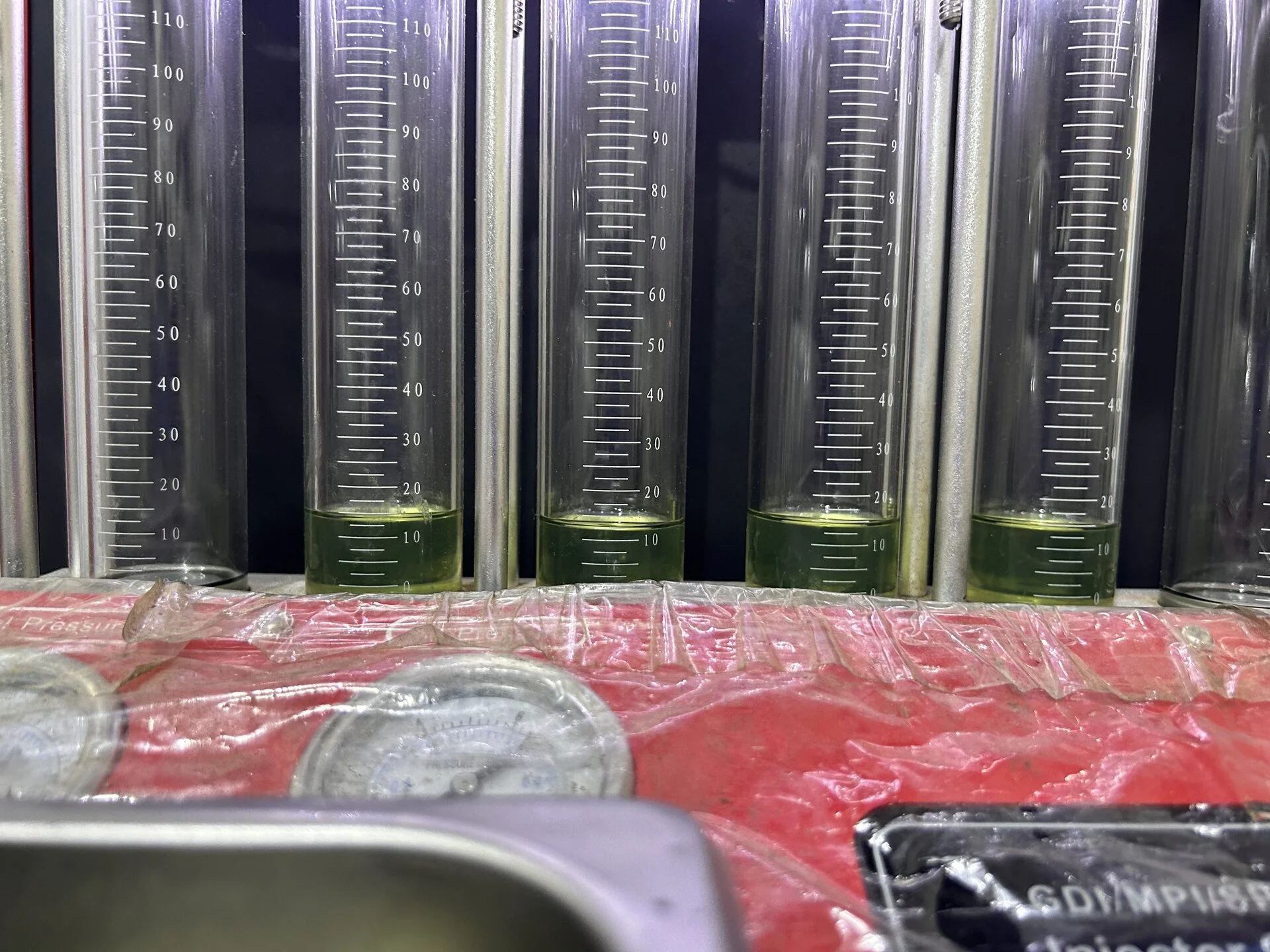

Then did injector cleaning (Ultrasonic).
Now getting the problem of Hard to start or extended cranking! It is not always though!
It happens when I come back to start the engine after 3-4 rest hours after a normal drive. See video:
That problem seems like it would be related to 'cleaning' the injectors.
