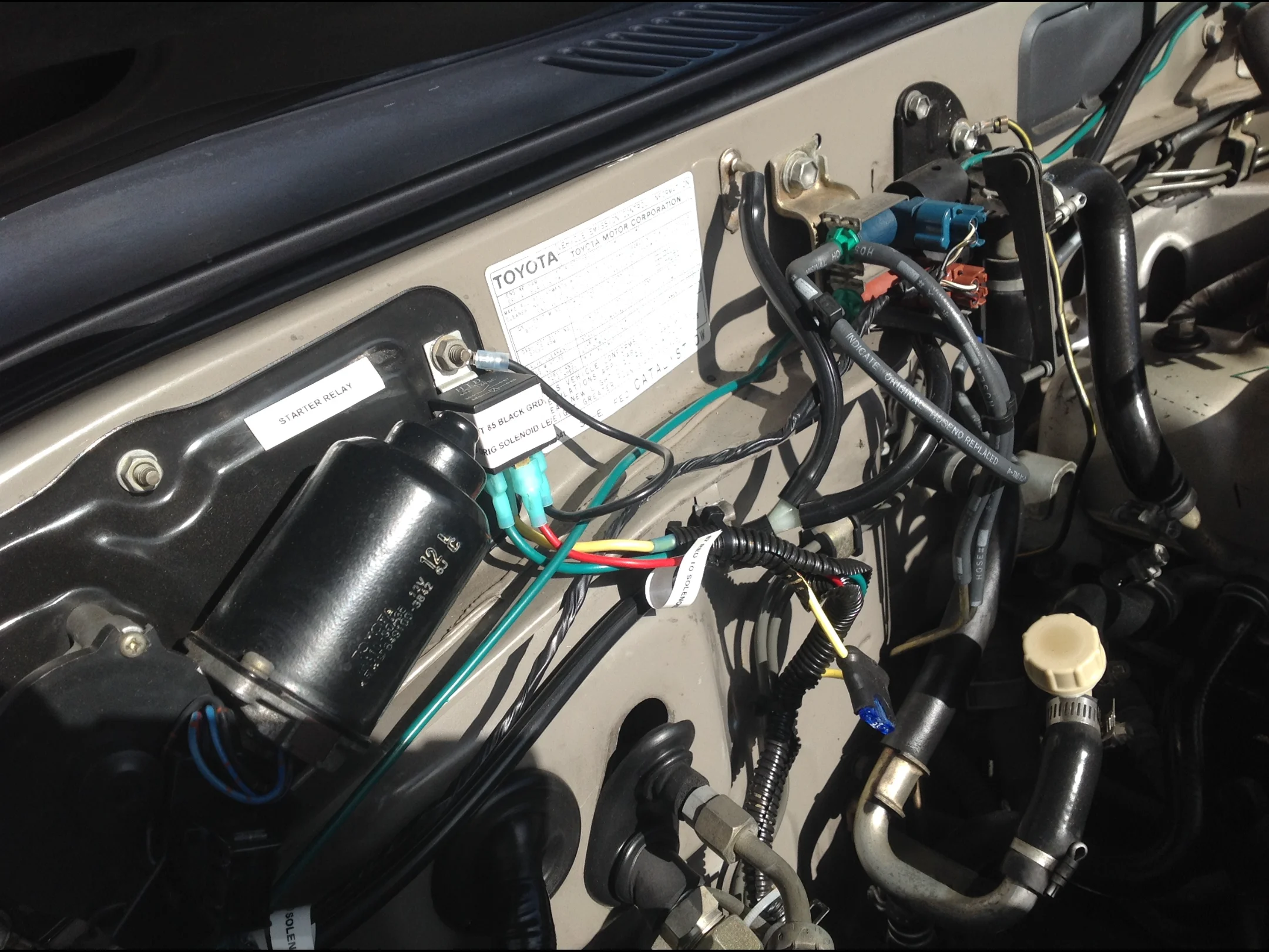

If so I would do this as a test: Run a wire straight from the battery to the starter solenoid. Touch the solenoid and if it starts that would tell me (past experience) that your wiring is old & not enough juice is getting to the starter.
The band aid fix (but definitely long term…years & years) is to install a $15 4 pin relay that will allow the starter to get full juice directly from the battery when you turn the key.
Did this on my 62, lasted until I sold it, which was about 5 years & probably still on it.
Starter original? Could be worn internal contacts and needs a starter rebuild. Cheap and easy.
Often results in an intermittent start. If you hear the plunger click, but the starter motor doesn’t spin, this is your culprit. Assuming the rest of your wiring (and grounds) are serviceable.
@frontviewmirror my post # 4: this TEST will take you maybe 15 mins. to rig up and will tell you exactly what you need to know. 10 feet or so of 12g wire. Run it from the battery to starter solenoid. If it starts there’s more than one way to address the fix. My post describes one that works well.

Sounds to me like your original starter solenoid trigger wires are old and not able to supply enough juice to trigger the starter solenoid properly. You can put a fender mounted solenoid in for very little money. Use the stock wire as the trigger and run new heavier cable from the battery through the fender solenoid to the starter.
Since your direct hook up test kicks the starter on…your fix is in post 4 & 7. Very simple fix.
