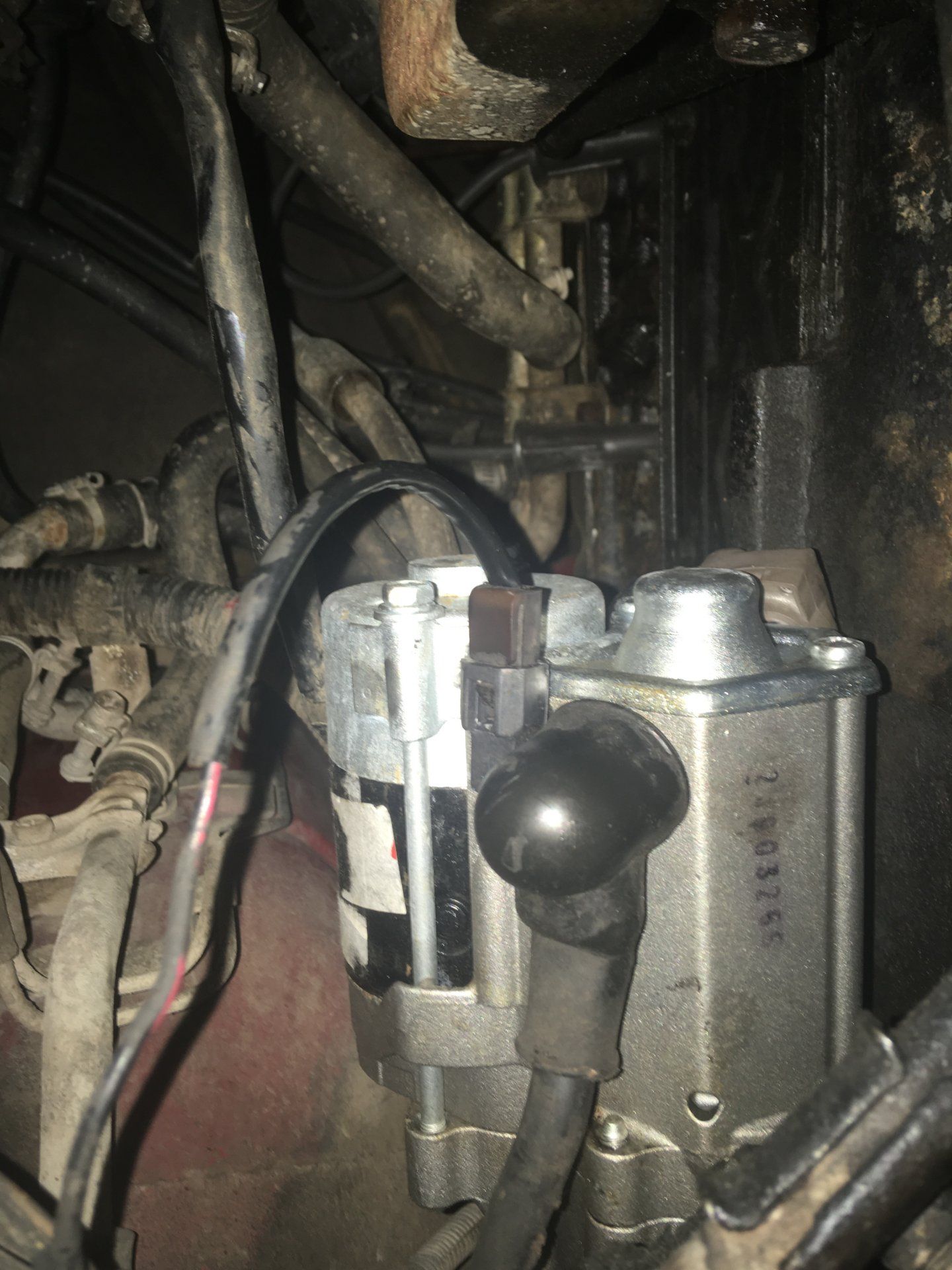

Follow up issues with the replaced starter in our 88. After replacing the starter 200 miles ago we had zero issues until yesterday after a 200 mile road trip. She failed to start. I crawled under and seated the connecting wire and she fired right up. Happened again after finishing the return trip but seating it didn't fix it. Kept trying and eventually it made connection and started.
So my question is am I missing something else it could be? Is there a way to clean these things out or replace it all together? I included photos of the connector. Hard to tell, but it appears pretty gunked up in there, but that isn't experience speaking. Still new to all this and learning my way around her.

Plug might have grime in it. Try spraying it clean with contact cleaner or if it's really messed up, cut it off & install a new connector.
What he said. ☝ Also the grounds from the battery and the ground on the starter can become unbelievably grimy and corroded. I good cleaning of the ground cables and the area where they attach sometimes has great results.

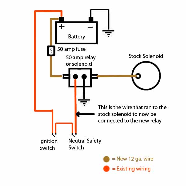

Consider replacing the trigger wiring and connector. The wiring gets old, the resistance increases, when the engine gets hot the wiring cannot carry enough current to properly trigger the solenoid and start the truck. alternatively you can install an aftermarket fender style relay, use the stock trigger circuit to trigger the relay and run new larger gage wire from the battery through a fuse through the fender relay to the back of the starter solenoid

I'd honestly suggest just doing the new relay modification. Unless you are trying to keep your truck showroom original. I think it will be easier to just used your stock wire and add in the extra parts....its a pretty simple solution and easy to put together...$30 or less.

One like this:
Amazon product ASIN B07MBRW5TT
I bet your local napa has one that works just fine. They are usually mounted to the firewall or a fender where they are out of the way.
Here is a good picture overview:

If old wiring is your problem, and I believe that it is, this will fix it. $10 relay, some wiring, follow the post directions and done. It’s a permanent fix, mine lasted over a decade on my 62 and now going several years on my 60.
Prior to the fix had constant click, click. Did the relay fix, never, ever clicked again. Never.

I have had starter issues with a 3FE and 80 series and have cleaned terminals, upgraded wiring, rebuilt starters, installed OEM rebuilt starters only to have the click, click issue return. For both of these Cruisers I installed the type of relay and wiring that John McVicker is recommending and that has cured the problem in both of these trucks.
Installing a relay is easier than it appears.
