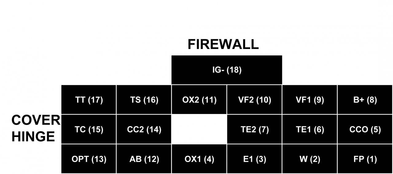

You can bypass the fuel pump logic by jumping B+ and FP on the diagnostic connector on the firewall. This should only be used for diagnostics as the fuel pump will continuously run with the key in the ON position even with the motor off.

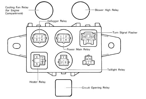

The fuel pump relay is called the circuit opening relay on a 3FE. There is no FP resistor.

This basically eliminates the fuel pump as part of the problem or the problem itself. This is the first step to diagnosis that a shop would do and charge money for.
If it stays running while you've got the logic bypassed then we will work up the line on the electrical side of the fuel pump. But at least we will know that the pump is Ok and that it is an electrical issue on the fuel side. If the problem persist then it could be an issue with the pump itself (I think that's unlikely in this situation but is possible) or more likely something else electrical. In the event this doesn't keep the truck running then we will troubleshoot a different system until we get a result.
This first level of troubleshooting is to start pinpointing the issue, None of us can tell you what to start looking at as suspect until we get a better idea of what is going on. Better to take the time and test rather than throw new parts at a problem when you're unsure of the culprit.
