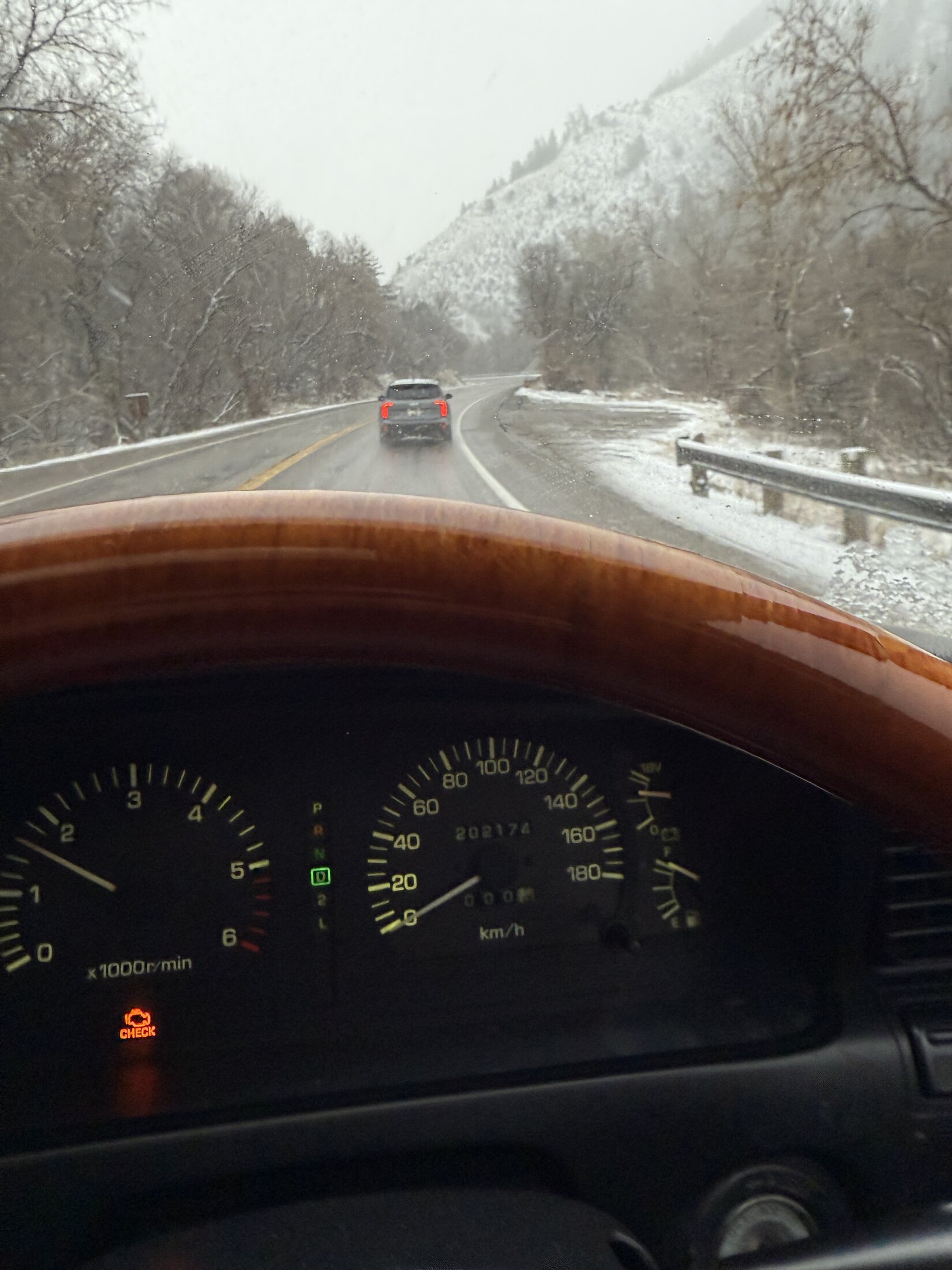

I was driving up a steep mountain canyon about 2 weeks ago and my speedometer suddenly stopped working along with my odometer and trip counter. I thought it was weird but nothing else failed so i kept driving. As I pulled into a parking spot at the ski resort, it stalled out and died. I got it to turn back on and decided i didn’t want for it to be stuck up there, so I headed back down the canyon. Halfway down it died again and I had to coast into a pullout and get it towed again. The shop looked over the vacuum lines, tested the alternator and ran some electrical tests, nothing. From what they tell me, it’s apparently the throttle body which they have since cleaned and seems to think that’s the problem. I’m not so convinced though. It can’t be the EGR system because mine was deleted by the previous owner and I’ve had the check engine light on ever since I’ve owned the vehicle. (Unless I’m wrong about this too)

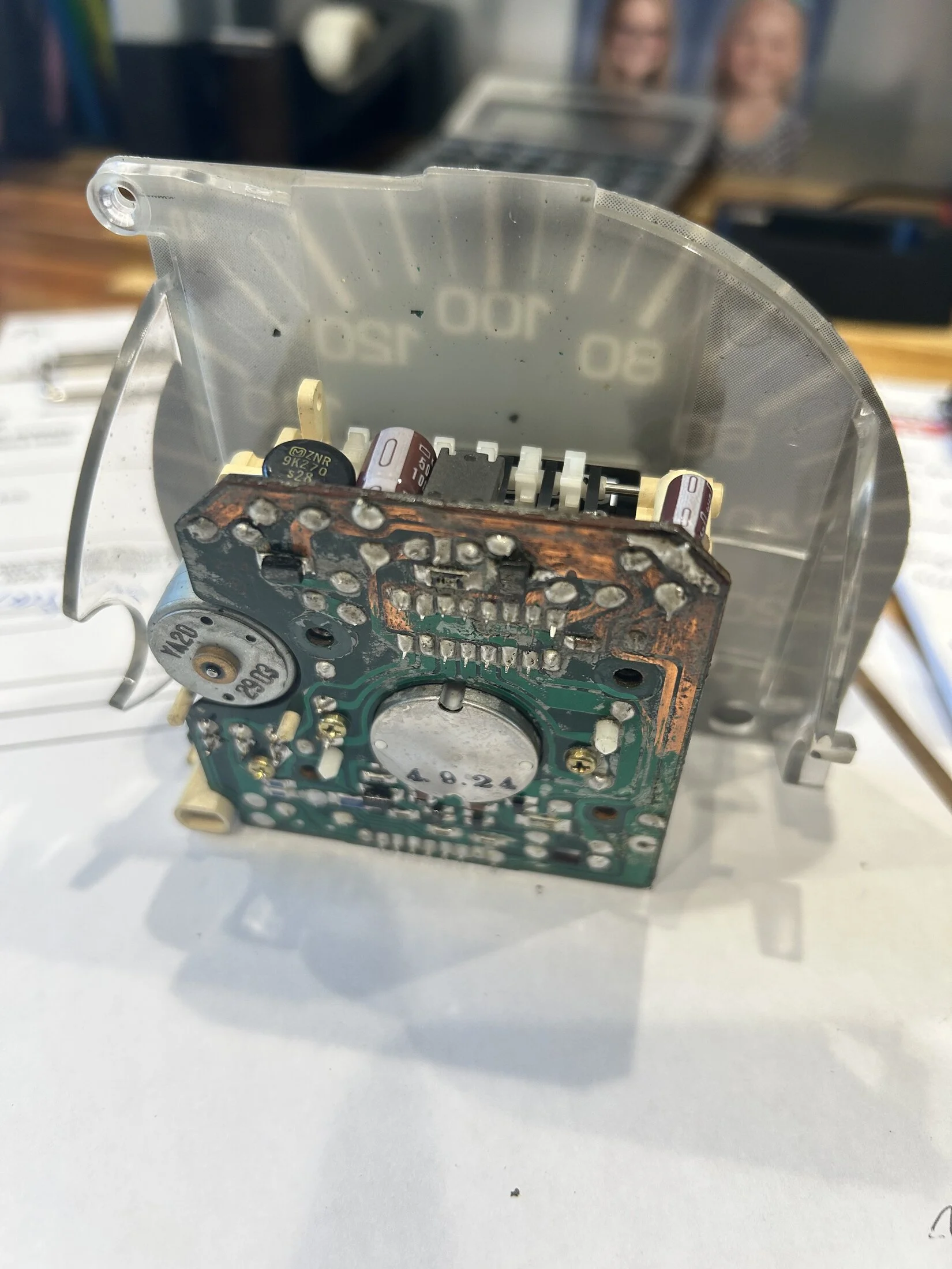

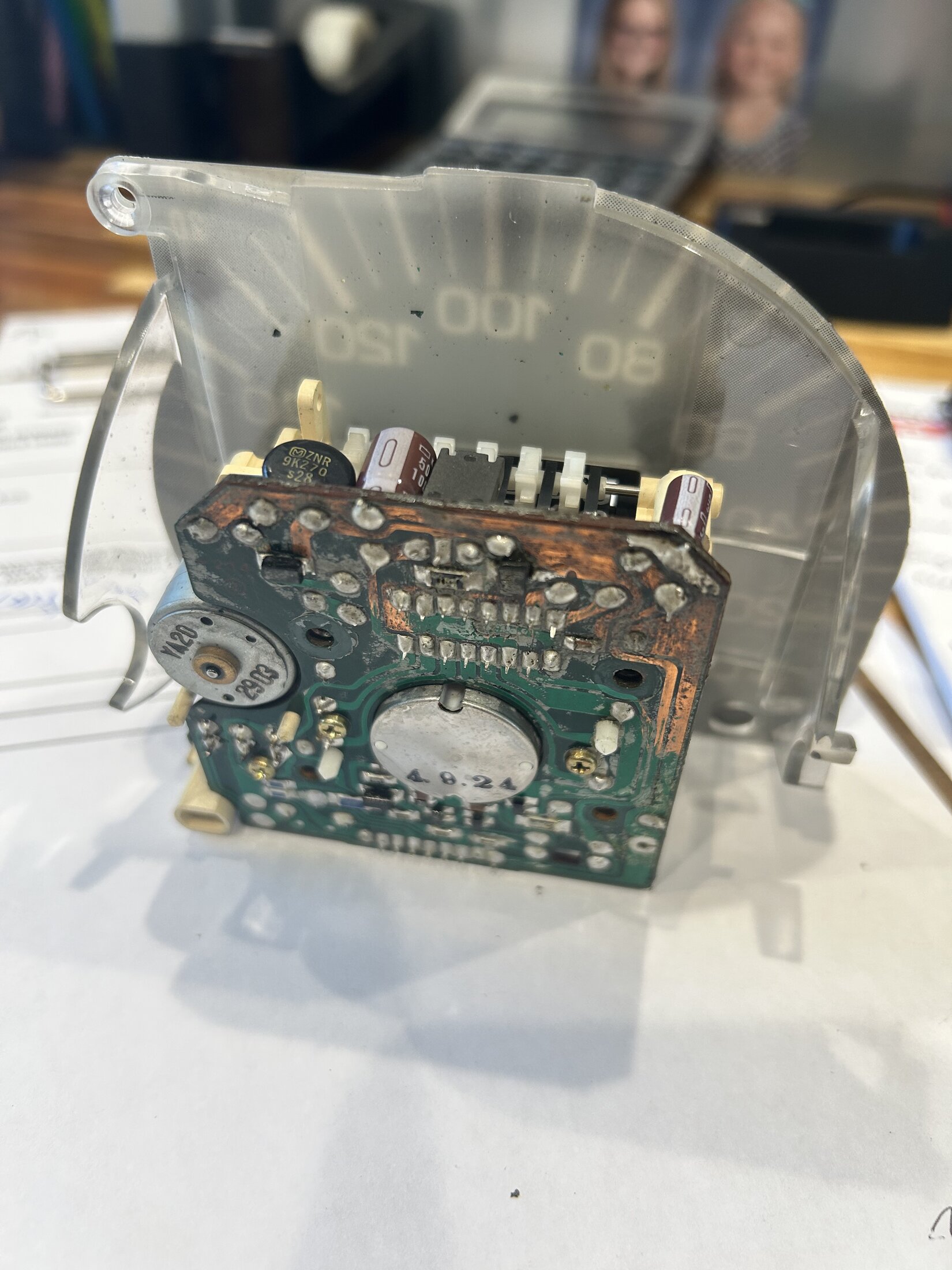

Now the speedometer they believe to be because of some copper being exposed on the gauge itself and some messing with by the previous owner. I just think it’s extremely weird that both problems happened to occur at almost the exact same time. I’ll attach some picture of the gauge.

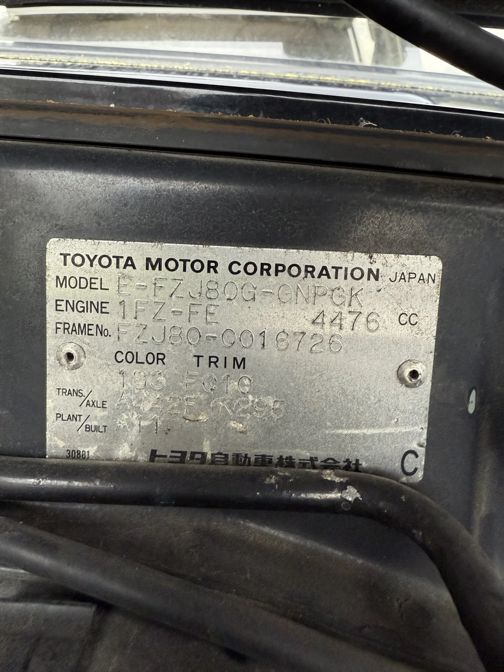

What's the build date on that truck? See VIN plate.
You have the 1FZ-FE, so it mostly matches a 1993 model in the USA.
The symptoms you describe are electrical, but there is nothing on the speedometer that will make it not run.

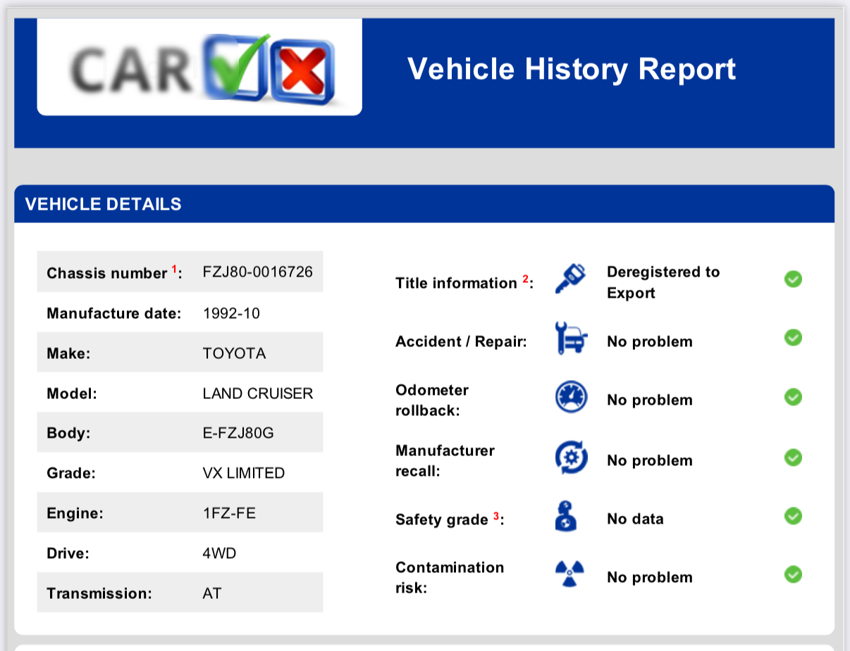

Doesn’t have a build date on it but the import papers say 1992-10. The EGR has been deleted on it. And it does have an alarm system but it’s never worked.

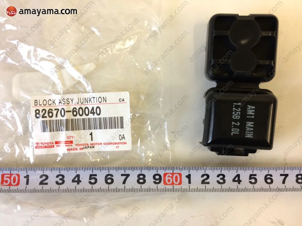

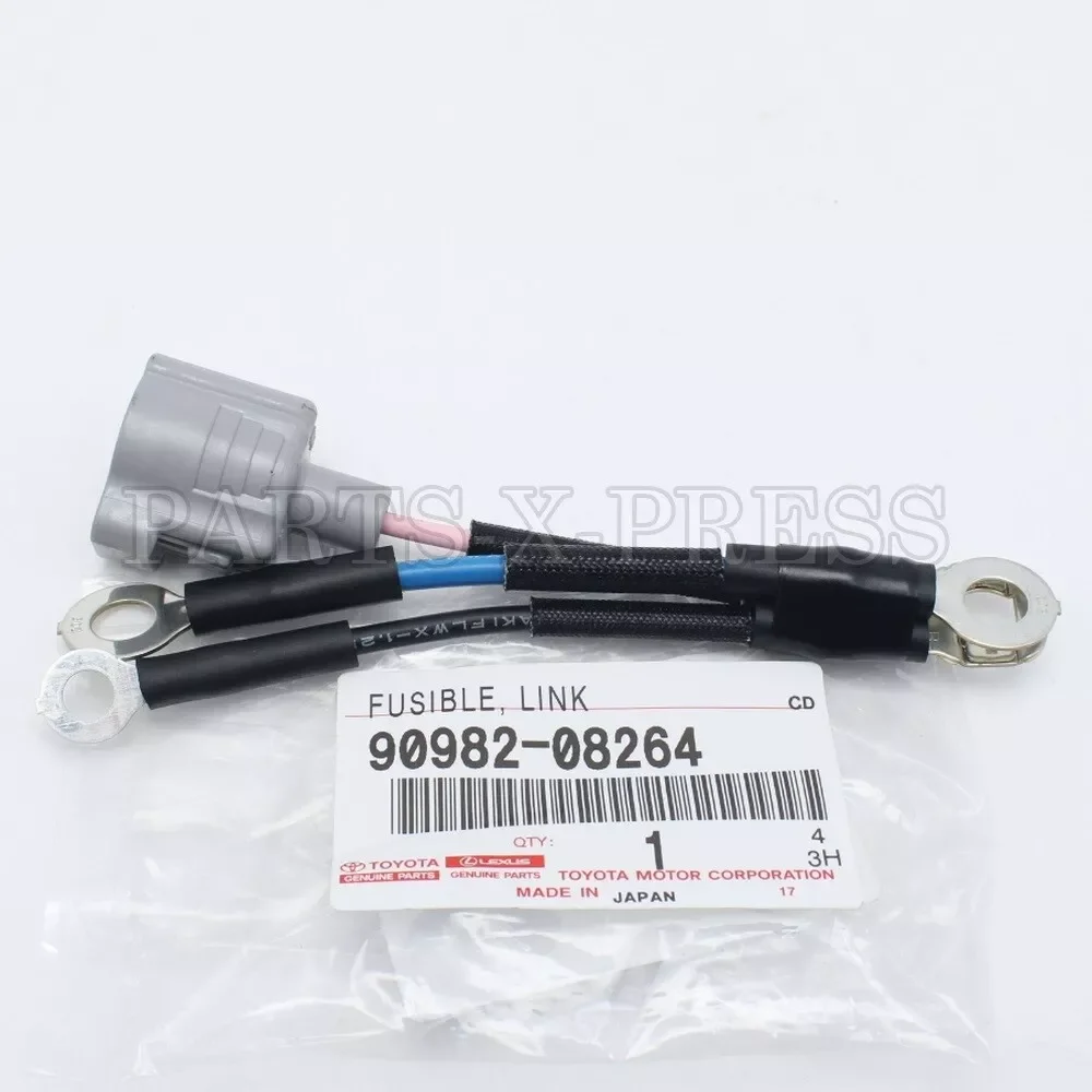

As with all things electrical on these vehicles, the very first thing to check/replace is the set of 3 fusible links off the positive battery terminal.
90982-08264.
These are a known issue as they are subject to vibration/fatigue and are inexpensive and easy to replace.
When you or your "mechanic" wind up breaking the junction box, the replacement is 82670-60040.

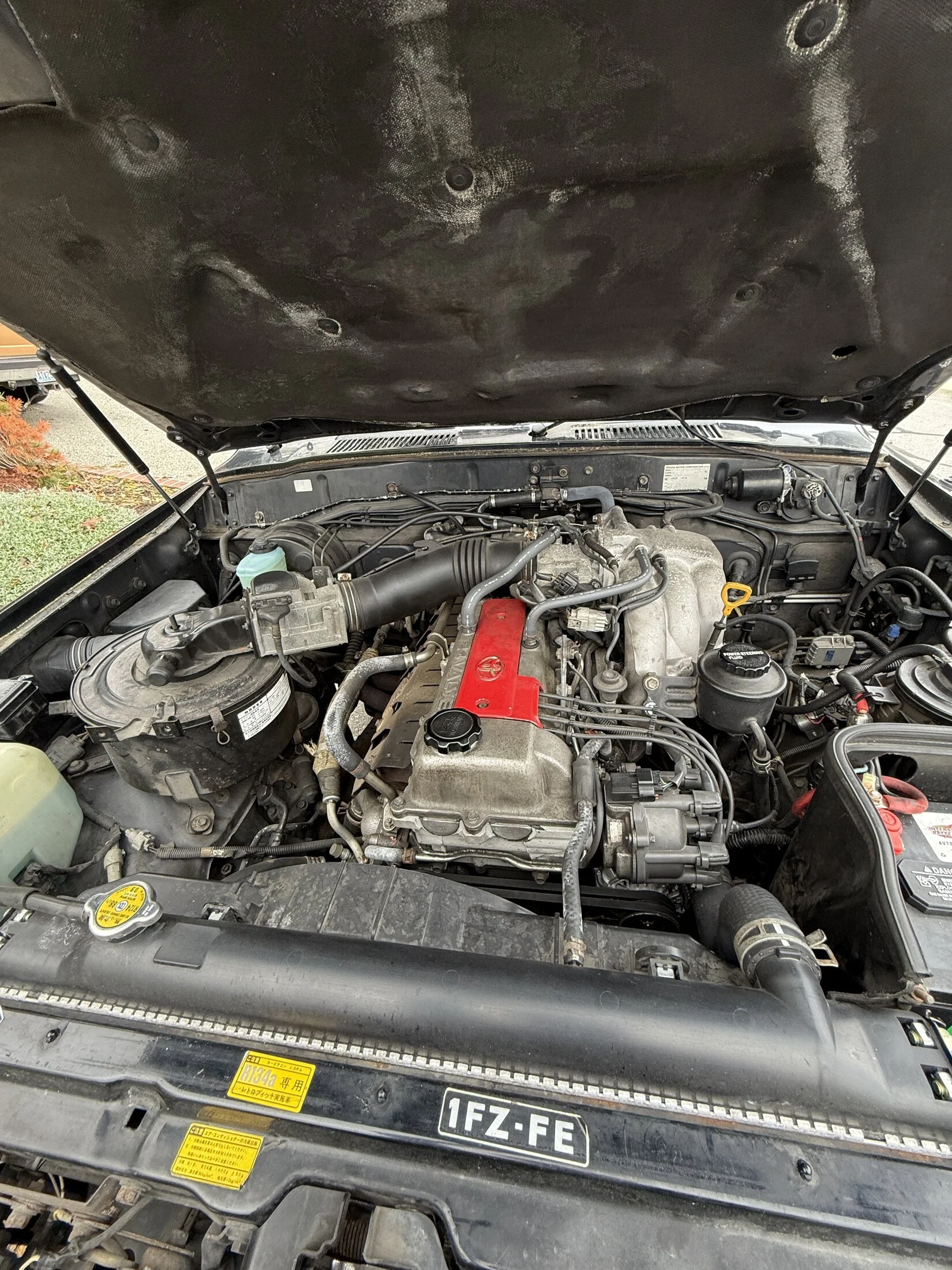

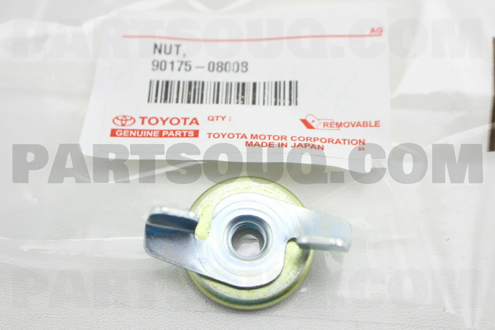

You're also missing 90175-08008 the wing nut for the air cleaner.
