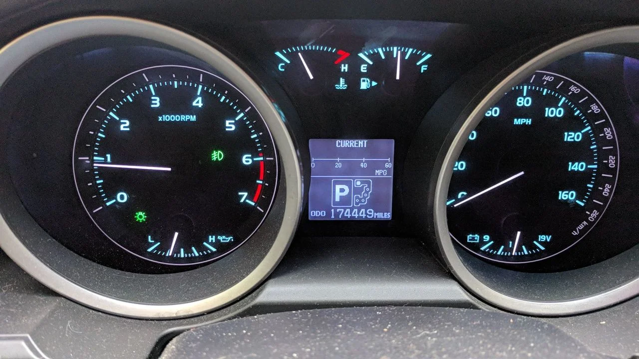

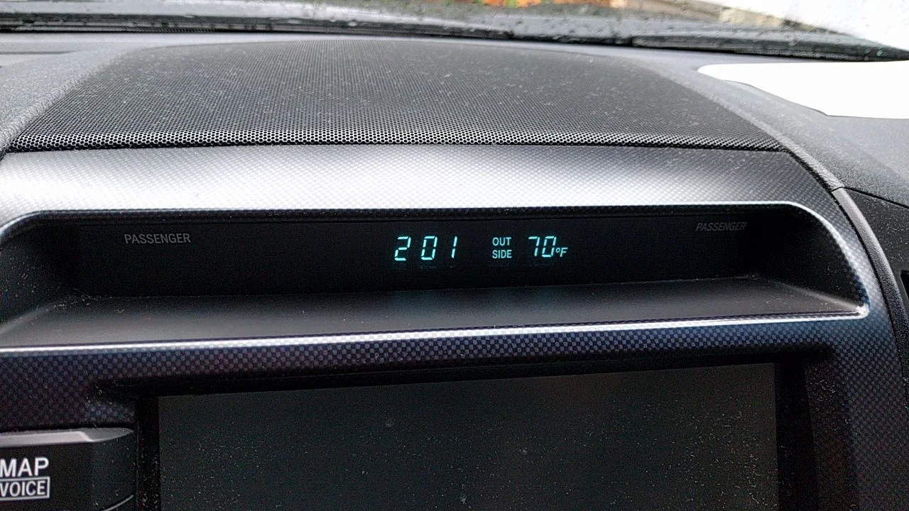

Two hours in a non-toyota shop, a new toyota belt and no more lights:
Submitted my reimbursement request to Toyota and they had me a check in under 5 days.
That may, or may not, resolve the underlying problem. Quite frankly, applying some DIY fix to a safety issue where there isn't a known fix is a bit foolish.
The seatbelt system is tied in with the airbag system (obviously) and any fixes at this point may actually keep the airbags from working properly. Unfortunately, you may only find out that it doesn't work as intended when it doesn't work as intended.
