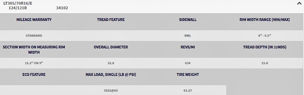

The trouble with wide on narrow is that many tire shops won't do this any longer because it violates the manufacturers recommendation. If you look on BFG's specs, for example, a 305/70R16 requires a 9" rim width per BFG. This is wider than the OE Toyota rim and therefore Discount won't install them because of potential liability. At least the two near me won't.
You're right. I'm not suggesting running outside of manufacturers recommendations as that makes load and capacities specs uncertain. Though I can't say I've never gone outside of those boundaries either.
Only suggesting running on the tighter end of the approved rim widths. For retention and wheel protection. Many lower profile 305 aspect ratios require a 9" and up. But just as many taller tires, as my 305/55/20s, allow for 8.5" wheels.
When I look on the BFG site, I see a recommended rim width range for the LT305/70R16E 124/121R of 8"-9.5" (All-Terrain T/A KO2 | BFGoodrich Tires).
Am I missing something?
Edit to add:
From the BFG link above:
Edit to add:
The only thing you're missing, Gaijin ( :poof: ), is the broken brain-chip with which most of us are afflicted...when it comes to absolute precision regarding wheels/tires/ratings/PSI. :hillbilly: -That's one more reason (besides being a good guy) that you are hereby forbidden from ever leaving Mud.
