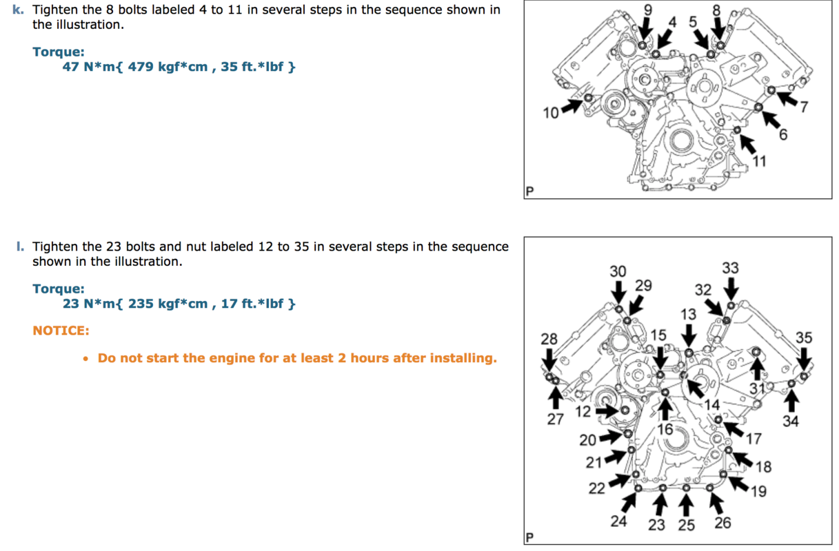

@TonyP - I checked out the FSM pages in his write-up, but didn't see the pulleys in question mentioned in the manual screenshots.
Would you happen to have those page screenshots?
When I tackle this project, I'd like to throw together a write-up for posterity.
Here you go for the torques. It's for replacing the entire front cover so disregard the sequence. Let me know if it's missing something.
