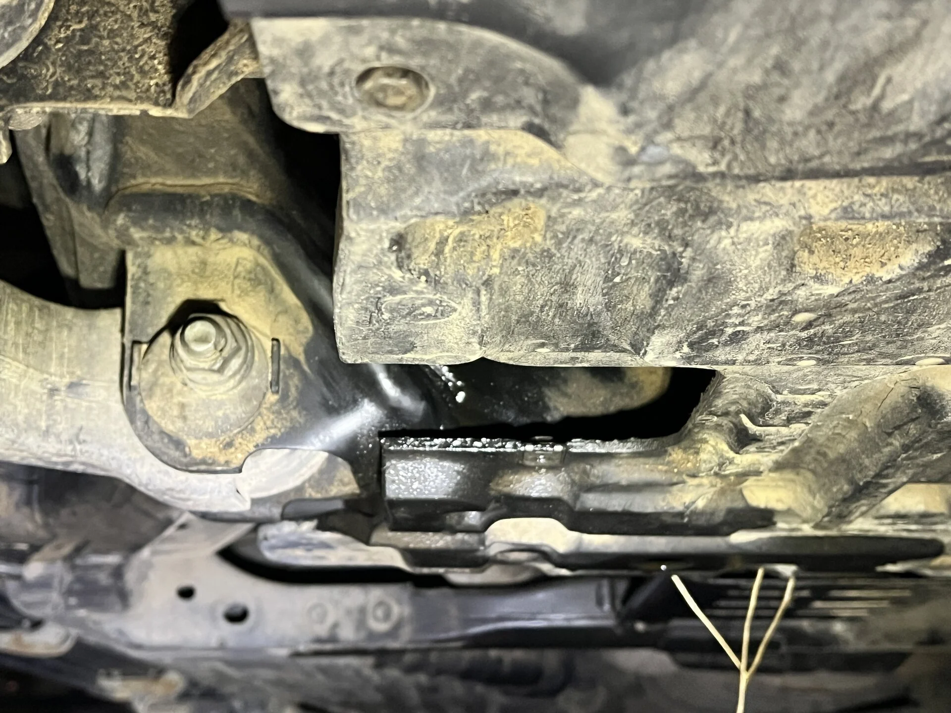

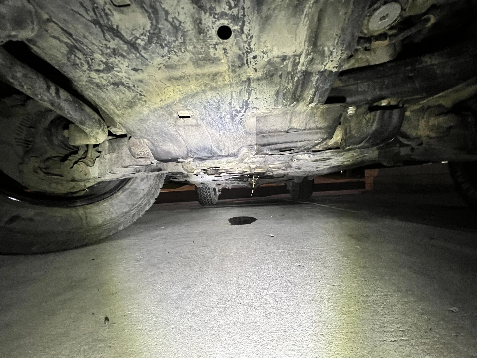

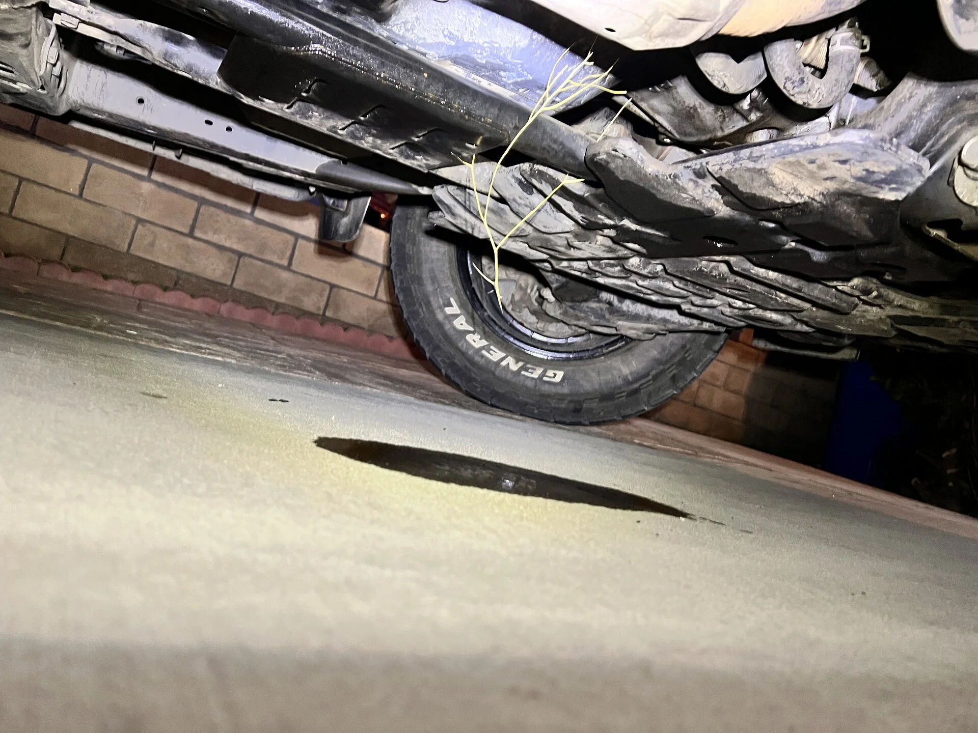

I'm going with a drain plug issue as well. From the little we can see in pics, it doesn't look to be coming from anything up high, and it looks like the color and consistency of engine oil.
Like @Sandroad posted it could be an O-ring issue too. It's common-ish for the large O-ring for the filter housing to get set in the bottom thread rather than in the proper O-ring groove.
It’s the right color and location to be a leaking engine oil drain plug or maybe a leaking filter housing. Maybe an accidentally doubled o-ring on the housing or doubled washer on the drain plug?
filter housing up front all dry.
i will get it up on a ramp and check it. It is 100% motor oil. Rate of “gush” would suggest drain plug loose
I like the idea of the double washer. Sometimes it’s hard to tell if the old washer came off or not and gets lost in the oil pan when changing the oil. (And those buggers get stuck on there)
Or we should also confirm… Did the OP use a new washer on the drain plug? That could also be the issue if one was not used.
I did not use a new washer.
That plug requires a new washer every time... or use the valve which does not.

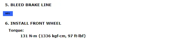

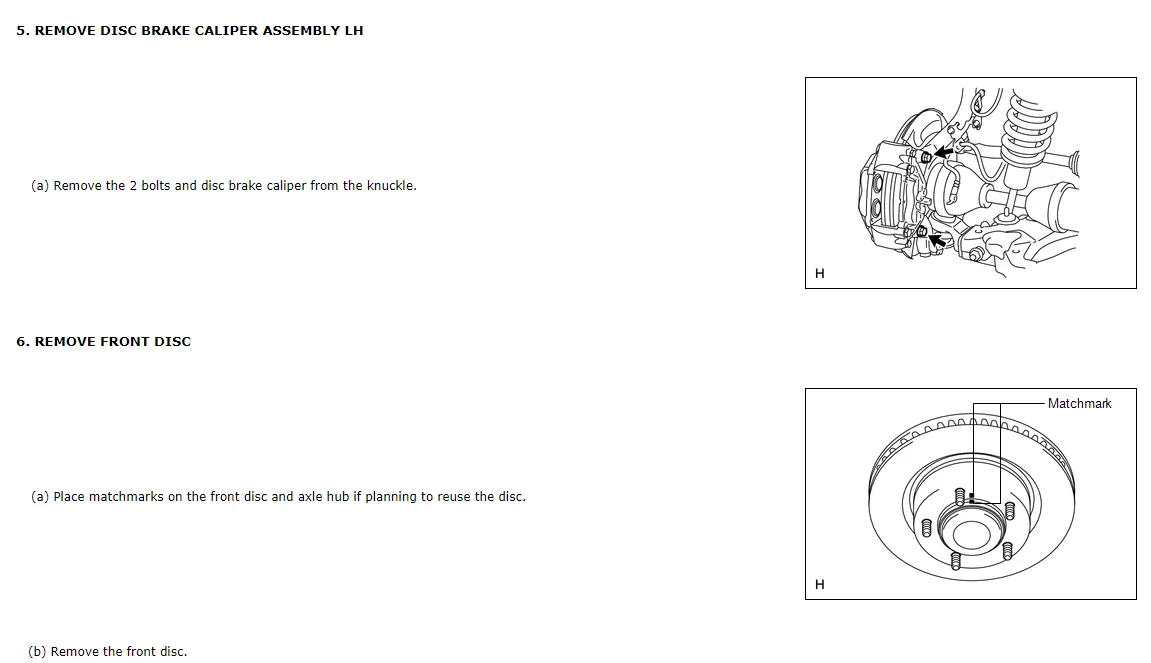

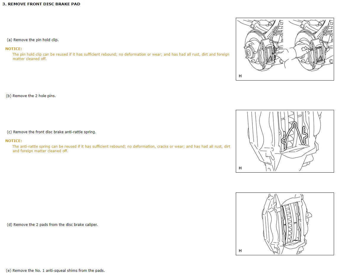

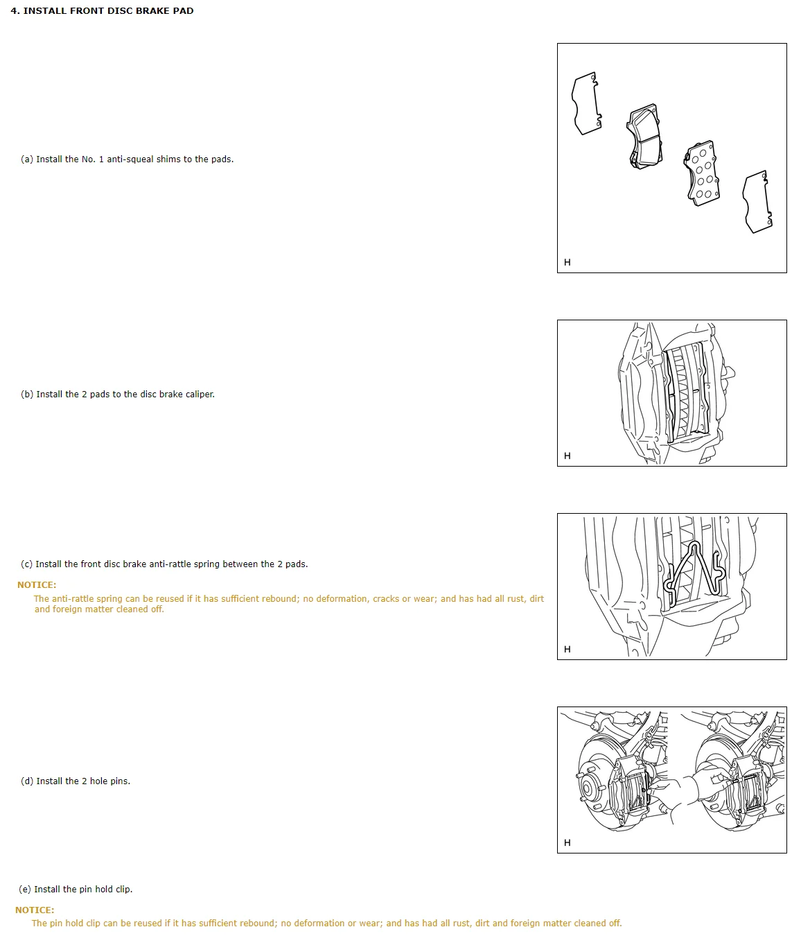

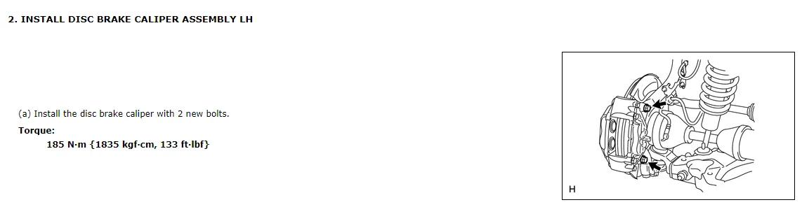

Front removal:
Front installation:

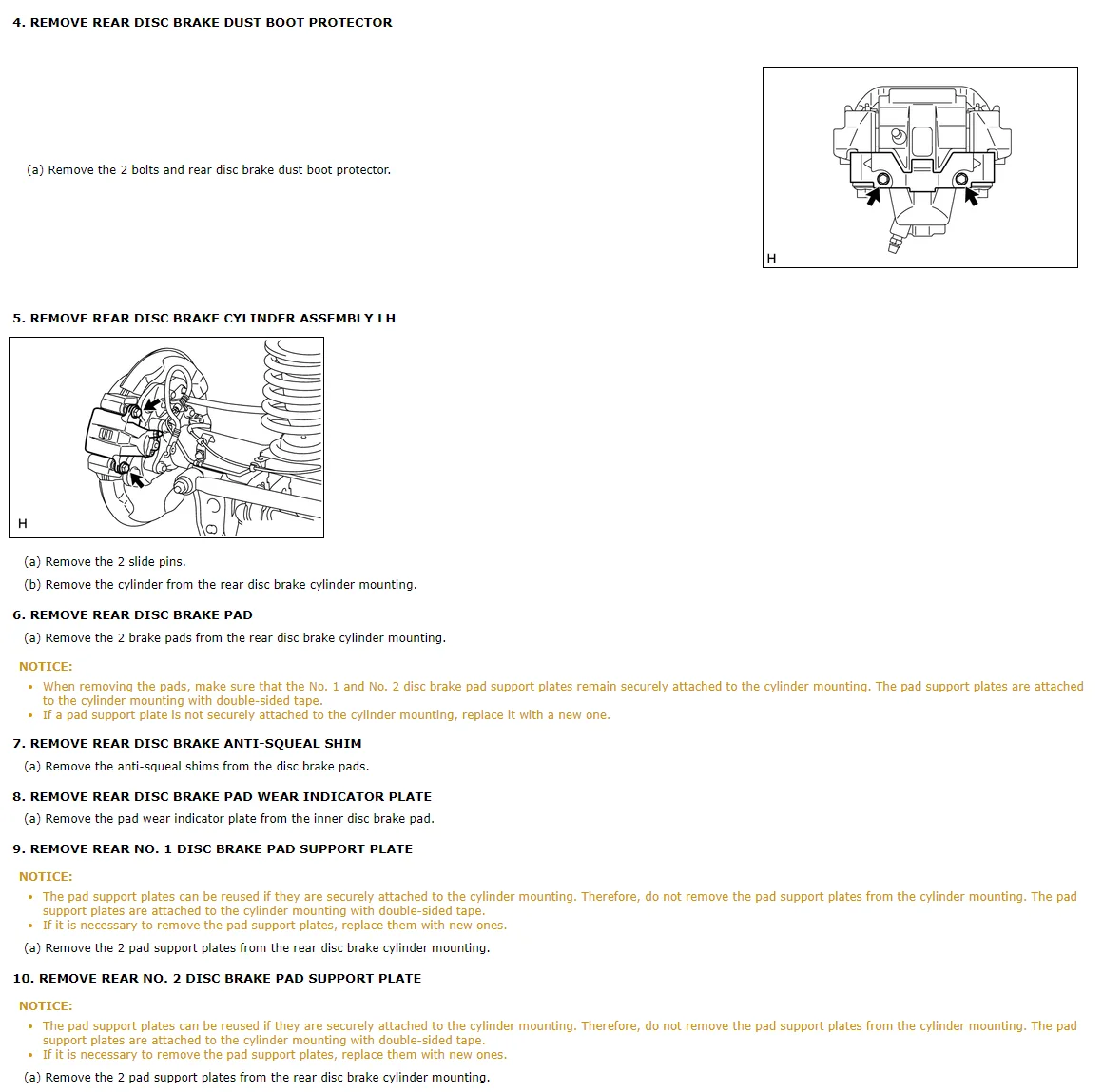

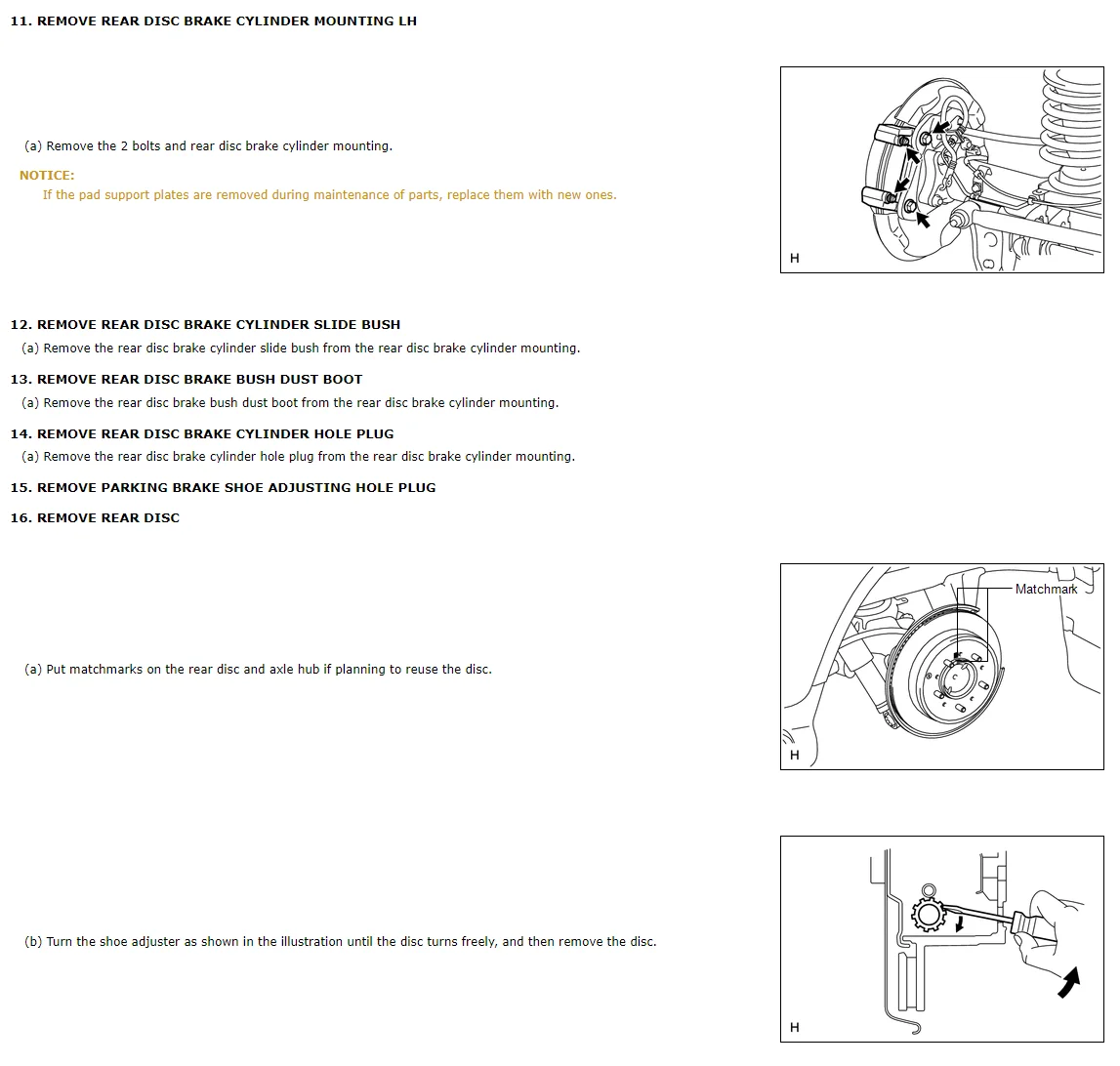

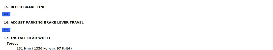

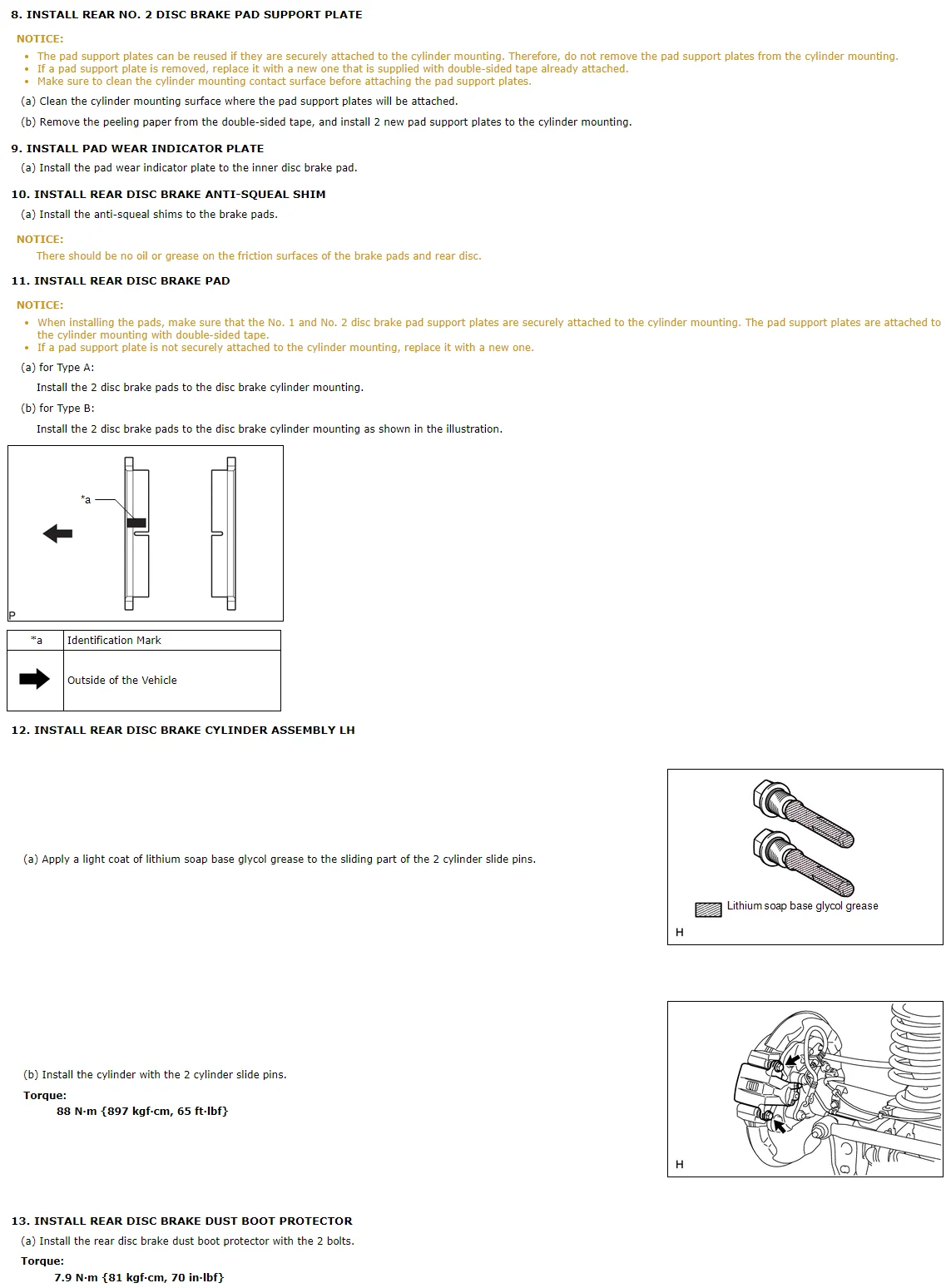

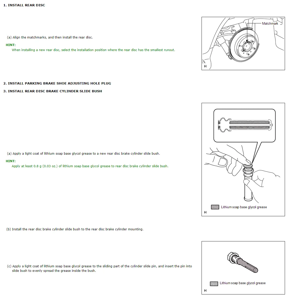

I believe this is the steps for the rear.
Removal:
Installation:
Last step...
Note that I omitted the steps involved in actually disconnecting the caliper since there's no reason to do so unless you're replacing it. If you are then I recommend using a hose clamp before disconnecting the line so you don't lose a bunch of fluid and/or end up with a ton of air in the system.
Practically speaking, if you don't remove the discs and you just do a pad swap you can leave out several steps above.
I used a one man brake bleeder and crack the bleeder screw when I push the pistons in the calipers back in. I still recommend bleeding the brakes when you're done (and really this is an opportune time to flush your brake fluid, but it's one or two pumps at that point if you just want to ensure all the air is out.
