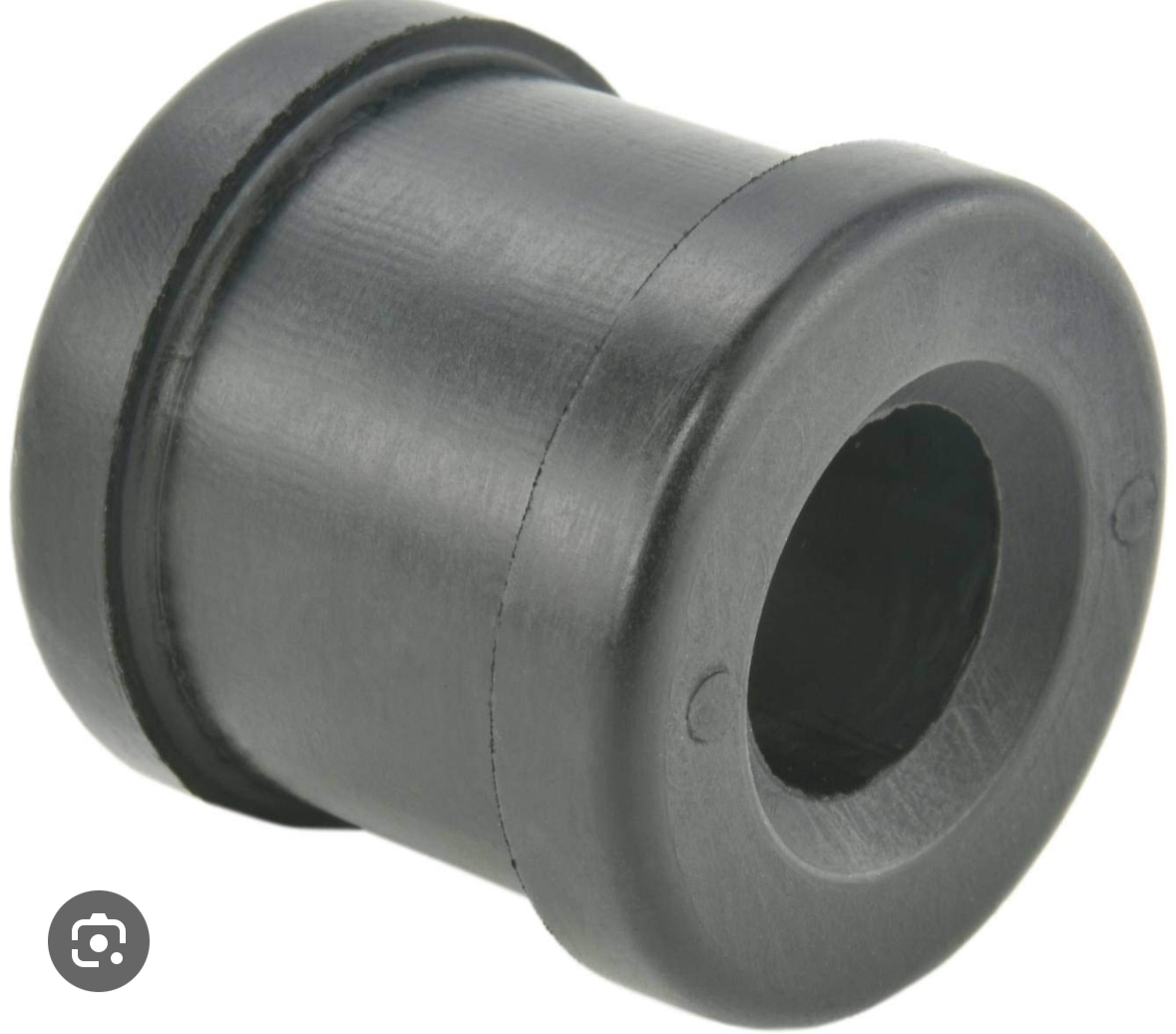

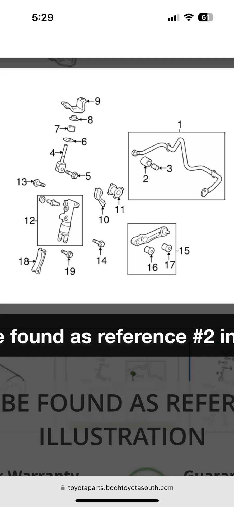

Anyone know if the bushing that goes through the rear sway bar on the passengers side is easily removed, or does it need to be pressed? The edges of mine are in bad shape and the part was $5, but I hate to get the sway bar disconnected and then find out I can’t get this out easily and a new one installed.
It’s part #2 in the diagram which fits into the bottom of part #5. The part itself looks like this:

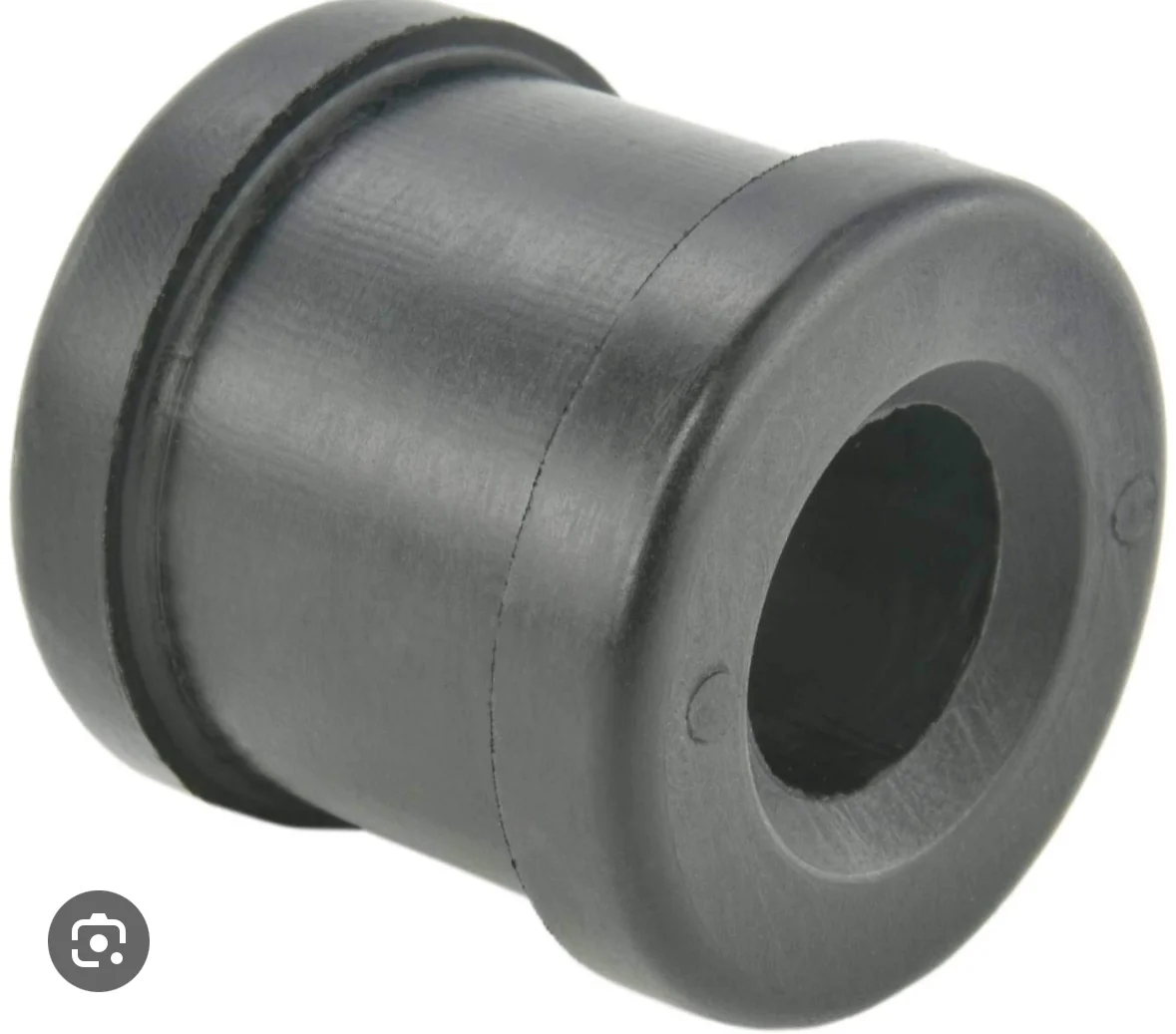

Should just pop in (and the old one out) by hand. Might require some effort, but certainly not a press.
