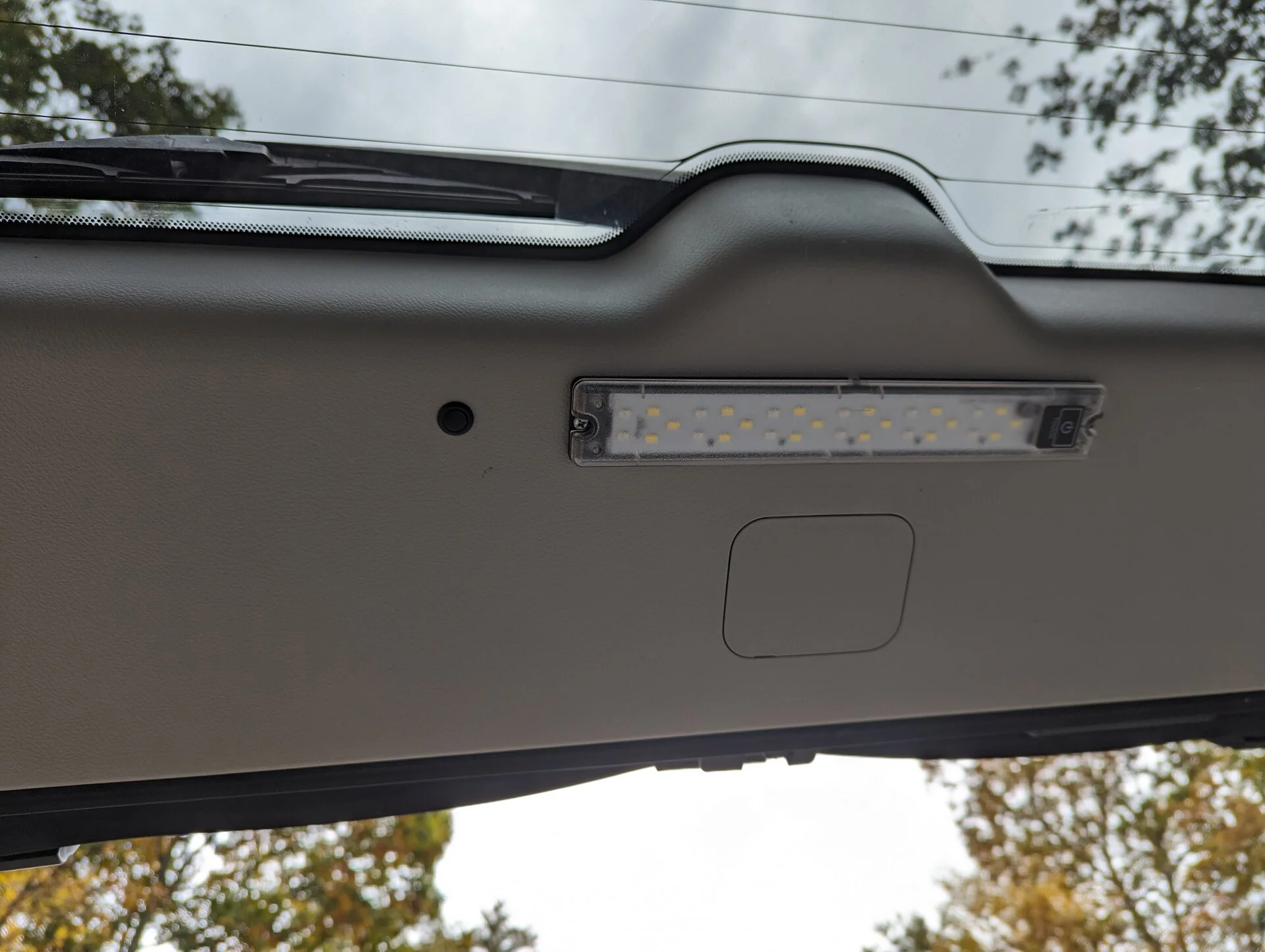

If you forget and slam the hatch, you'll drive the plastic up into the latch, then have to dig it back out. A better way is to pop off the plastic on the lift gate and hack into the wiring for the latch switch. I have a small push button on my hatch where I can bypass the switch when driving with the upper hatch open.
It's also super-handy when you're parked with the hatch open and timer shuts off the internal dome lights. Just bump the switch in and out and the lights come back on. But I also have a NL light on my hatch for long-term super bright lighting.
