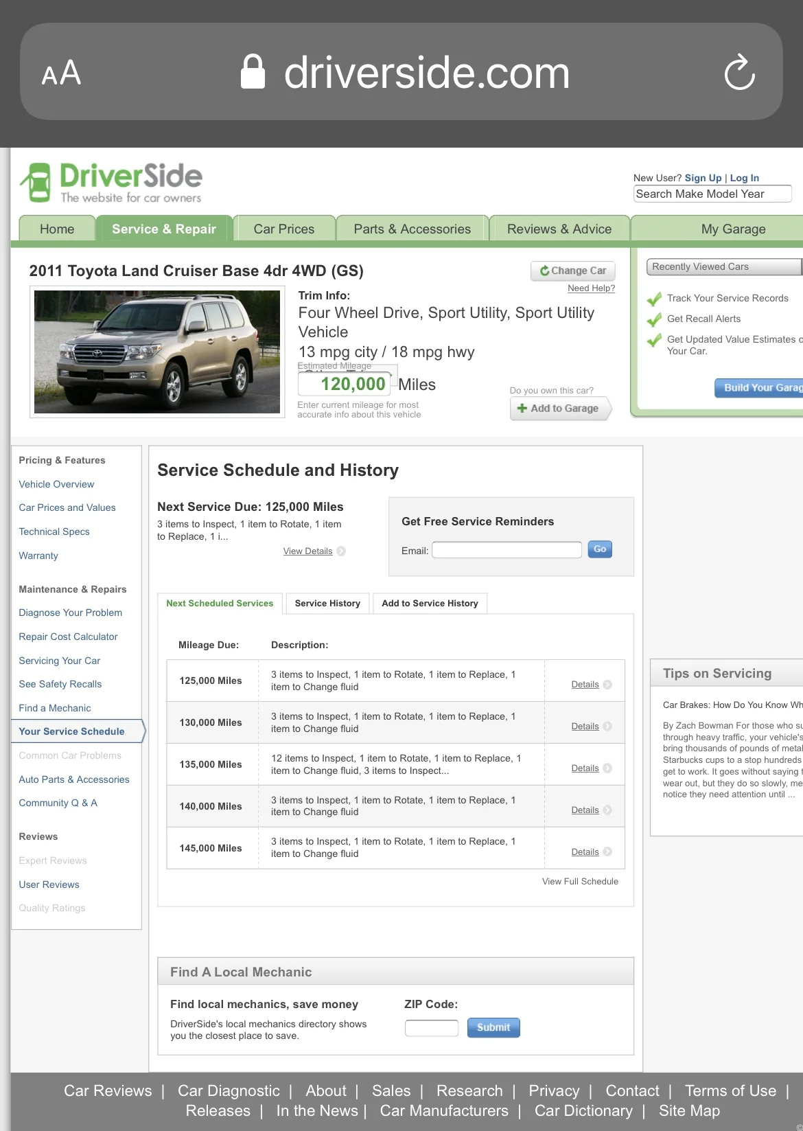

Why does the Service manual end at 120,000 mile service? I had my 125,000 yesterday and didnt know wth to ask for. Anyone have an idea where I can get some literature on 125,130,135 services ect…….?
It's really simple - just start over again at the 5,000 mile service and run through all the service intervals. 125,000 mile service is the same as the 5,000 mile service, 130,000 mile service is the same as the 10,000 mile service, and so on.
HTH
Found this too. I figure with the higher mileage other things would need attention, not something that would be at 5,10,15 and 20 though?
