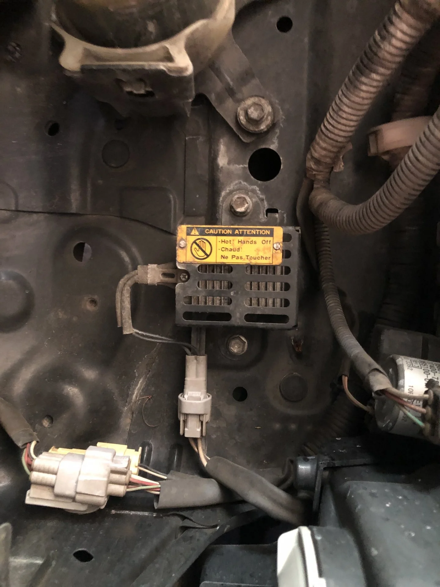

My sqod: what is this?
Looks like the ballast for your headlights.
Think it’s the DRL resistor for your high beams. The DRL circuit uses relays to put the high beams in series, instead of parallel, and I assume the resistor helps to dim them more.
Figured it was something like that’s. They really allocated a lot space for that little box
This, exactly. I think the '13+ minor update got rid of it, or it's relocated. Had one in the '11, but none in my '15.
