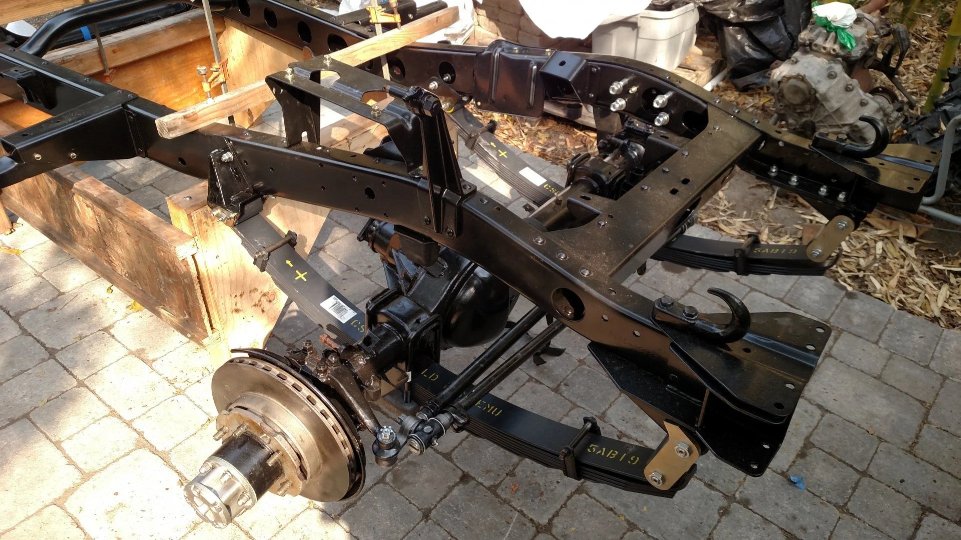

I outboarded my stock hangers to use a 60's front axel with OME 2.5" springs. Made these myself because I wanted to bolt rather than weld to the frame (was worried about weakening or tempering the frame). Rear hangers cradle the frame the fronts I cut off the stock hanger, extended the fish plates and welded them back on in the new location.
Used modified Ruff Stuff spring perches on the rear 60 axel, they make a good well priced product!
I would get new later model style front hangers that use the larger bushings If I did it again.
I used rough stuff for the perches when adding fj60 axles. I modified them and actually notched the frame to keep my spring over low as possible. I used tahoe leaf springs at all four corners and they are super comfortable and flexible.

So I can just stay with the FJ40 springs and locations I think Im going to cut 4-1/2" off the drivers side axle housing to utilize the factory spring perch cast into the diff housing on the passenger side. After I cut the 4-1/2" from the drivers I'll sleeve and truss the axle housing. This will give me a total of 64-1/2" front (69" originally) and then I'll buy the 6 lug hubs for my 14 bolt which will narrow the wheel width 2-1/4" for a total of 64-3/4" rear (67" originally). Then I'll just weld on new spring perches on the rear. I haven't actually done the measuring yet, just going of the internet. So it should work in theory. Thanks for your replies.
