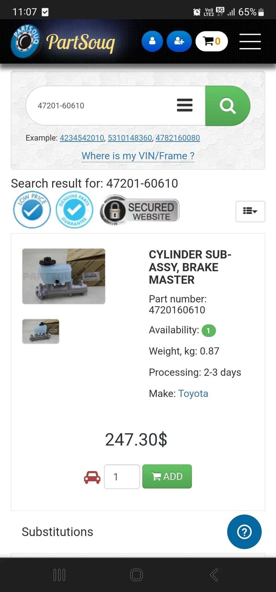

I just so happen to also be researching JDM master brake cylinders for my 80-series JDM import as well (but a HDJ81), that is a 2-bolt one. I have a 1997 with ABS - if you also have ABS I think we'd probably have the same PN needed. Looking through the online parts catalogs, it looks like my part number is 47201-60610 which also matches up with the OEM part numbers from Brake master cylinder differences - Current thread? - https://forum.ih8mud.com/threads/brake-master-cylinder-differences-current-thread.965929/.
These OEM replacements all look pretty expensive vs the 4-bolt ones that are available domestically... I think I've found the Advics/Aisin PN for 47201-60610 (BMT-235), which could cut the cost in half but still takes a while to ship. And also doesn't address the domestic parts availability issue in a pinch if that matters to you.

Partsouq are usually around 4-5 days to my door from UAE to Aus.
They also list a TRW part for $48. No idea on quality etc

Partsouq has parts diagrams, often lists alternative parts, reduced toyota tax, and ship fast.
Shipping can be a bit pricey i think, but still beats the hell out of Toyota parts departments in Australia.
I just realized I read this originally as you being after the brake booster, not the master cylinder, so ignore everything I said. I replaced my 2 bolt master cylinder with a new one myself a few months back, ordered through partsouq as @mudgudgeon recommended.
Yeah I think the recommendation from others was to replace both, or convert the international booster/master with the more common US version. I ended up buying from partsourq, it was more recommended than what seemed to be the other Chinese rebuilds.
