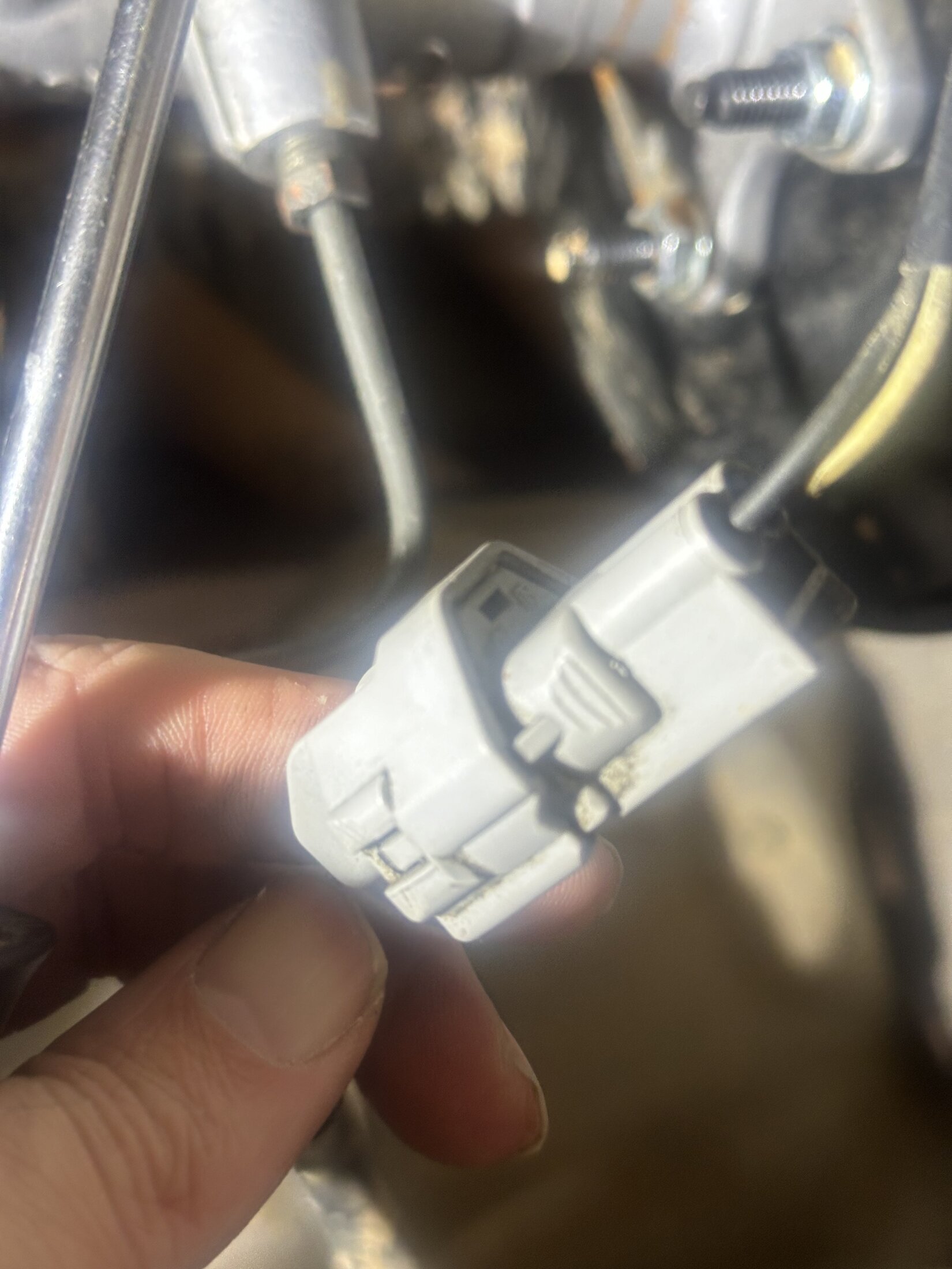

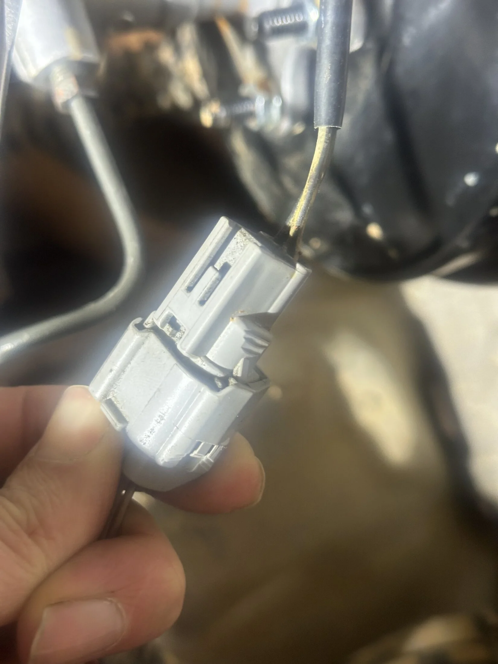

What is the process to disconnect this brake master cylinder connector ? Its being a bit stubborn and I don’t want to gouge it up hah

Those oem connectors can be really stubborn. You’ll need to find the release clip and either depress it or lift it. Then with a small flat tip screwdriver pry around the outside, loosening it up as you go. Unfortunately the plastic is old and it’s common for the clip to break. Be patient, good luck.
push the two connectors together, then press/lift the release, then pull apart.
