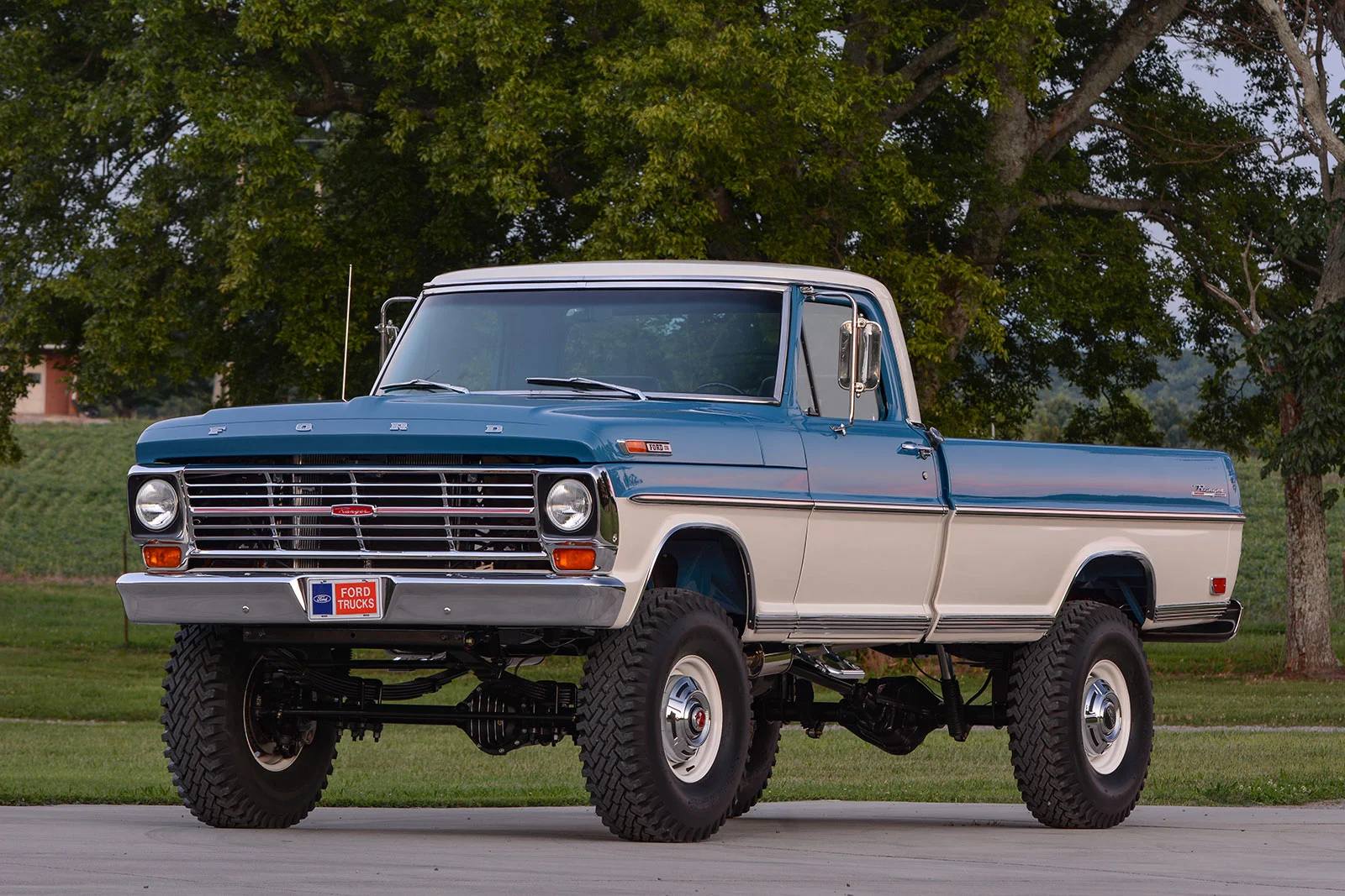

I mean, just look at this tire profile and overall vibe ... it's perfect.
