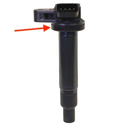

Got three off with no problem, then realized this boot went missing after I sprayed some PB blaster yesterday onto the plugs then drove to work. Is it ok to drive for a few days while I wait on a replacement to come in? And any ideas on where to source just this part, instead of having to buy the entire coil?
Denso sell a kit; boot, spring and seal. NAPA sell the seal but they want $7. Look to see if some coils are now double sealed, as you put back the coils and didn't notice. They are somewhere!
It's okay for a few days.
Ended up finding one at O’Reilly. Turns out it’s called a coil-on-plug insulator
I notice the boot is slightly brown. Likely if you pinch the end of boot, you'll see cracking. Either case indicates aged boot. The Denso boot kit is worthwhile investment.
Direct Ignition Coil Boot Kit 671-8184
