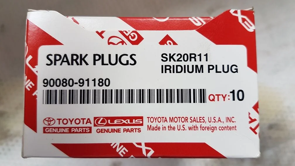

Thanks for those. How about posting your picture in this thread?

I've been getting great deals at local parts stores the Denso's USA, and have not checked to see if where the Toyota supplied are made.
Toyota ones are USA made.
