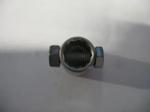

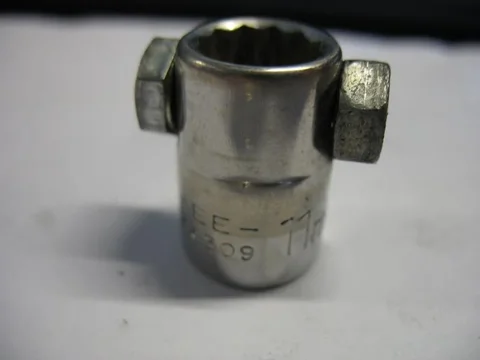

Nice job on the tool. Here's one I made awhile ago to make it quicker to lower spares around the shop.

It can be made without a welder; 11mm socket with a 6mm bolt through it. The only drawback is it falls off the extension sometimes.
