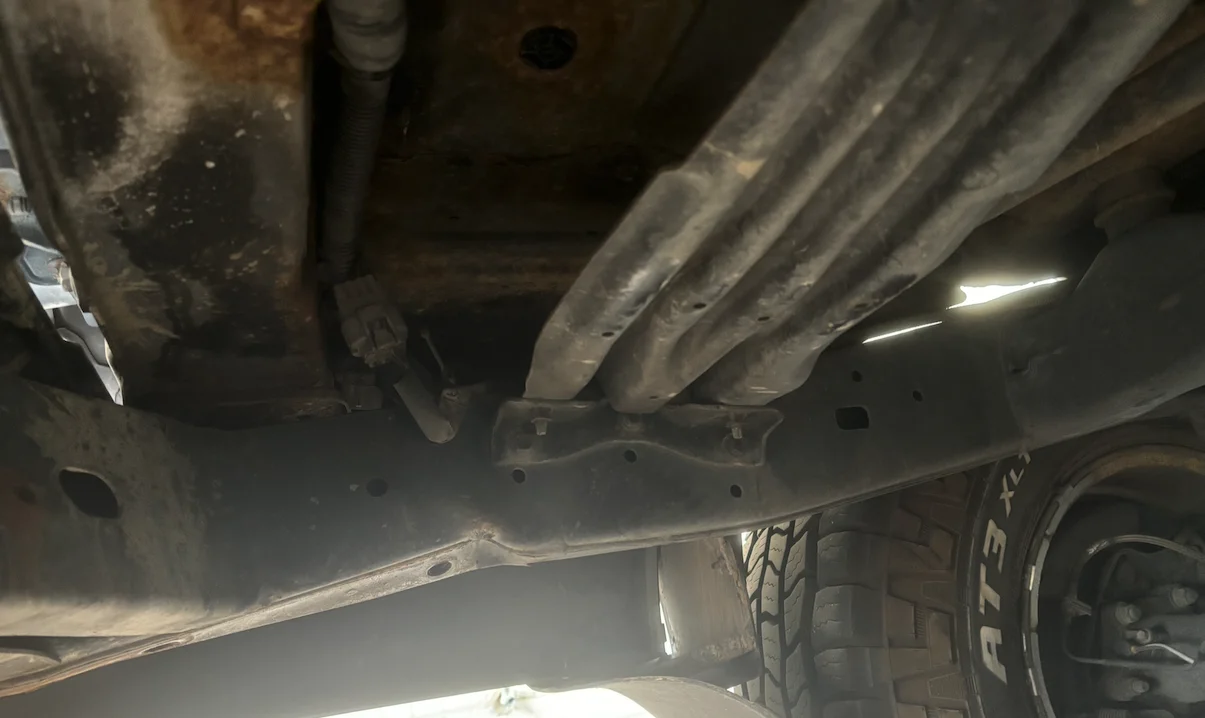

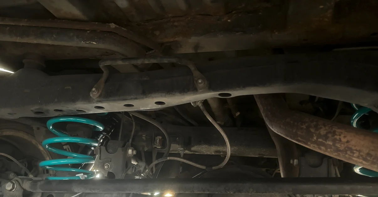

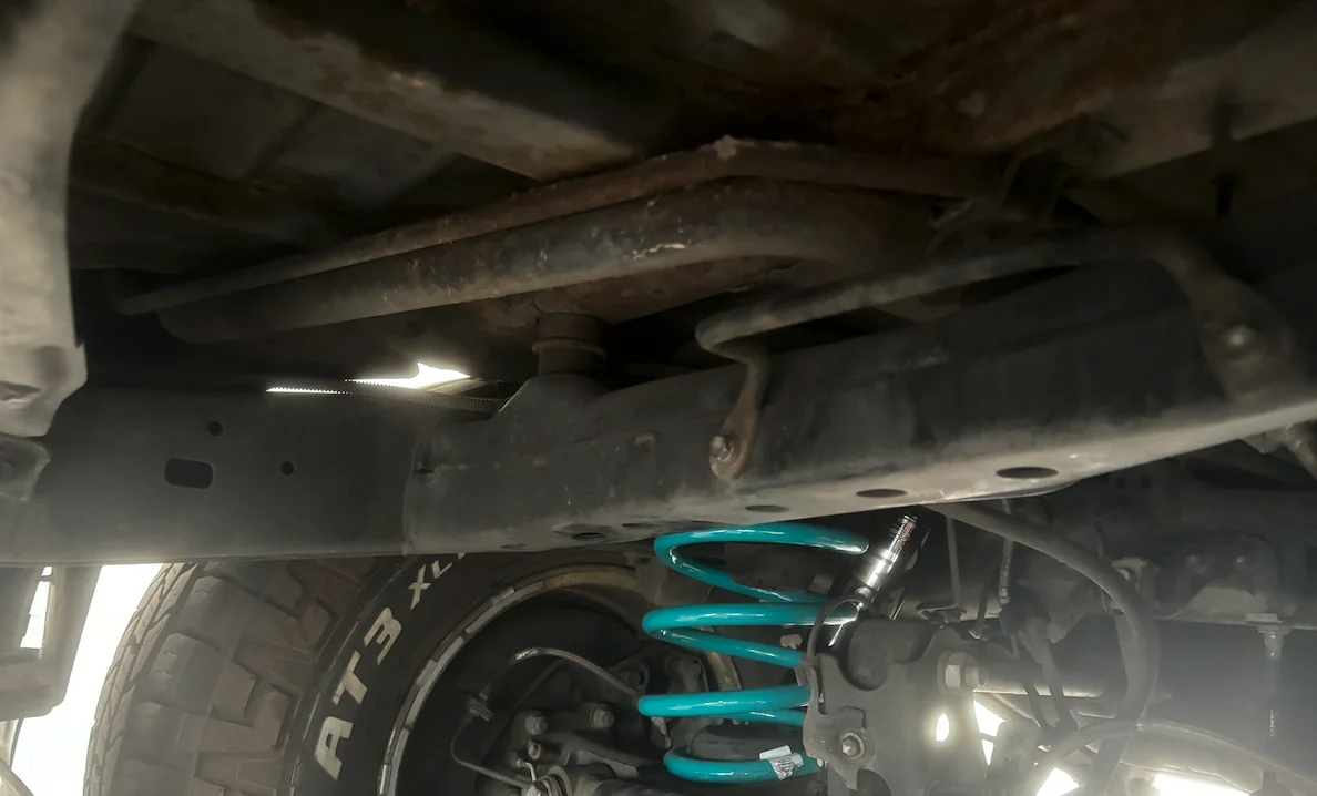

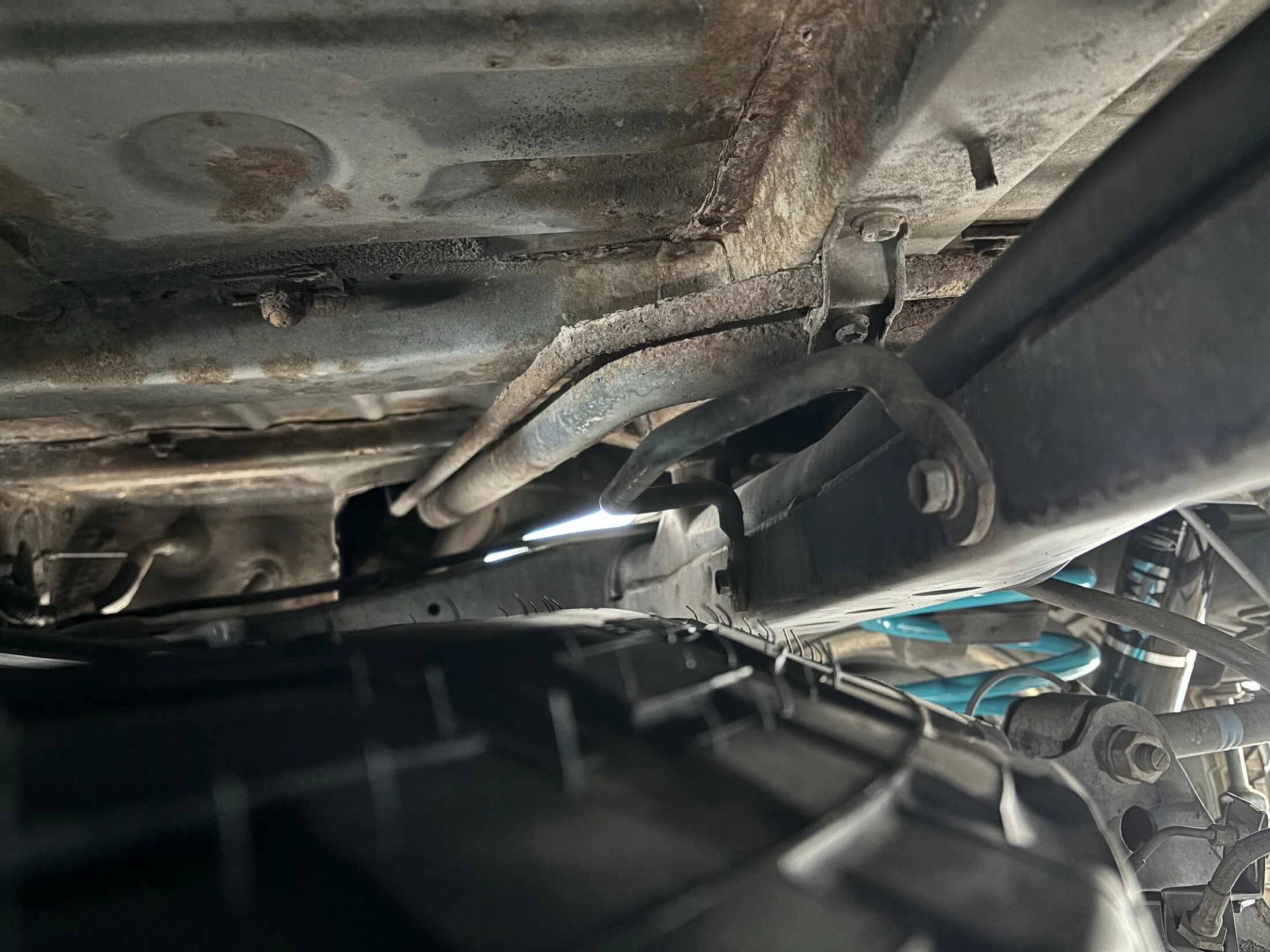

no worries. I'll try again tomorrow and I'll try to flip that bar in the picture back around. The previous owner flipped it up to fit a larger tire but never put the tire back down there.
The U shaped bar that's bolted to the crossmember in your last picture is upside down. Unbolt it and turn it around. There should also be a larger tubular bar at the back end of the tire, make sure it's there too.
Large tubular bar at the back is not there. There was a hitch there that I removed to fit the tire. So I need to go find that part somewhere is what you're saying?
