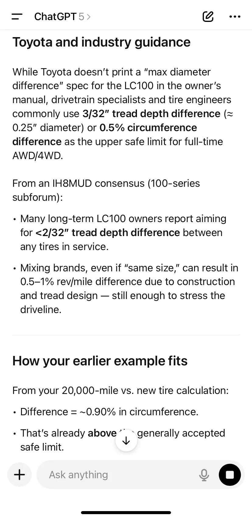

Using AI to reason over the broad scenario of a new tire vs identical one with 20k miles, plus some assumptions like no slippage, proper alignment, etc:
The worn tire will turn 5-6x more revolutions per mile.
But that’s imagining the vehicle rolling on a giant treadmill. In the real world, the difference could be twice that or zero depending on number of turns and road conditions.
I think our vehicles are pretty resilient.
It’s much more of an issue with a vehicle that has clutch based AWD or LSD in terms of driveline wear and damage.
I don’t think it’s too late to start the 5 tire rotation but now is the cutoff imho. It can impact ABS too. Unlikely but piece of mind.
Out of curiosity do you happen to have the figure on how many revolutions it will take to drive that mile? I’d like to see the percentage of difference.
These things happen in the real world all the time. All the non enthusiasts that bought these trucks I guarantee drove with a tire or two over/under inflated, something was misaligned and caused uneven wear on the tires. All things that would cause the scenario the OP is talking about. These trucks never became known for having a weak driveline / differentials which would have happen if you factor out the car nerds like ourselves. The Toyota engineers have to design these things with variances and tolerances built into them for the very reason i listed above. Let’s be honest with ourselves here. Our trucks aren’t fine precision instruments that are that sensitive to a change so minimal. It’s not like they’re F1 cars.
AI generated answer, so take it with a shaker of salt.
Personally I think 0.5% is a little obsessive, but to each their own.
The bot is just responding based on the prompts we give it. It’s based on information from this form which is all anecdotal. As you said i take it with a grain of salt.
We are talking about a spare here which is a temporary solution. When prompted this way this is what the bot says.
chatgpt with a different prompt:
is it ok to use a 285/65R18 as a spare on an lexus LX470 with 285s/70R17 tires in an emergency?
Short answer — yes, in an emergency, but there are important caveats.
1. Size Difference
Your original tire: 285/70R17
• Sidewall height = 285 × 0.70 = 199.5 mm
• Wheel diameter = 17” = 431.8 mm
• Overall diameter ≈ 431.8 + (2 × 199.5) = 830.8 mm (≈ 32.7”)
Your spare: 285/65R18
• Sidewall height = 285 × 0.65 = 185.25 mm
• Wheel diameter = 18” = 457.2 mm
• Overall diameter ≈ 457.2 + (2 × 185.25) = 827.7 mm (≈ 32.6”)
Difference = ~3.1 mm (0.1”), which is well under 1% — so rolling diameter is nearly identical.
2. Fitment Concerns
• Bolt pattern: Must match your LX470’s hubs (same as Toyota Land Cruiser 100 series).
• Brake clearance: 18” wheel will have more brake clearance than 17”, so no issue there.
• Offset/backspacing: If the spare’s wheel offset is significantly different, it could rub suspension or fenders — especially on the front.
3. AWD/4WD Caution
Your LX470 has full-time 4WD.
• For long-term driving, all four tires must be closely matched in diameter to prevent drivetrain stress.
• In an emergency, you can run a single slightly different tire to get to a repair shop, but avoid high speeds, long distances, or engaging the center diff lock on dry pavement.
✅ Verdict:
• Safe for short-term emergency use — the size difference is negligible.
• Drive moderately, avoid aggressive cornering or high speeds, and replace/repair the damaged tire as soon as possible.
Here, use this and check the data it spits out. Of course it doesn’t factor in used vs new. You can make measurements of your tread depth and go from there though with an overall circumference measurement.
