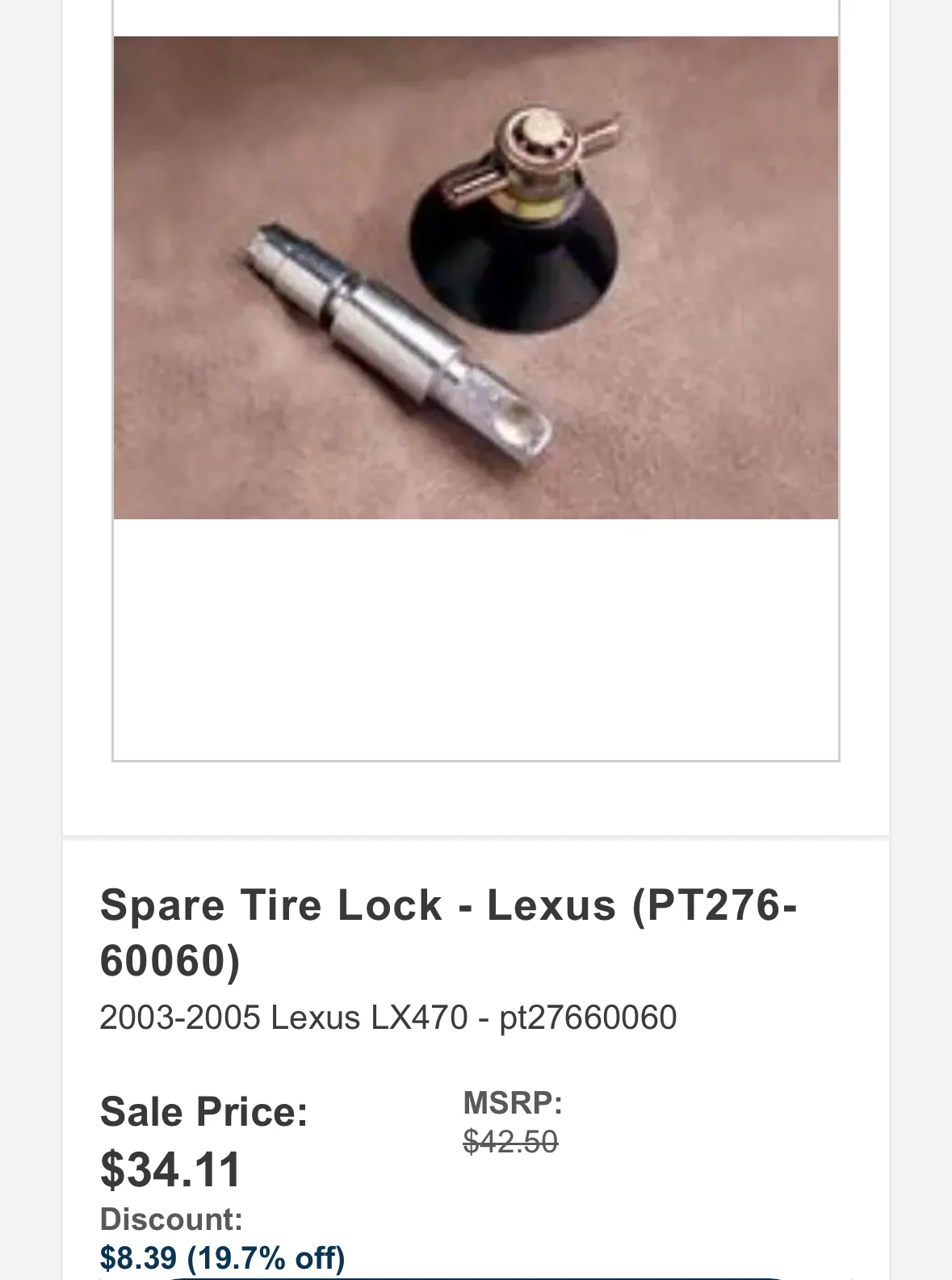

When storing the spare, make sure the face of the wheel is facing upwards. If facing down, it’ll still fasten but the cable is not retracted as much and more likely to come off. Plus the face of the wheel can get scratched.
Otherwise, the standard spare lock is enough for most people. It’s a keyed lock for the cable lowering mechanism.
Thanks Hoser - I have the lock there and they still were able to lower it. and they did not damage it at all. Odd.

IIRC the LX uses a special adaptor/key to lower the spare, similar to a key for a lugnut.
it's more of someone who knew what they were after, not a random thing
I had an LX years ago and didn't have the key/adaptor, ended up using a Landcruiser spare hoist that didn't require an adaptor to lower or raise it.
