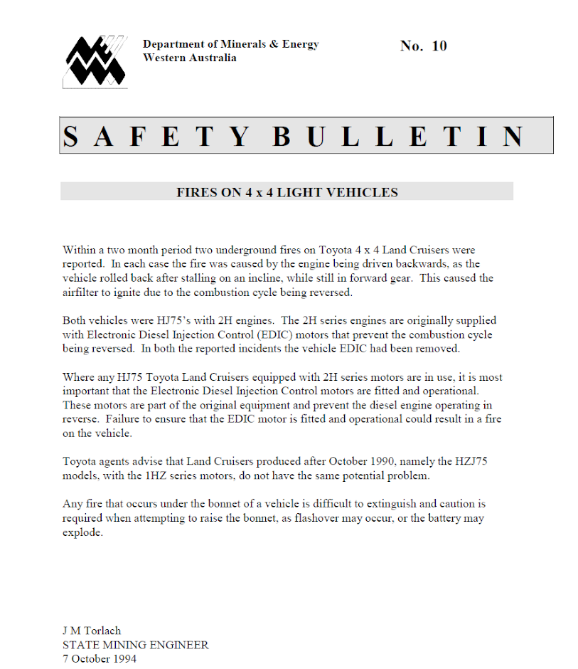

God, just a place you would never want to go or witness, running backwards.
I remember Duncan recommending a locking knob, so the cable ensured that the pump remained in the off position. The video of his 2h starting on it's own accord is unnerving. It's ALIVE.!

Wow! Had no idea that the motor could actually run backwards. Am I to understand that the exhaust goes through the intake and the fresh air comes in through the tail pipe? I have to try to visualize and wrapp my head around this.
