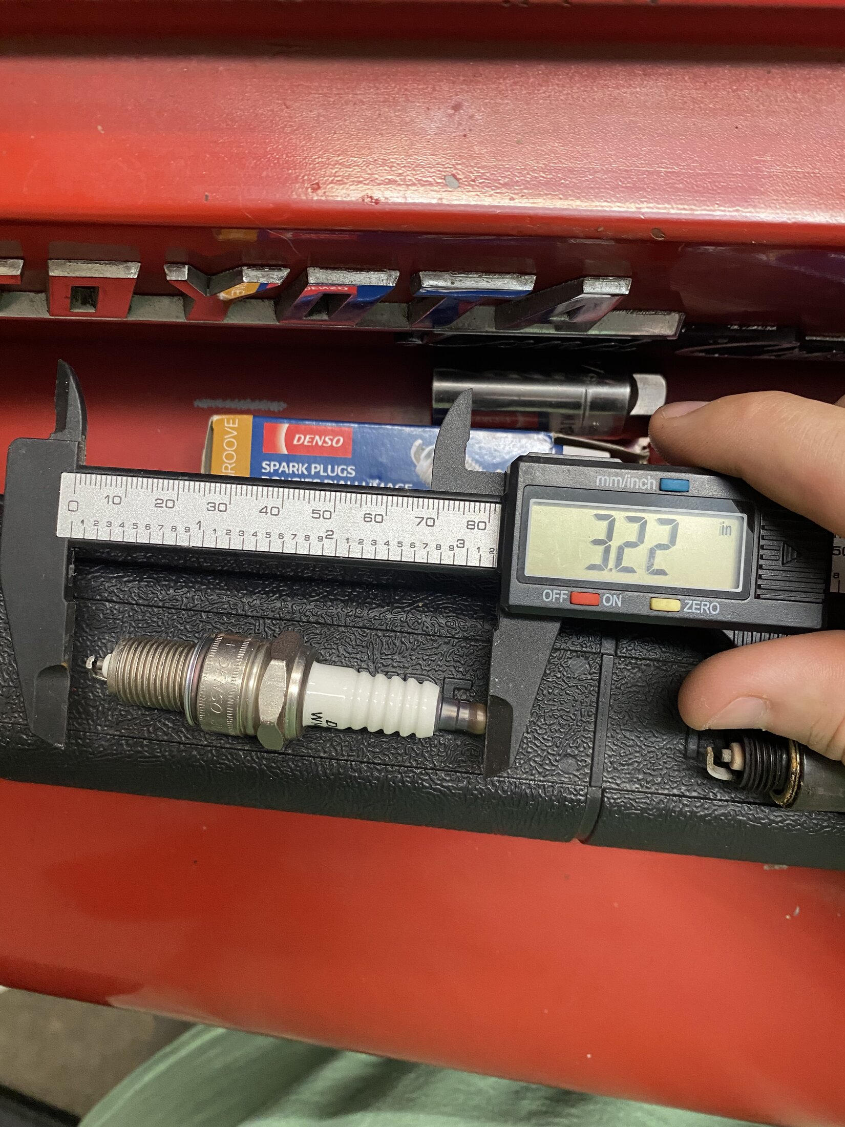

The plug on the right is the one I took out. Obviously these are different sizes….will that matter? I don’t want the piston to smack the new plugs. If so, which spark plugs would match what I took out??

Yeah, I thought these were based on what others said. But these are a different internal length. The lengths of the part where the plug wires go are the same length….the threaded part with the spark end is longer.
Any ideas what would fit?
Based on the pics here the threaded part is the same length.

The overall length of the plug is not as important as the "reach". The reach is the length of the threaded part.
According to Rockauto.com, the reach of the Autolite 85 plug is 3/8". The reach of the Denso is 3/4".

Correct. The reach on the Denso I got is longer…the pics on all the major vendors show the 3/4” reach, even for 1964…I just don’t want to take a chance.
