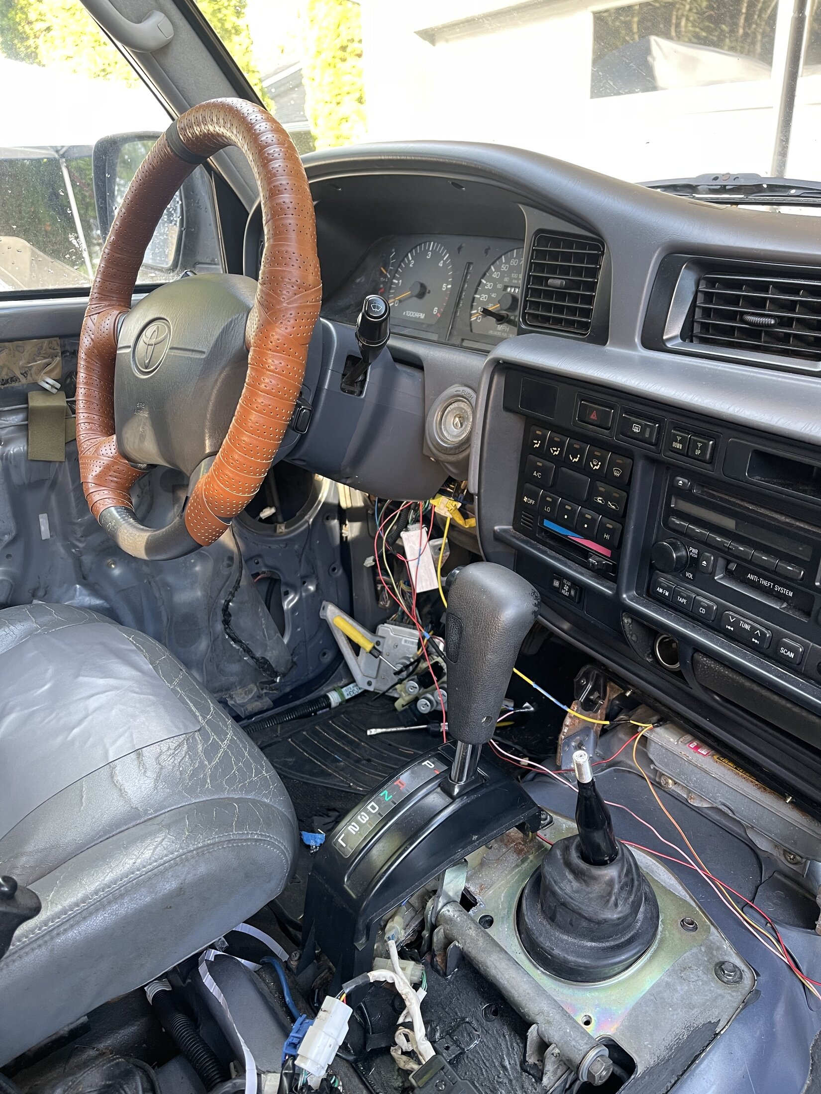

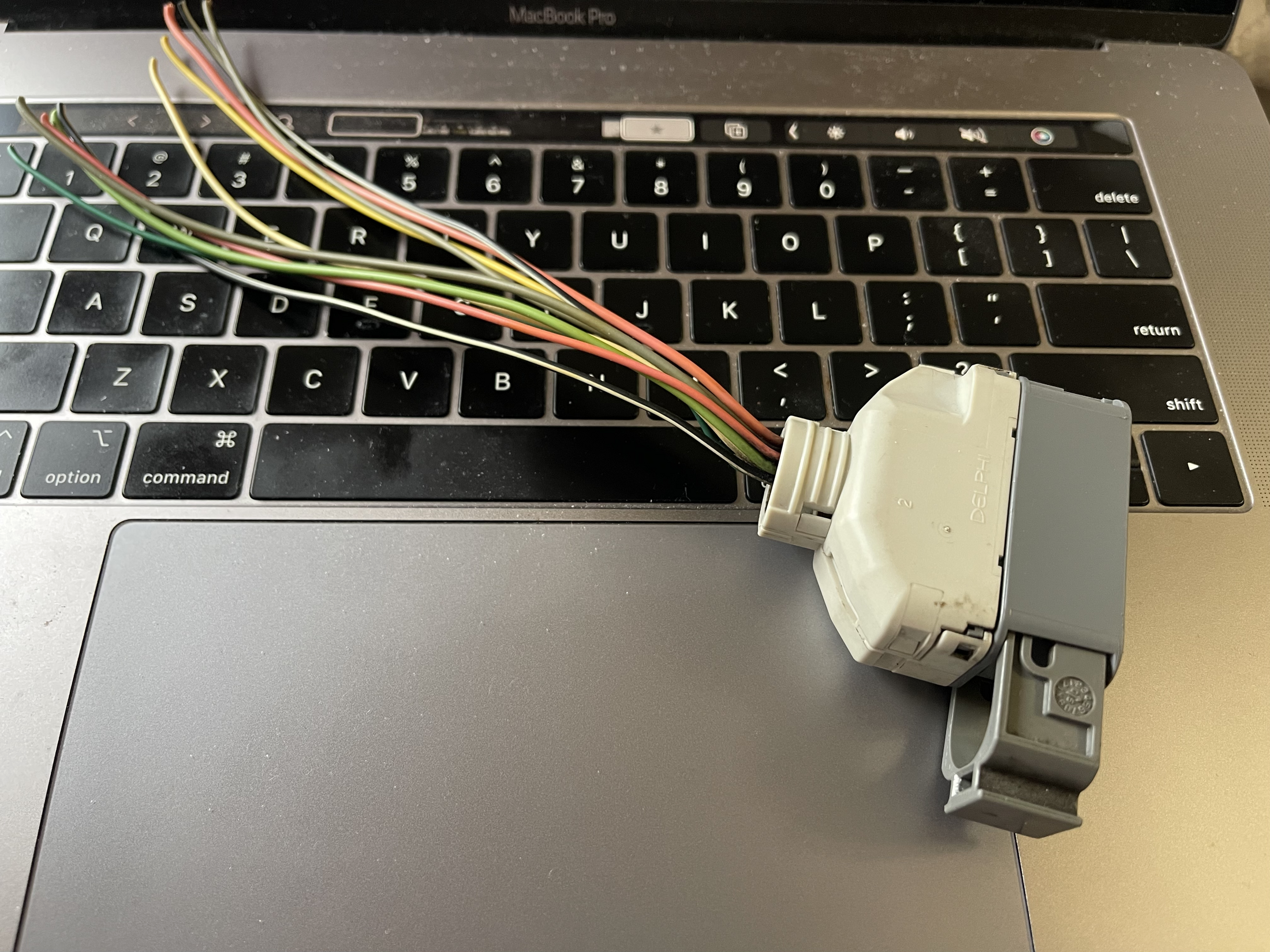

Hi guys. I ran into a problem with my swap. Engine starts every time but the transmission won't go into any gear, car won't move. ATF is properly filled. Transmission works before I installed it. Wonder what the cause of the issue is. Nothing is plugged into the park/neutral switch. Could it be that no wires are connected into the park/neutral switch? Thanks.

What flash does the ecu have? Do you have fluid in the trans?
Yes I have fluid. Filled it when transmission fluid is hot. I’m using psi provided ecu and wiring harness. Do you need to hook up wires to the park, neutral switch for it to go into gear?
No. But you should hook up a ground for the switch pin that goes to ground at minimum. Even still without that it should shift.

I don't think the Park/Neutral Position switch stops the transmission from going into gear. What it should be doing is stopping the engine from starting if the transmission is any other position than Park or Neutral.

The position switch has nothing to do with the mechanical operation of the transmission on a 4l60 or 4l80. It’s just for lighting up lights on your dashboard and making sure you don’t start the vehicle in gear.
Make sure the transfer case is in gear.
As @fireflyr mentioned, the T-Case can be an issue. Make sure it is in High or Low, and not Neutral.
I had to lengthen the high/low shift rod to accommodate the longer transmission and AA adapter and didn’t have it adjusted correctly so it was in neutral as @cruisermatt and @NeverFinis said. Rookie mistake that cost me some time and effort.
I’m grateful for you guys. I’m such a dumbass. My build I made an intensive quality assurance checklist. But made this idiotic mistake. Guess what? I had to shift to neutral for the transfercase rod to pass and fit through the hole on the chassis. Forgot to shift back to low. Now it shifts!! Thanks all.
