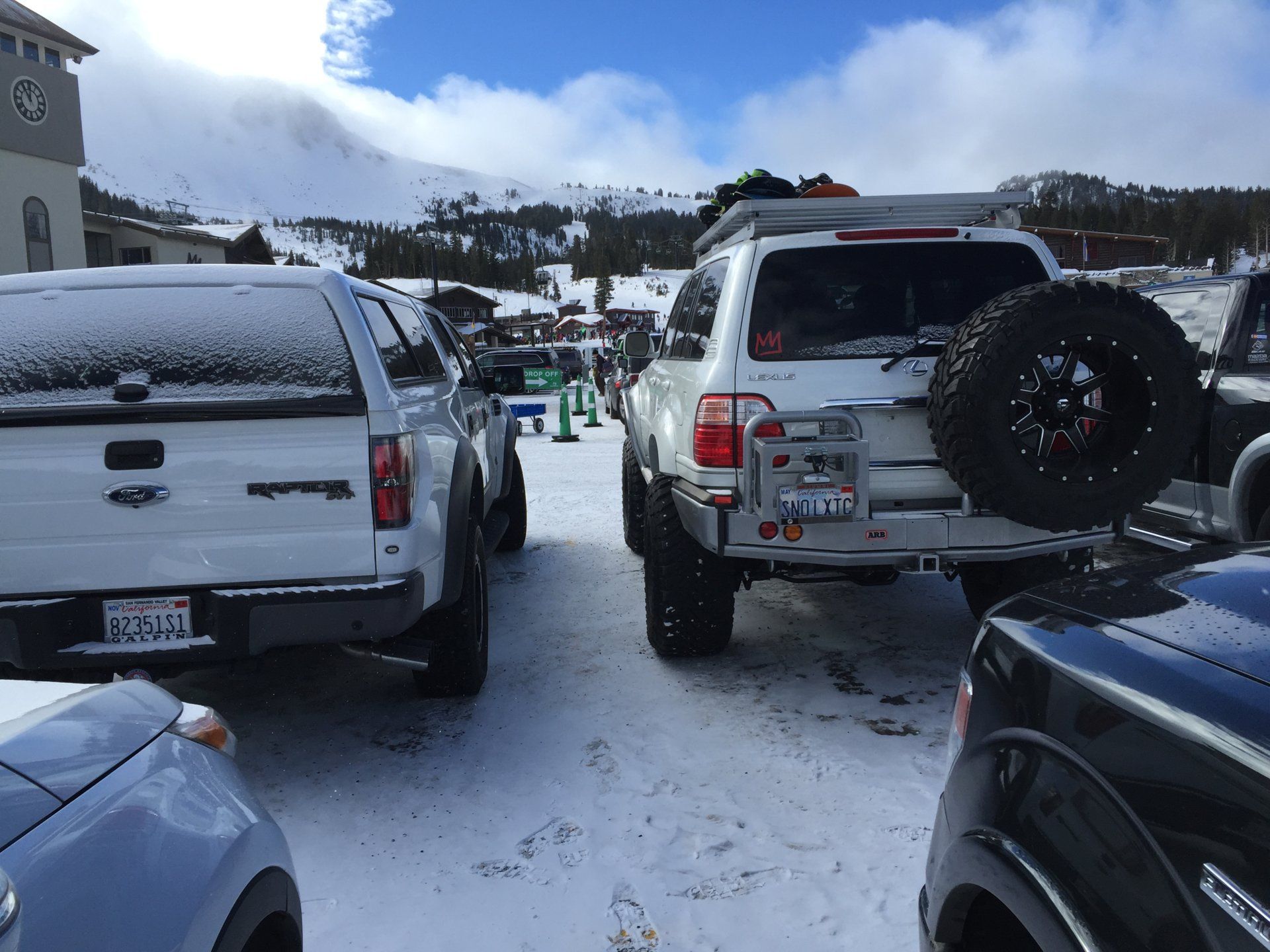

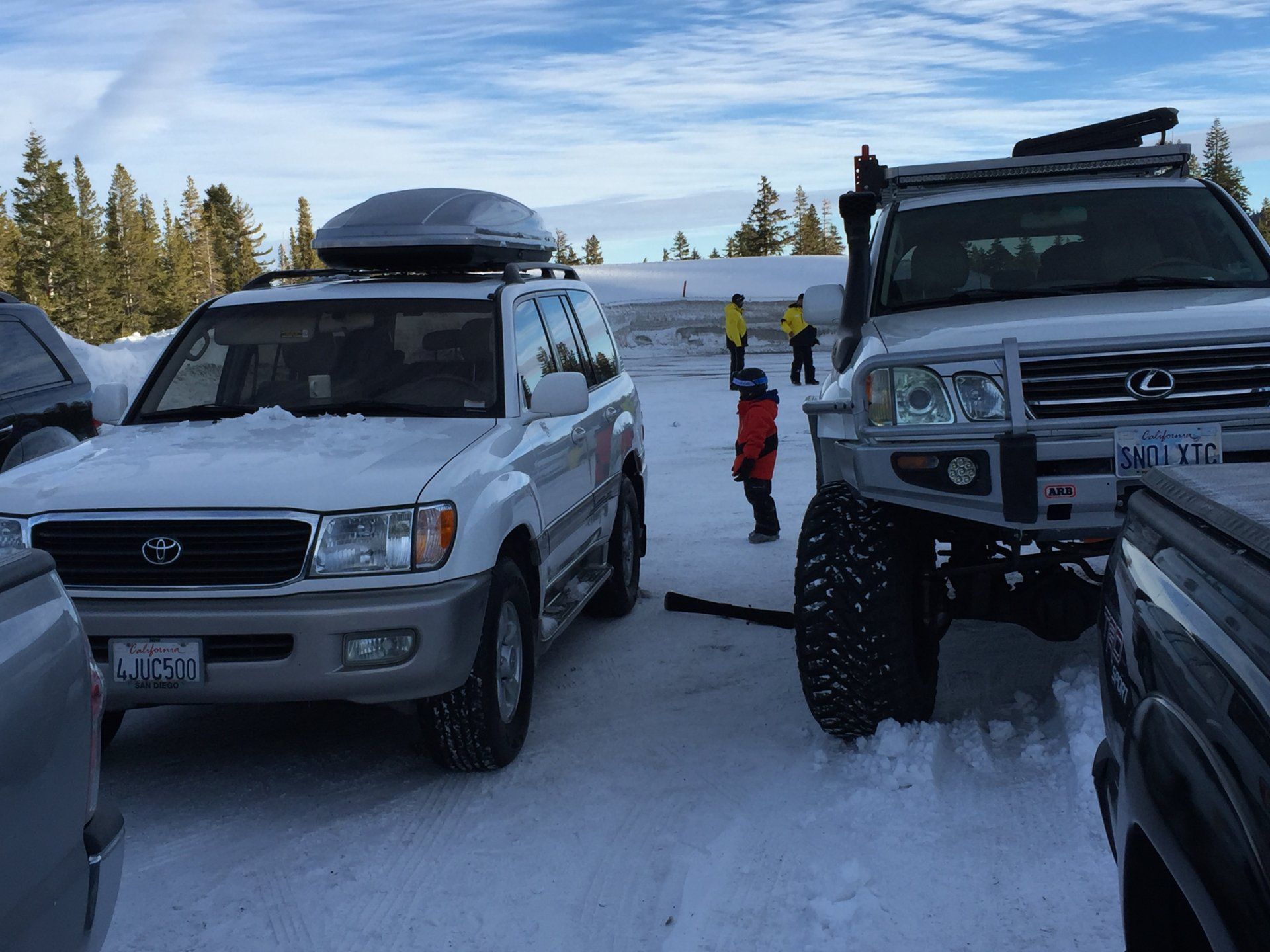

I would get an 80 or repair the 100. SAS your car will Be down for at least a month I'd guess. I loosely estimated it would cost me $10k+ to SAS and get all the upgrades i want. For that I'd sell my 100 and start working on a LS 80 series. Go for it if thats what you like though! They are rad
X2
Haha Haha. Love those pics. It’s what I say when I pass another truck in my 88 SASd 4runner. “Hey little buddy!”
My son calls them “shorty” and he is 11.

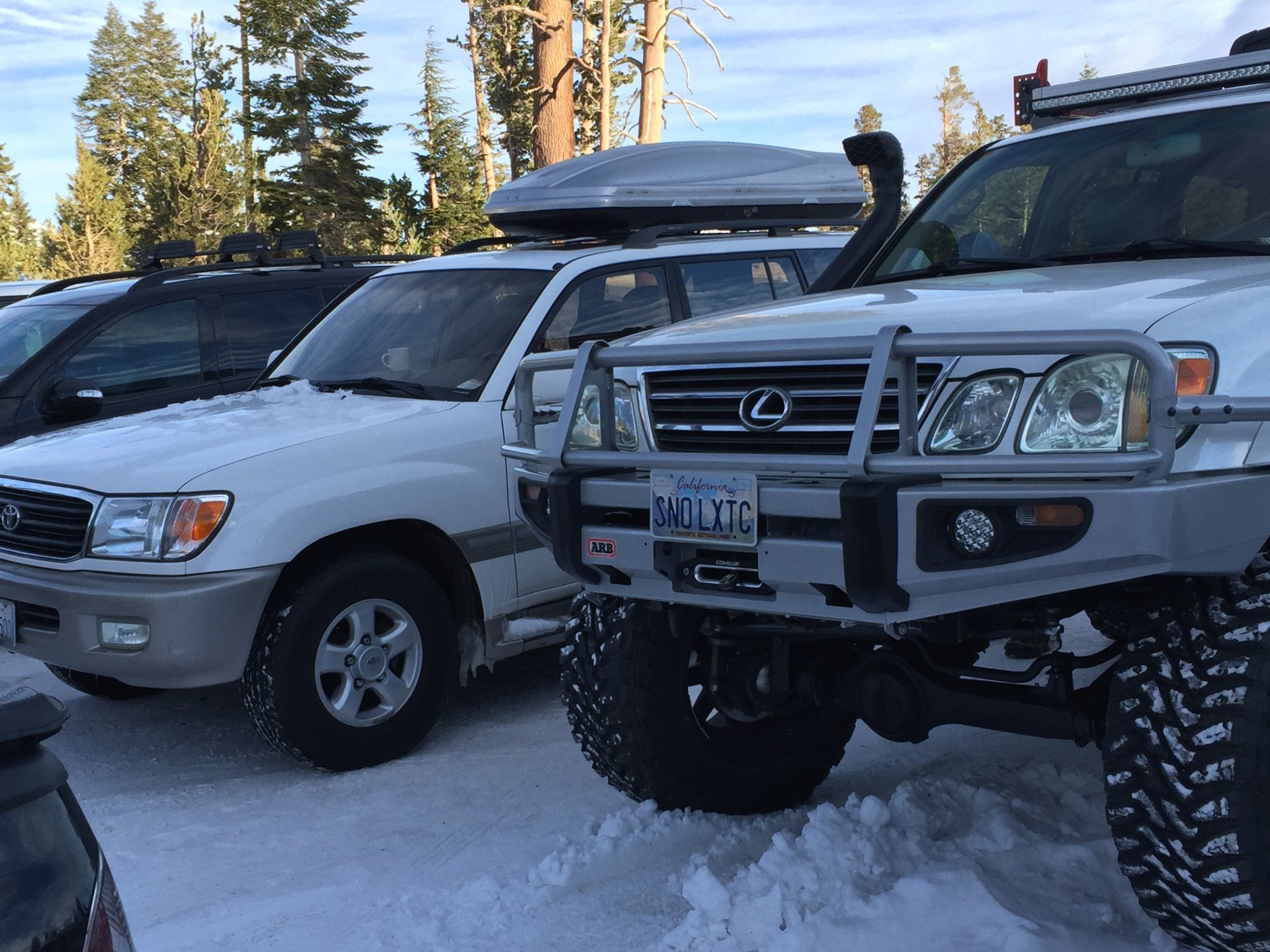

- Where should I start?
Start by identifying your end goals/desires. What do you want to end up with? How high/low do you want to end up? What size tire? Building low is much harder than tall, and will potentially require some different choices in parts.
- What are my options for matching lug patterns while keeping the rear axle? How can I convert the 5 lug to match the front or vice versa?
There is no readily available axle that will match your rear lug pattern. You can probably do spacer/adapters at one end or the other, but that messes with other things. (like scrub radius if you put them on the front...) If you choose an 80 front axle, it's probably best to swap the rear 80 axle in as well--that way your axle widths match as well as lug pattern.
- Why did you choose your set up?
Fitment in the chassis, matching lug patterns, matching axle widths, retaining ABS/ATRAC, low ride height, added strength and bigger brakes compared to original 100 parts or an 80 axle, ease of maintenance.
- Calculating link geometry? What bracketry did you use? Did you fab them, buy them? Pro's and con's to 4 link vs 3 link?
I built radius arms. As such, there isn't much link geometry to calculate. Fabbed all brackets. It fit easier under the truck than a 3 or 4 link would have. 3 link will offer less restriction to articulation, which also translates to more body roll on road. I don't intend on doing anything with this vehicle that the radius arms will hinder its performance. (again, the "right" choice depends on your end goals)
- What kind gauge did you use for frames/spring buckets/ etc?
I plate the frame with 1/8", coil and shock mounts are 3/16", suspension brackets 1/4".
- Suspension set up? Why coils vs coil overs vs leafs?
I chose coil and shock for zero maintenance and zero noise compared to coilovers. Same reason I'm using rubber bushings at all points in the suspension rather than any type of spherical joint. Leaf spring were never an option for me. :) Coilovers would have fit much more easily, the width of the frame is a hindrance.
- What did you use to weld all the stuff up? MIG vs TIG?
MIG.
- custom drive shafts?
No, the factory shafts ended up fitting well enough, surprisingly.
- Am I crazy for trying to get this done?
Not in my mind. It's your money and your decision in the end.
Since it's been mentioned a few times already, I'll just answer these questions the best I can, and ignore the economics of doing a swap like this. :) If you want a SAS 100, then build a 100 the way you want it! Mine makes me happy every time I drive it, and my wife drives it every day as her primary vehicle. (therefore road manners were a priority)
I will say though, I really hope this is not your primary vehicle while the work is being done.
My responses are in red above.

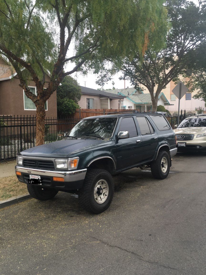

I do have a 2nd gen 4runner that I bought for 700 bucks that had a blown head gasket. Fixed that up and it runs ok. I may practice doing a SAS on that and see how it turns out. If I can figure that out, I will for sure do it to the LX. I just couldn't justify paying all that money for new parts to fix the LX.

I do have a project 4runner that I will SAS just for practice. It's a much easier swap than the 100.
