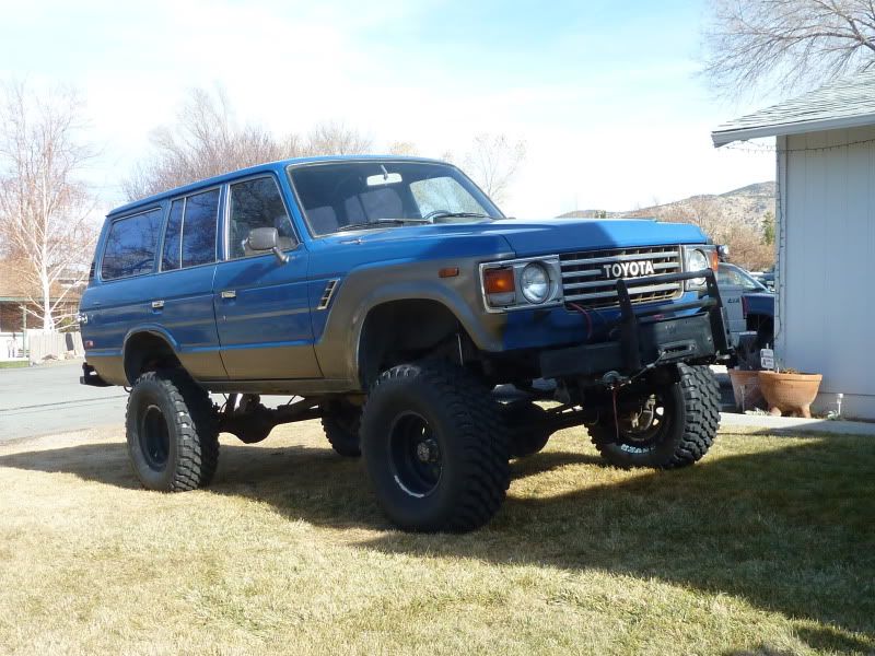

from man-it-ant- free it cost me $800+ for aal, body lift, and greasable lift shackles, to wind up with a ****py ride and little articulation,
http://i119.photobucket.com/albums/o143/dnthall/P1000961.jpg
How did you spend 800$ on that stuff? Before I did my spring over I spent 100$ on the AAL from Man-A-Fre 160$ on all 4 extedned shackles from SOR and $120 to build an Alluminum Bl kit. I was in a hurry and it was quicker to make it than order it. You are right though the ride is not impressive.

longer shocks and 16 new shackle bushings, greasable anti inversion shackles i think it actually was closer to $900
