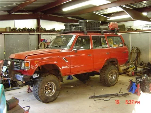

I think both look great! I prefer the 15x8 look as well. You think if I get 15x8 with 2.5 inch reverse backspace and a 1/2 inch spacer I will be good? I'll see if I can find any 15x8's with 2 inch backspace.
Chicago, what is your backspace on your wheels that you had to use a 1/4 inch spacer? Thanks guys. Great info and help! Many thanks. I'm ready to move up to the big boy club and believe it or not, your rigs are what inspired me to go SOA I remember seeing them when I was a land cruiser cherry. haha Thanks Looking good

Rub? Yes and no. I can drive it on the street and prerun, but if I stuff the front and turn it definitely rubs. I could lift the front more to avoid contact, but I will be doing some fender massaging instead.
Add-a-leaf? I am using one in front (minus 2 factory leaves). I originally installed them in the rear, but the truck was too tall. So, I started pulling out rear factory leaves to settle it down. The ass end was just too heavy and it bottomed out bad. So, right now, the rear is all OEM, plus 2 short OEM on the drivers side to correct my cruisa' lean. The ride is actually not bad, although I expect it to tighten up when I can afford new shocks.

Thanks! I will check on those wheels I was going to order as a package. Maybe I can get just the wheels sent and buy the tires locally when I get home. I like the 2.5" backspace and a small spacer will assure me that I won't have any issues. I'm trying to just buy the wheels off of Jason, that he has on my rig now. I wanted black wheels, but hey, beggers can't be chosers right? I'm looking forward to getting it on the road, or should I say off the road haha.
