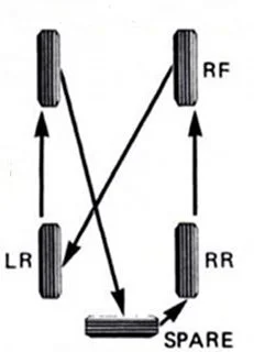

Additionally, the reality is 5 tires just presented a bunch of added work having to drop the spare every time I wanted to do a rotation (5 tires). Ultimately it just never proved valuable. Furthermore, I struggle to envision a scenario where I'd lose a tire, change the spare, and head deeper into the unknown without a back up plan. I'd with absolute certainty drive straight to the nearest DT and replace the bad tire.

If spare is one of 5 of like size, work it through with tire rotation, that should fend off dry rot of an unused tire. That's what we suggested to clients when i worked in a tire shop eons ago.

Since there is room a 33x10.50 spare under there, I've always subscribed to the 5 tire rotation to get the most out of a set of tires - until one is not useable anymore in regular driving. That also makes sure the spare gets attention, and it's not flat and cracked 6 years in after no thought when you need it....as an aside, on 2 different trucks I presently have a tire with a sidewall cut that's been patched - which I will no longer rotate in as normal, but will retain as a spare...opinions may vary on this practice, but I've patched (internal glue on + cement in cut) tires that I've used for years off road and for "farm use" with no issues. I carry plugs and a compressor too, and the most likely source of a flat from road use is a nail or the like - so if I had one of those, I'd simply plug it and carry on. I wouldn't use a sidewall patched spare for high speed road use for any prolonged period, but to get out of the backcountry I'm confident it will be fine if needed. I would feel a little wary of a tiny street tire as a spare off road vs a full size matching spare - with limited clearance and open diffs, that could present a problem...
This notion of 'spare gets attention' is quite valid in my opinion. It kinda puts it square in my face that I would at most be avoiding 'work' of having to drop the spare every time I rotate because if I have half a brain I'd be dropping the spare near every time I go on a road trip or in the backcountry to avoid getting caught with a dud spare. As stated, the spare needs attention regardless.

I am leaning towards just biting the bullet and do what I've always done. 5 tire set, 5 tire rotate. As I said in a previous reply, it forces me to engage in best practice of putting hands and eyes on the spare routinely so as to not get caught assed-out.
