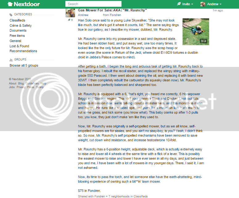

Also, I made a for-sale ad for my green and yellow Yard Man mower. @Spivey would appreciate this.

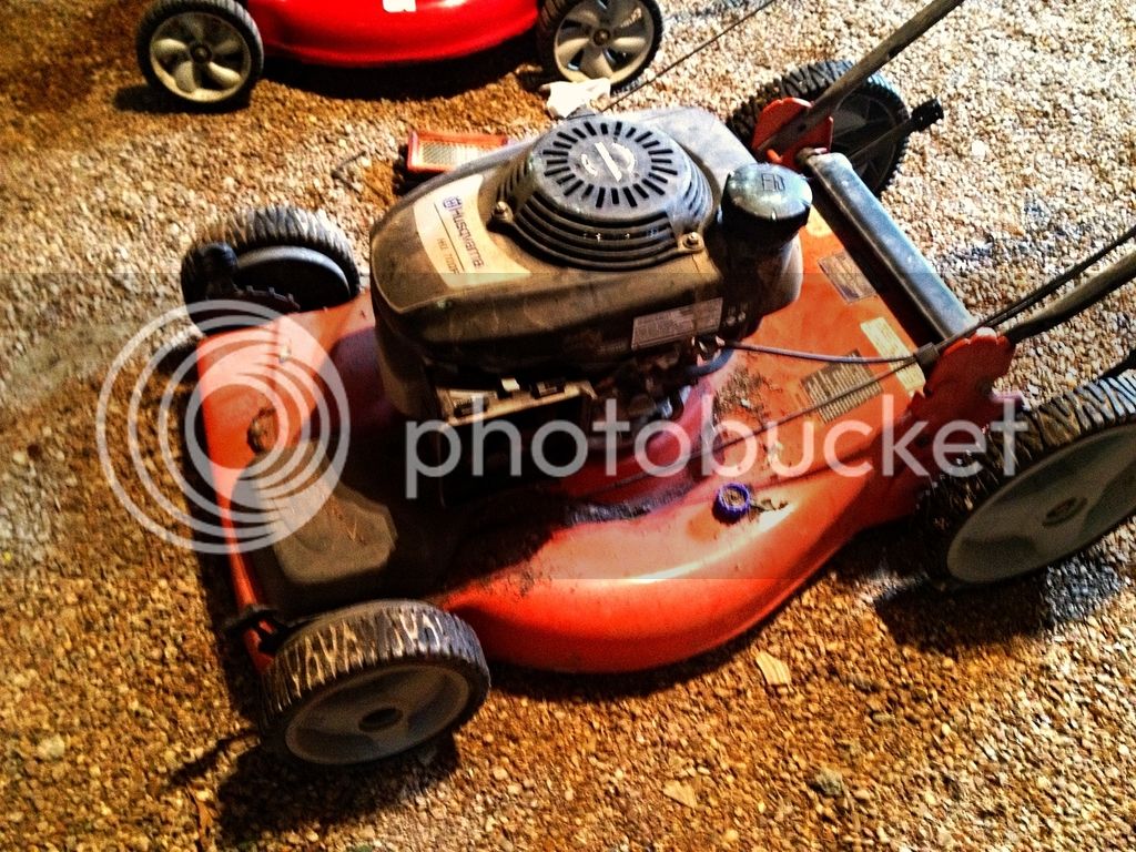

Got my hands on another Honda today. The owner said "It kinda stopped working last season. I only used it a few times."
My butt.

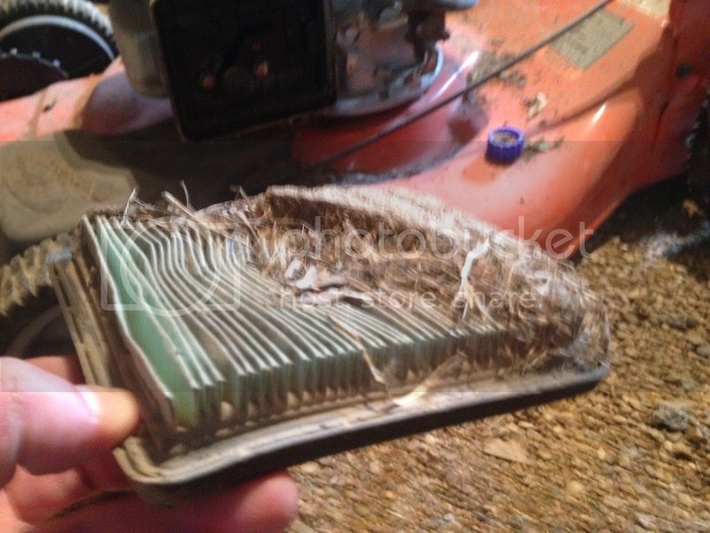

This is/was one of the dirtiest filters I have ever seen.
Cleaned the filter, rebuilt the carb, and changed the gas (gas was brown it was so old).
Now it purrs like a kitten.

Got "Mr. Raunchy" aka, the green and yellow mower sold today.

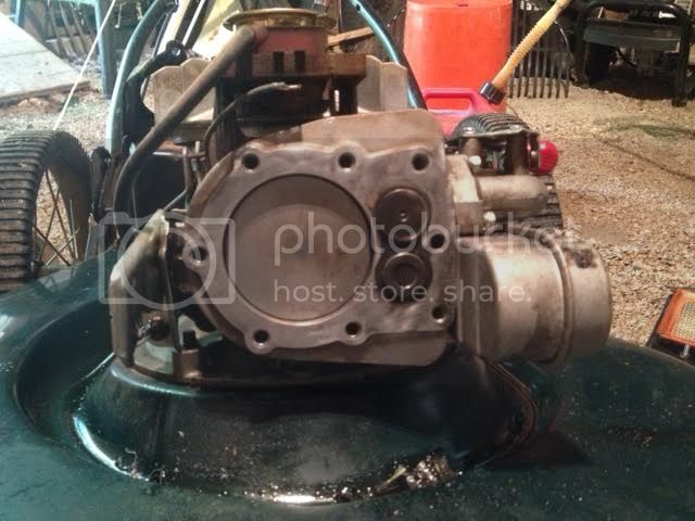

Pulled the head on the Tecumseh, cleaned off all the carbon, and replaced the bad head gasket.

I've had an old push mower sold by Kmart in my garage for the past two years that my in-laws gifted (dumped, more so...) to us. I had worked on it when I first got it, but I can't remember exactly what I did. I think I broke the pull starter when I first messed with it, so then I got that fixed, and then it was very difficult to start - almost like it had increased compression or the decompression feature no longer existed. Last night, I pulled off the valve spring cover and muffler to see if anything was sticking. Valves seemed to be working, so I took off the head cover and broke a head bolt in the process. I figured it was at worst garbage at that point, so I kept going. Cleaned off all the carbon on the valves, piston, and combustion chamber. Bolted it back together, and I'll be dang'd if it didn't start on the first pull with zero gas in the tank. Hot dang!
Now, it needs a new blade and the mounting surface for the blade needs attention. It once had two dowel pins in the mount for the blade that are both chewed off, so I'll take the mount to work and put in new pins.
