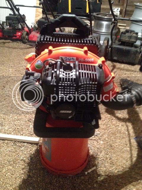

Friends don't let friends run a brand spankin' new Echo PB500T backpack blower without oil. :bang:
Engine was completely seized! I made a special concoction of 2 cycle oil, WD-40, and PB Parts Blaster, and after removing the spark plug, let it soak for a few hours. After a little elbow grease, I got the piston in move. Fresh gas a a few pulls of the starter, and she fired right up.
There is still a ton of carbon built up on the piston head, so I am going to get some Sea Foam, remove the plug, and soak the top of the piston for a few hours.
Please, everyone, don't think you can get away with running a 2-cycle engine without oil!

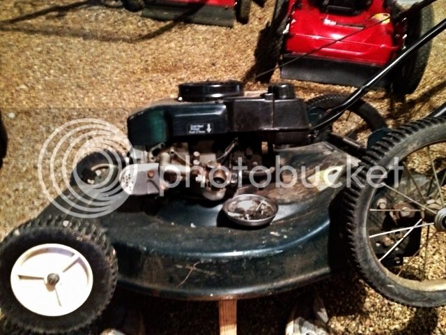

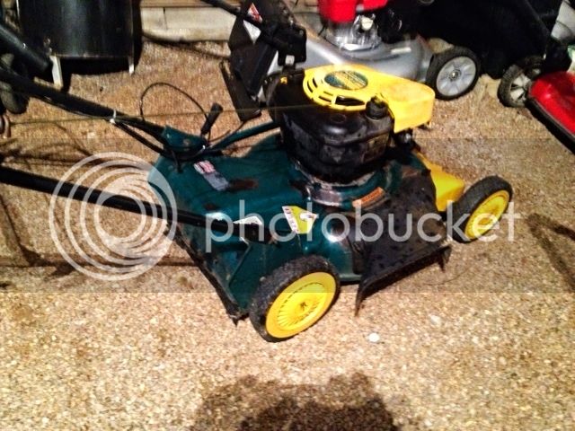

Also, you remember that beat to hell green and yellow mower I had given up on a few weeks ago?
Drumroll please.....
I got it cranked! It needed more carb work, and a new spark plug. After I got it going for a few minutes, I opened the oil tube. A shower of oil shot out of it. The oil was the color of a vanilla milkshake! Looked like there was even more water in there than I had originally thought! I got the oil changed, and after a little fine tuning, she is running strong. I am still planning on removing all of the self-propelled mechanism, as it is broken, and very heavy.
