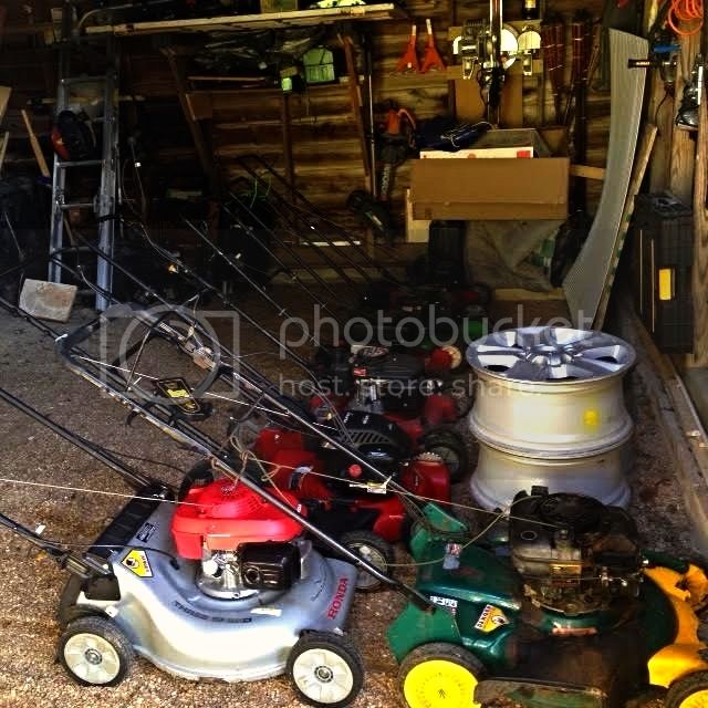

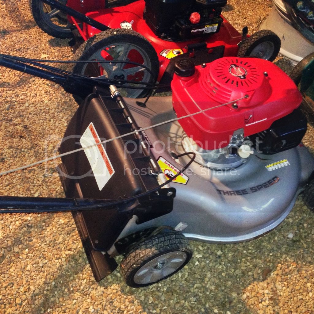

Grabbed this 3spd Self Propelled Honda on my lunch break. Looked clean, and there was a tag on the handle where it had obviously had work done in the past. My guess was that it was unfixable and the owner threw it out.
Brought it home and studied it (more complex carb than a Briggs) and tried to start to no avail.
Rebuilt carb and added fresh gas.
Started on 3rd pull.
:bounce::cheers::smokin:
This will be my personal mower for now on.
I'll pressure wash it later today, change the oil, and sharpen the blades.
Everything on it works perfectly. I'm ecstatic.

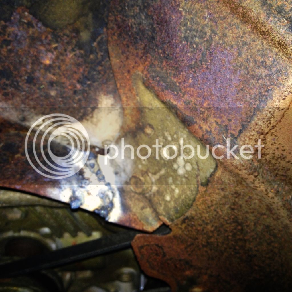

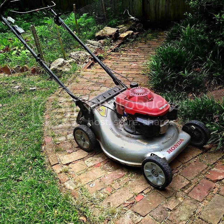

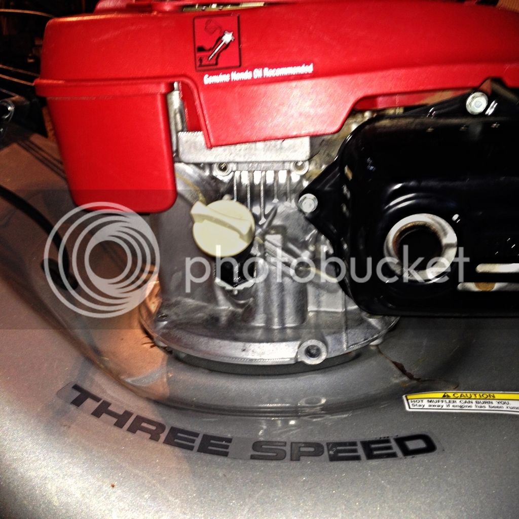

I just want to show off this Honda a bit more. It really cleaned up nicely yesterday. I went ahead and tightened the recoil starter, sprayed everything down with Simple Green and pressure washed it, changed the oil, degreased the intake, and found a part on the underside that was rattling. The previous owner had banged it pretty bad on a root or rock, and the metal blade shroud had cracked in half. So I flipped it over and welded it back together. Welds still don't look great, but then again, I just started welding last month. It looks much much better than the last thing I welded, so any improvement is always a good thing.
Damn thing has a 3 speed t-fer case in it! Awesome!

Andrew, make sure your metal is clean before you weld. That will help a lot with making a better weld.

Thanks for the advice @Jordan7118 I need to not be so lazy. I also need to go from using flex core to actually using shielding gas (still need to buy a cylinder). I know it will look a whole lot better if i do.
Yeah, solid wire will make your welding more enjoyable and no more chipping off the slag covering the weld.
