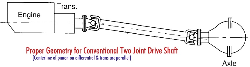

Point the rear output flange straight to the transfer case and the double cardan joint will be vibration free, otherwise it'll vibrate worse than a conventionally jointed driveshaft when the output flanges of both the diff and TC are off more than 2 degrees from parallel.
I'm betting you've already covered the bases and comments about were tongue in cheek, but if not, may check the output flanges of, at least the rear to make sure the rear flange is at 0 degree to drive shaft angle, or 2 degree variance that's stated acceptable.
Can't fathom why the front would need anything beyond single joints, but surely a reason.
The front shouldn't vibrate at speeds typical 4WD operation, but wouldn't think a standard would either.
A rear with a double cardan that isn't within the parameters above will vibrate like crazy, at least in my experience, being the lifted 80, which is the most sensitive on the planet, since AWD.

Can't say for sure, since the pic is small on iPhone, if they modified the joint to increase operating angle, but thinking the 1350s maxed before a standard joint, but from memory of battles on mine.
Betting all bases were covered and probably not an issue, but have seen very few double cardan rear shafts and most on the 18" lifted Icelandic rigs.

Before I said anything, wanted to check again. My rear output flange is pointed down a few degrees, towards the rear pumpkin. I knew they weren't parallel, so thought I could get by with the cv joint. You got me thinking about it and you were right. I'm 8 degrees different, too much to run conventional, so I ordered some 6 degree shims. The front is fine. Thanks for keeping me on the straight.
