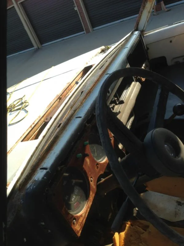

Beat my head on the dash all day. I'm not done, but wanted to explain what I'm trying to do. I'm committed to eliminanting all the padding, so I cut off the body seam, on the top of the dash and started welding the two together.
The dash has slots punched in it for the pad adjustment, which dented the metal pretty good. Got all those filled in and working on filling all the unused holes on the face of the dash.
I would like to leave the Landcruiser name plate alone, without the hole in it, so I'll have one made.
I cut off the bottom dash add on, which had the vacuum shifter, etc. Don't need any of that hanging down.
A long way to go, before it's ready for paint, but working on it. :)
This isn't for most of you, but I know what I want it to look like, in my head, just hope it turns out, trying to keep it stock looking, if that's possible anymore, we'll see.

If anybody is planning to do this, the seam holds two pieces of the dash together, which are at different angles, if that makes sence.
When you cut that seam off, the gap will widen between them, so welding becomes harder. Also the whole dash is pretty wavy, with those slots punched in there. To look pretty, you might need some body filler.

I used a die grinder with cut off wheel and cut the entire thing off, but I didn't cut too close to the bottom. I left 1/8th inch standing. The two pieces are spot welded up high and I cut below those.
I then used a flap disc and ground it down slow, on one end first. When I discovered how thin the metal was getting and a gap started to show, so I started tack welding, with the mig, before grinding anymore down. I worked my way down the line and I'm still working on it! Alot of touching up and rewelding, for me.
Somebody that knows better, might have done it different, as mine is alittle wavy. The body shop will fix that or like Delancy offered, Monstaline it.
This is a new adventure for me, chopping on a dash and I believe it will turn out. I'm not out to win a car show, just look good and work.

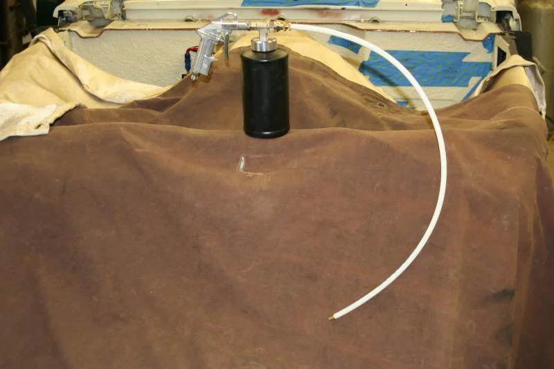

I bought a third undercoating gun :rolleyes:, that has a two foot hose attached, so I can reach in the cowl and roof pillars, etc. They will all get the treatment.
