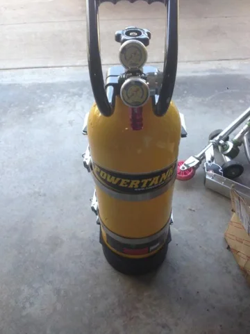

Y'all sure go to a lot of trouble to do what this can do......
Granted, not an endless source, but convenient and fast. Can air up 37x12.5x17s from 8psi to 35psi in about 30 seconds and a high quality regulator runs pneumatic impact without freezing up.
Low maintenance and $20 to fill a 20lb tank at any fire extinguisher filler, which is good for (20) single tire air ups (37s. can get (20) 35s from 15psi-35psi on a 10lb tank) and will run (most) air tools for sometime.

You don't use that to run your air lockers, do you. My luck, I would run out of pressure, right when I need it. Do you fill it everytime you go out camping, etc., so you know it's full or gamble with half full or half empty, depending on how you look at things.
Delancy, You don't use that to run your air lockers, do you.
No, (elocked) though they can be used for, but a bigger PITA to plumb.
I forgot about the ARBs. My bad, once again, today.
I weighed it empty and note the amount of fills on the side of the tank with dry erase. If its questionable, I'll weigh to make sure I've enough before heading out.
