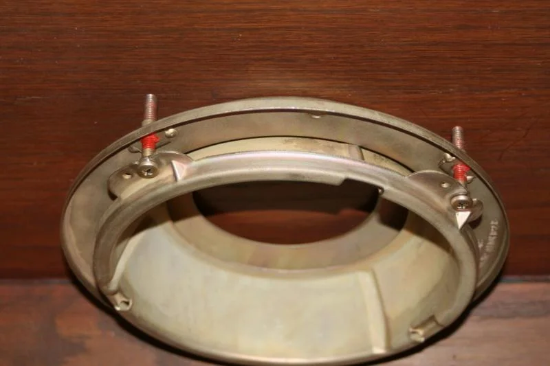

My headlight buckets were pretty bad with rust and some of the plastic threads for the headlight adjusters, were cracked or broken off. So, I used some weld nuts, which worked great, but they didn't hold the adjuster bolts from backing out.
I found a product called Vibra-Tite, it's a thread fastener. You just paint it on the threads and the bolts won't back out. You can reuse the bolts and the stuff stays in the threads. I got it alittle too heavy, but still seems alright.
They turned out good, media blasted and cad. plated.
Here's some pictures of the old one and how it turned out.

All I understand, is it's called Cadmium #2 yellow. To be honest the guy confuses me more every time I ask him about it. The yellow is alittle soft, but the Cad., he says, is twice as protective as a Zinc plating. :confused:

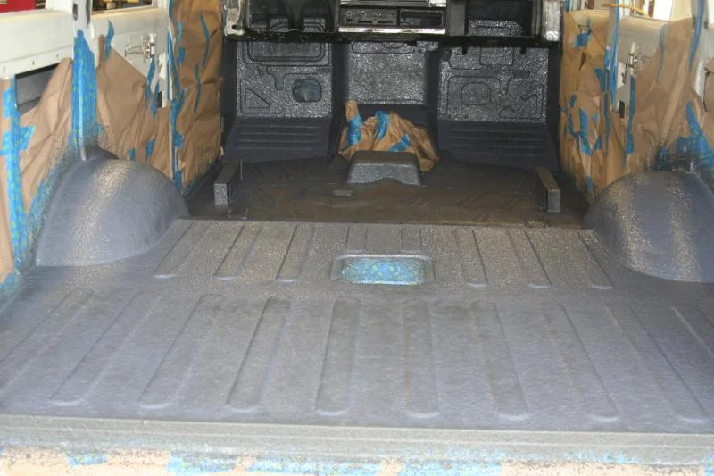

The white Lizard Skin showed up Saturday, so I tried it out. My gun was acting up, on the first coat. I found the vent clogged, so the first coat was thin and didn't cover at all.
I shot the second coat today and it turned out alot better. Due to my mess up, I'm going to shoot a third coat. This white Ceramic Insulation is the stuff that holds back the heat, so I want it right.
Hoping since it's white, the tinted Cygnus White Monstaliner will cover better. By the time I'm done this floor is going to be 1/2 inch thick. :rolleyes:

The final coating will the Cygnus White Monstaliner and it doesn't cover over the black very well. So this might work better. Everything is so textured, the different colors don't blend well.
