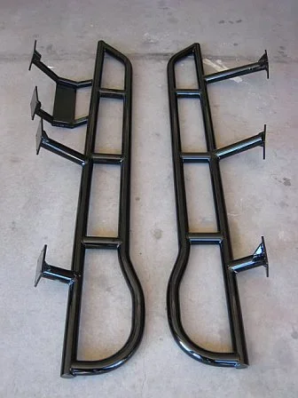

Oh, you mean like these!:clap:
Yes like those. I knew you had done that with yours and I think it is a great feature. In addition to the help they offer when wheeling, they also provide a better step option for anyone getting in or out of the back seat. My boys have a very small section available to step on with my sliders.

So, a little update. I made it out wheeling a little this morning. Hit Providence Canyon in northern Utah. Turned into an icey mess and got really scary on the trail. Came back down into the quarry at the bottom of the trail to play around.
Many people have been skeptical about the Marlin Crawler/Trail-Gear sliders being used on an 80. Some feel that the HREW will not hold up on an 80 and that they are not strong enough since they were designed for a minitruck. Well mine have worked really well since I put them on. The first real test was a couple trips to Moab where they performed perfectly. Today was no different.
How bout the entire weight of the truck on the driverside slider? Both driverside tires in the air. Also came down on it really hard a couple times while attempting the obstacle. Slid along on them for about half the length of the slider. No real flexing, no body contact, no denting of the tubing. Worked just as they should. I just thought I'd update a little since people have asked about them holding up and just wanted to show that they do and that they are a great less-expensive option for sliders on an 80. These are the 67" minitruck sliders from either Marlin or Trail Gear.

I followed this build and bought from Marlin, too. I decided to make mine bolt-on and used a u-bolt design using George's drawings at the frame mounts. Worked out very well. I was able to use the 12" legs included for 4 of the mounts (trimmed to fit), the front ones are much longer. To go under the cat, I used round tube, but in 2 pieces welded to a 1/2" barstock directly under/between the cats so it wouldn't go any lower than the cat. From this would be easy to build a cat skid similar to the metal tech sliders, but I haven't done it yet. I also trimmed the pinch weld to put the sliders as high as possible. In doing so, I had to notch and reweld the middle leg at an angle to clear everything. I didn't use the included gussets as they are pretty tiny. I made my own from 1/8" flatbar to extend more of the length of each leg, as those long front legs seemed like it could flex a bunch and I don't have much tolerance for flex with the pinch weld gone. They got a couple scrapes at CM, but I found all the other stuff underneath was likely to drag first. Didn't lay on them hard to see how much they move yet.
