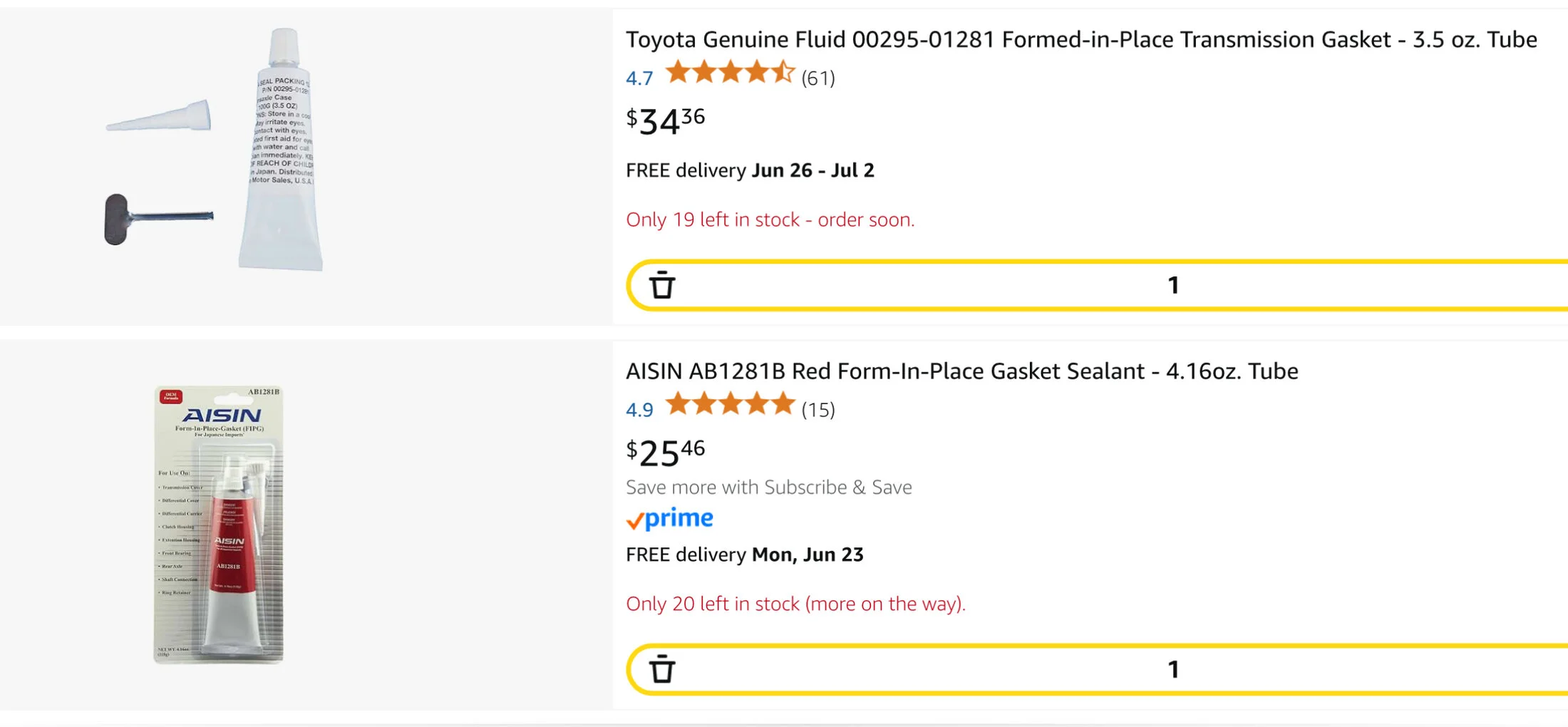

i’m sure they are different, but do they accomplish the same end goal?

Amen to that! I bought a tube of the OEM FIPG and it doesn’t work! I have sealed my transmission pan on my 80 for the second time and it will not seal and I thought it was me? I’ve done this service several times and have never had this issue of the FIPG not making a seal.
I threw this out there just in case Aisin could be a better product?
But can you use a non OEM product on a Land Cruiser ?
You can use anything as long as it's ATF compatible; a gasket will work, as long as the pan sealing flange is flat. The problem is the pans are so thin that the flange gets bent easily and then the gasket won't seal. That's why Toyota used the FIPG.
