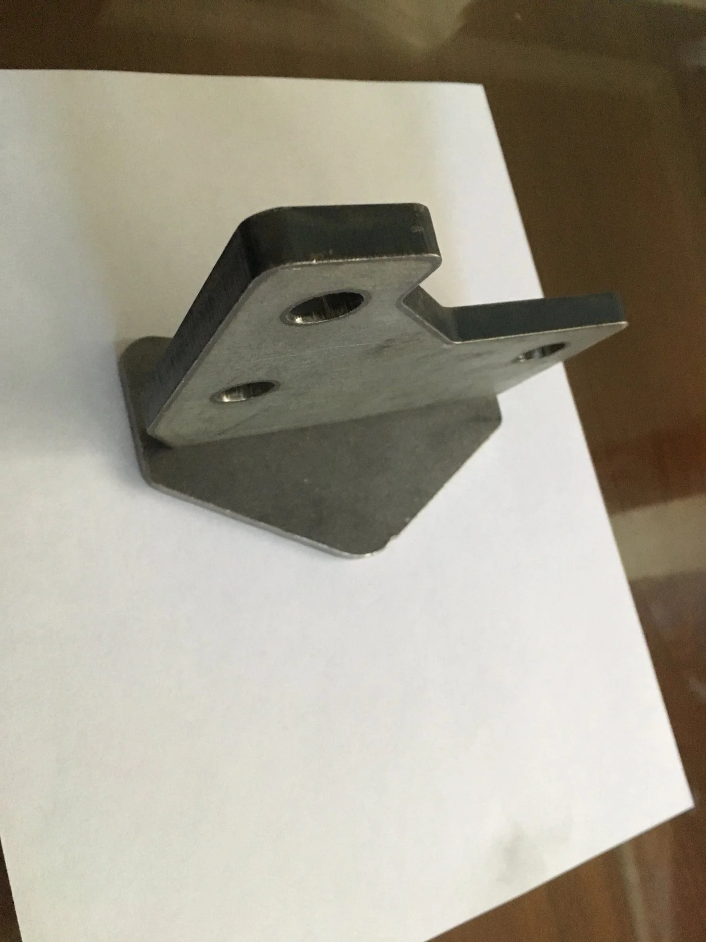

can anyone help with pictures or idea .
The odd shaped plate without holes is a scab plate that gets welded to the frame at the point each leg meets frame .
The three hole plate wleds to the frame and the slider bolts to that. The slider itself doesn't bolt to the frame but to those stubs

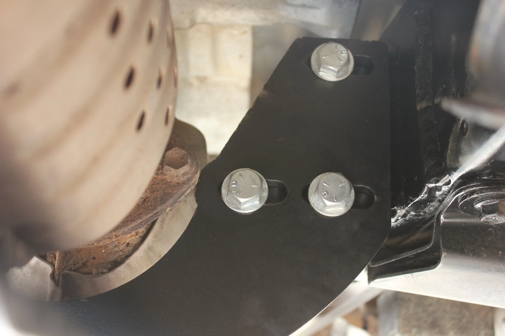

like this ?
Yes.

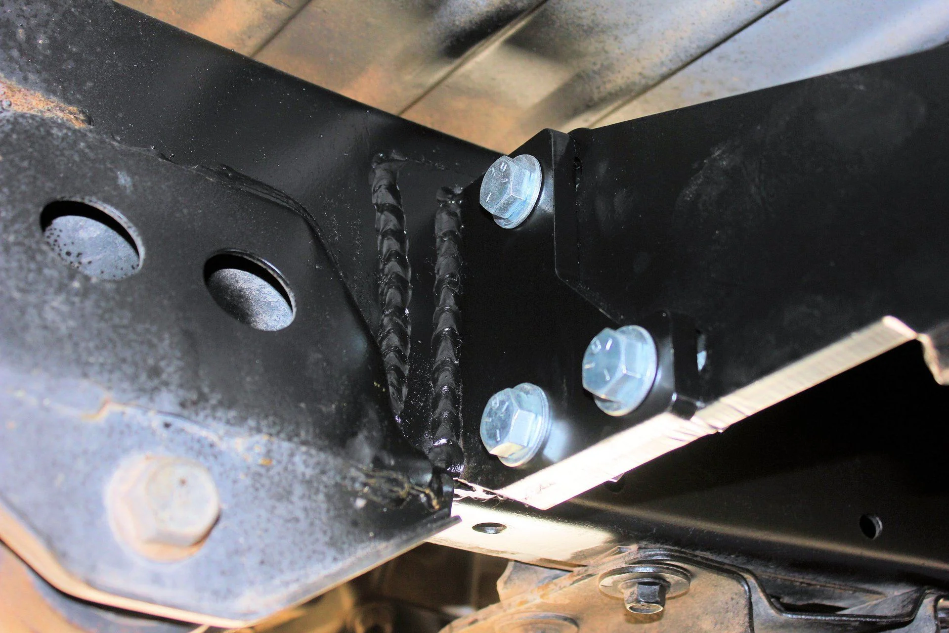

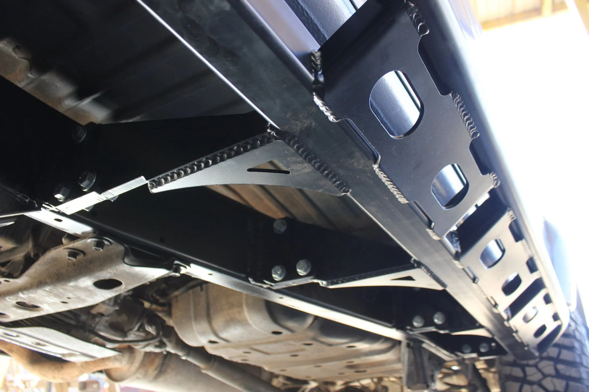

Generally you loosely bolt the three hole plates to the sliders with just enough play between the mounts and legs to move them around. Position the sliders where you like them with a jack or stands and then place the scab plates where the legs meet the frame. Whether the mounts are on the front or rear of the legs doesn't matter but I suggest keeping it uniform. If you have one mount on the front of the leg, place all of them on the front. This makes them easier to install and remove.
Tack the scab plates first. The legs are slotted so you can manipulate the mounts into the best position. I usually worry first about the
front and rear mounts when tacking the mounts to the scab plates. A good set of tacks will support the slider without the centers.
Before you full weld , with the front and rears tacked up, you should stand back and double check that they are level and such.
If you're happy, tack up the center mounts in multiple spots. Remove the slider for easier access then full weld. Clean and paint.
There's enough movement before tightening all the bolts that you can set them up tight when you're installing . The triangle pattern will
allow you to drop them a bit if you need to
