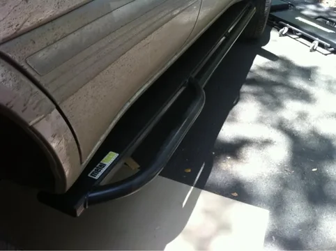

Those MT sliders look great... I've been super happy with mine.
Thanks jasonbraswell. Pa in law provided needed assistance and beverages. Here's mud in your eye: Both us us, literally. I knew better from t bar cranking but still have not learned the value of goggles. Now to find someone with header install skills...

Thanks to badlander for the floor jack and 2x4 technique. It made it easy to do my slider install solo. :cheers:
