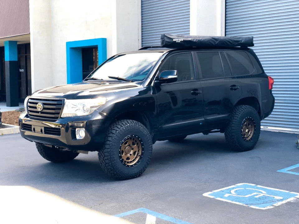

Here's some pictures of @drftsub 's 200 with the 35x10.5 Kenda's which he indicates he was able to run without excessive mods (No regear, excessive trimming, or KDSS relo):
Typically, the 285/75R17 (34" x 11") has been the reasonable go-to for the next size up from 33's, but now the skinny 35's can be a quite practical option with almost the same level of mods (proper offset wheels, lift, UCA's, fender liner work, possible KDSS relo). 2016+ LC200's even have updated gearing that seems to accommodate much larger tires without the need for a regear.
My question is, what would be the better fit, 34's or skinny 35's? Would the .60-.75" in *actual* diameter increase from the 285/75 prove to be a significant detriment in MPG's, CV axle/wheel bearing wear, rubbing, poor gearing for daily driving, accelerated suspension component wear, etc?

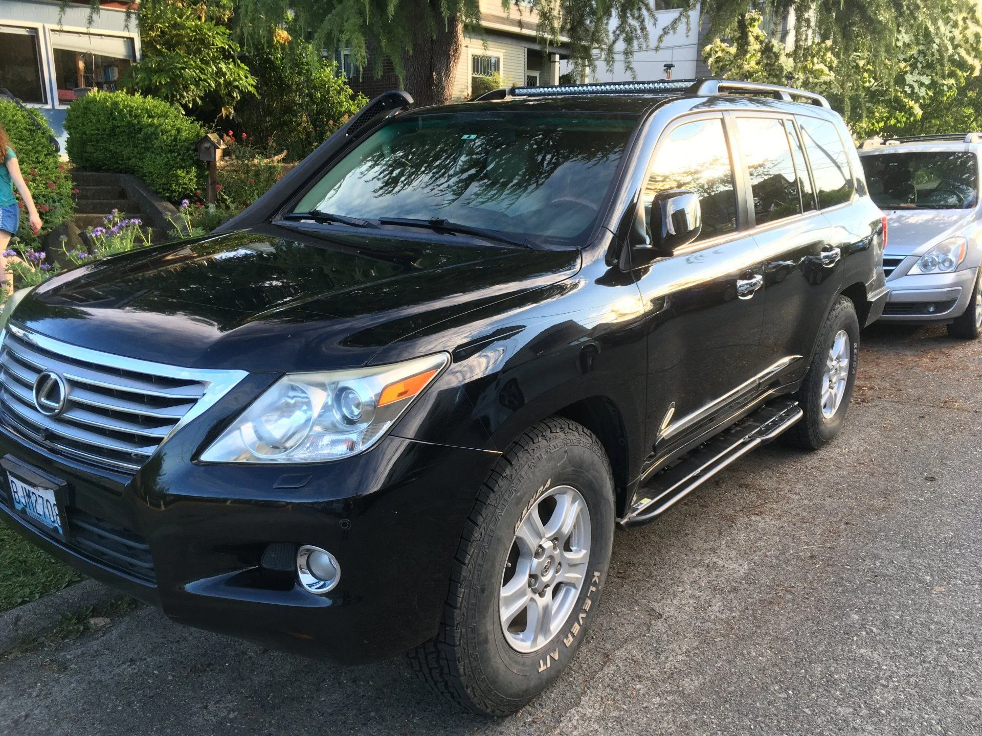

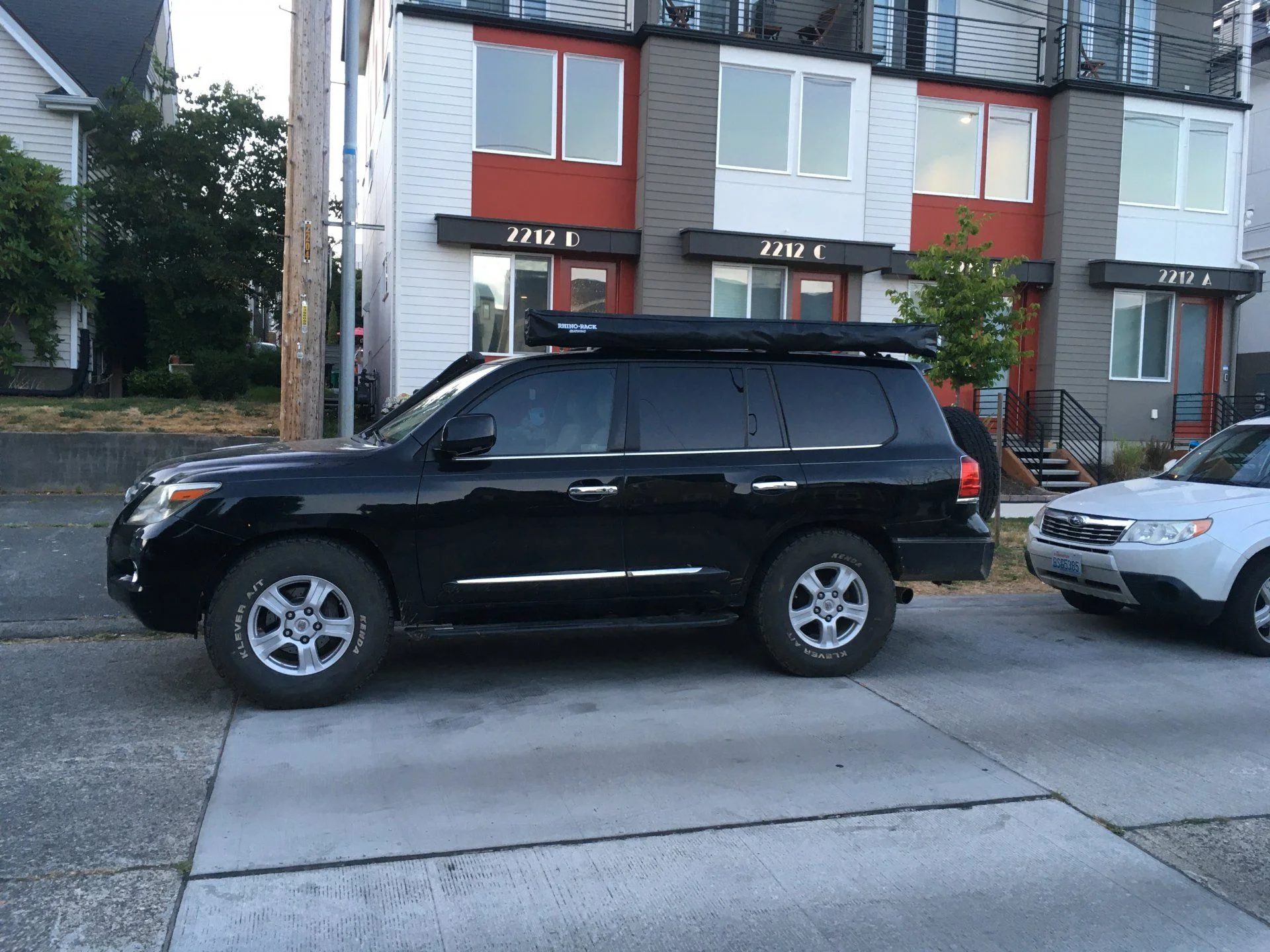

275/80r18 (35x11). Fit was easy. Minor liner work and a small AHC sensor lift. The benefit is more ground clearance when aired down. I did put in 4.88s.
Only drawback is it’s a mild a/t tread pattern. Hasn’t been a factor yet but it will be. On plus side mpg and noise are good.

Looks great! Very impressed that you can run them well with minimal modifications. What do your average MPG's look like?

I get 10 or 11 in town and 14-16 at highway speeds.
