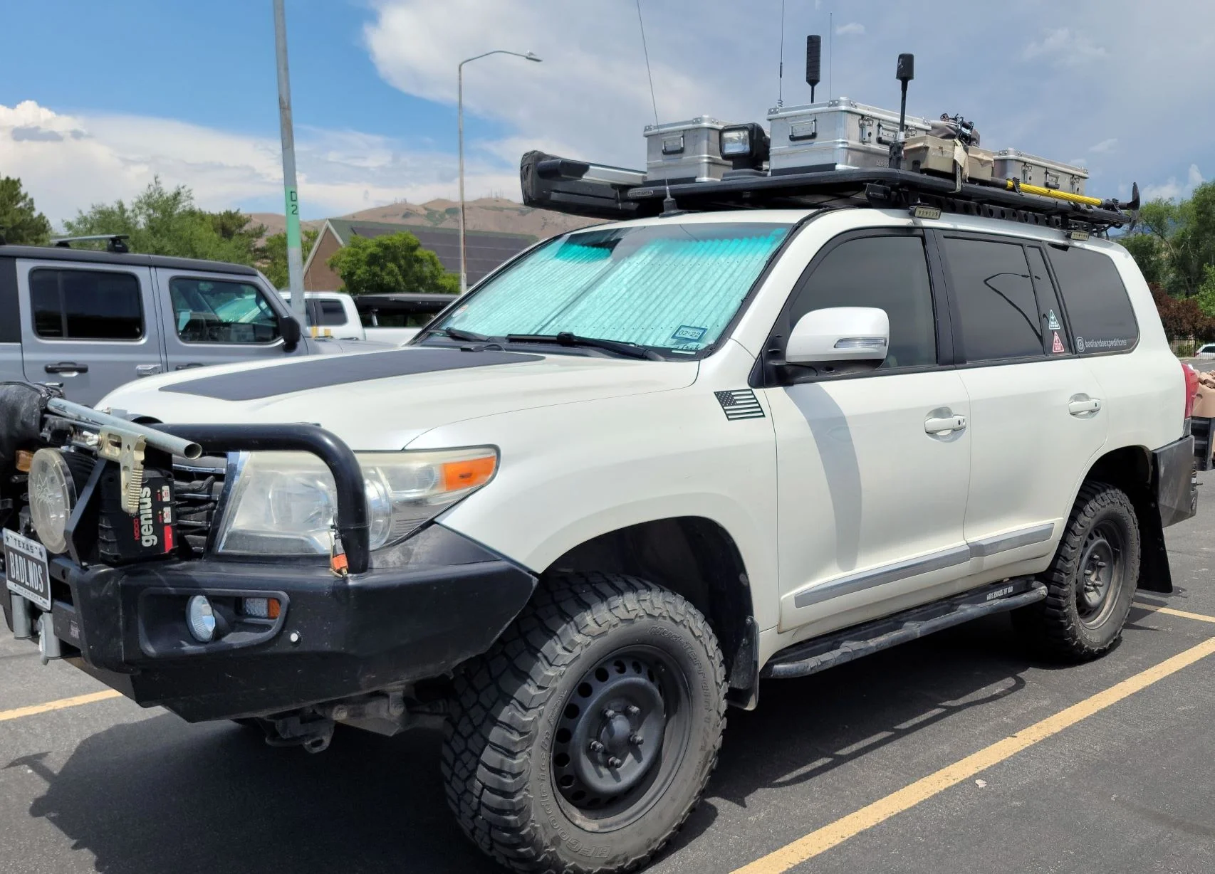

I have a 2013 200 Series with 4.88's . I made a mistake with these gears and am hoping to mitigate that mistake with 35" tires and get back into the stock powerband. I'm wondering if this size 275/80r18 on steel wheels would work? I currently have 275/70r18 tires.
The only downside is this 275/80-18 is only available by one manufacturer. Another size to consider 285/75-18 34.83 inches with more tire options.

What wheels are you running? I have steelies and a larger tire is going to rub.
On the 18s I ran OEM 18s from the tundra (60 et) and used spacers to get to 35 et.
On the 17s I’m n Alphaequipt Echo (35 et).
There aren’t too many choices in narrow 18” 35s. The Klever AT is one of them.
