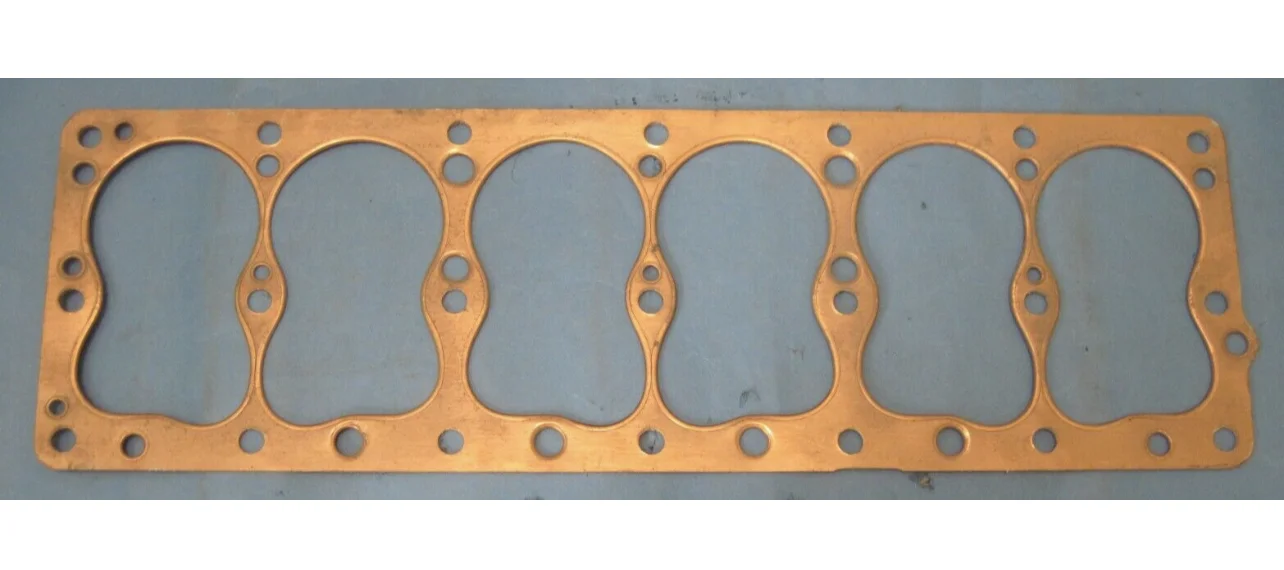

Used the copper spray on both sides of the head gasket of a 1963 Dodge M37 flat head 6 cylinder. No issues so far after several years of running. The head gasket of the 230 cubic inch flat head 6 is ALL copper. No other compound on the gasket.
From what I understand its needed for copper gaskets, the engine has been together for about 2 months now and running perfectly
