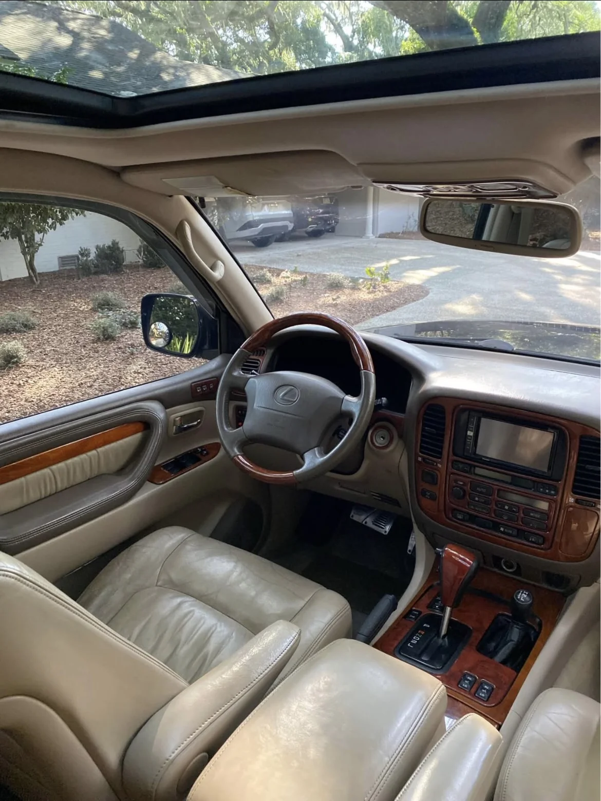

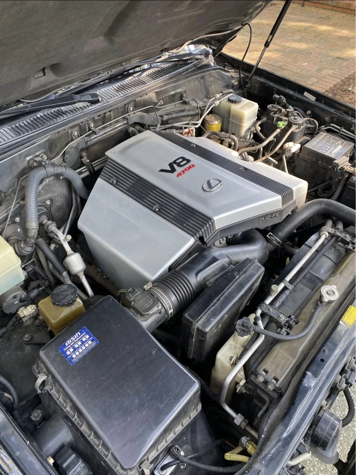

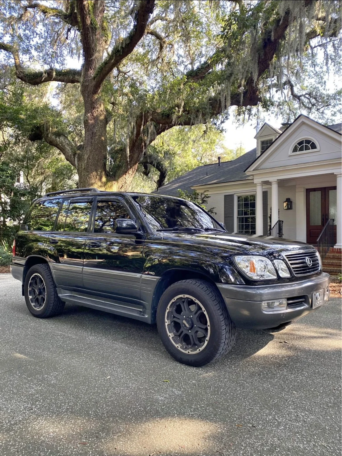

I passed on this 2006 one because I couldn’t get a peace of mind from the rust (and the AHC wasn’t working neither). Since I’m in GA, I’m aware I can get rust-free ones. Later today I checked out a few other options and finally settled with a 1999 one - rust free, working AHC, new tiers and good maintenance records for the past 4 years - for $13500. We will transfer the title tomorrow. The only issue is that the steering wheel doesn’t move front-back, only up-down.
Initially, I really liked this 2006 one because of the added horse power. However, after driving a 2006, 2003 and 1999 one, I didn’t notice too much difference. All 3 has enough power for me.

It has 215K miles. There was another 2003 rust free fully working one asking for $10K. I chose this 1999 one because the previous owner had an engine overhaul in the past 4 years (costed him $8K) and I like the interior better.
I did the best I can do. I’m only staying in GA for a few days before going back to NJ, and the plan to buy a car here in GA was very last minute. I browsed through all LX470 listing online, ran all over places and checked out a few of them in a day, which was EXHAUSTING. I am 90% happy with my decision here and 10% sad that I didn’t have more time to wait for better ones.
