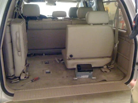

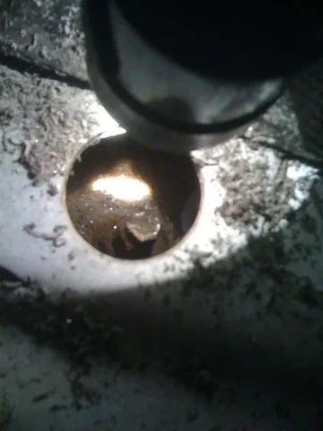

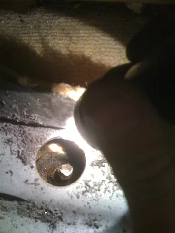

Drivers side shock... drill a small hole... (small meaning about 1in) I started by using an air chisel from underneath and marking a dent from underneath in line with the top of the shaft.. when I popped the carpet back the underlay was cracked right where I dented it giving me a point to start my drilling... be careful as there are some lines underneath so drill slow and shallow...
hole
again
I did use Duct tape with a ring of sealant on the floor surface and also on the tape itself to make a seal once I was done.. for some reason the pictures didnt show on the camera so I am not taking more..
