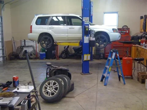

I am not too worried about the shocks.. I live in MN and worked in teh industry for over 5yrs...
also this setup in my workshop helps ;) :steer:

what a nice setup. won't help you much with the right rear shock, though. Patience is what you will need for it.

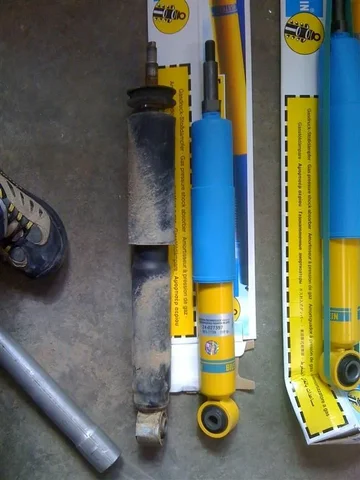

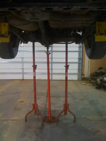

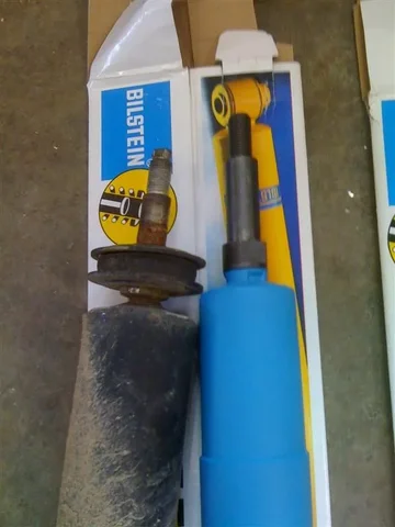

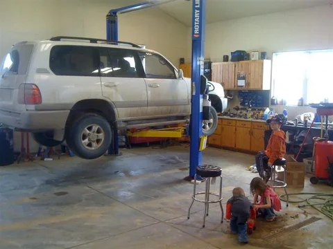

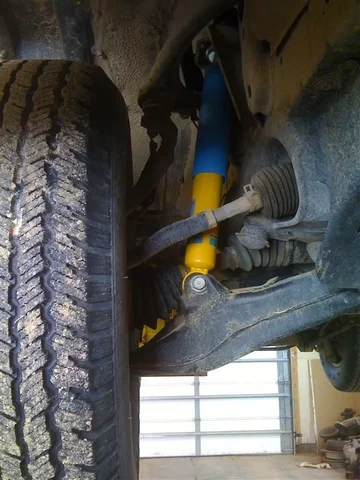

I took some pictures of it...
Took me around 2 hrs.. TBH 2.5hrs cause my left arm got tired on the Pass/Rear taking the nut off... been a while since full time wrenching...
some pics...
3 of my helpers... 4th one napping
old vs new (not shaft thickness)
old vs new
