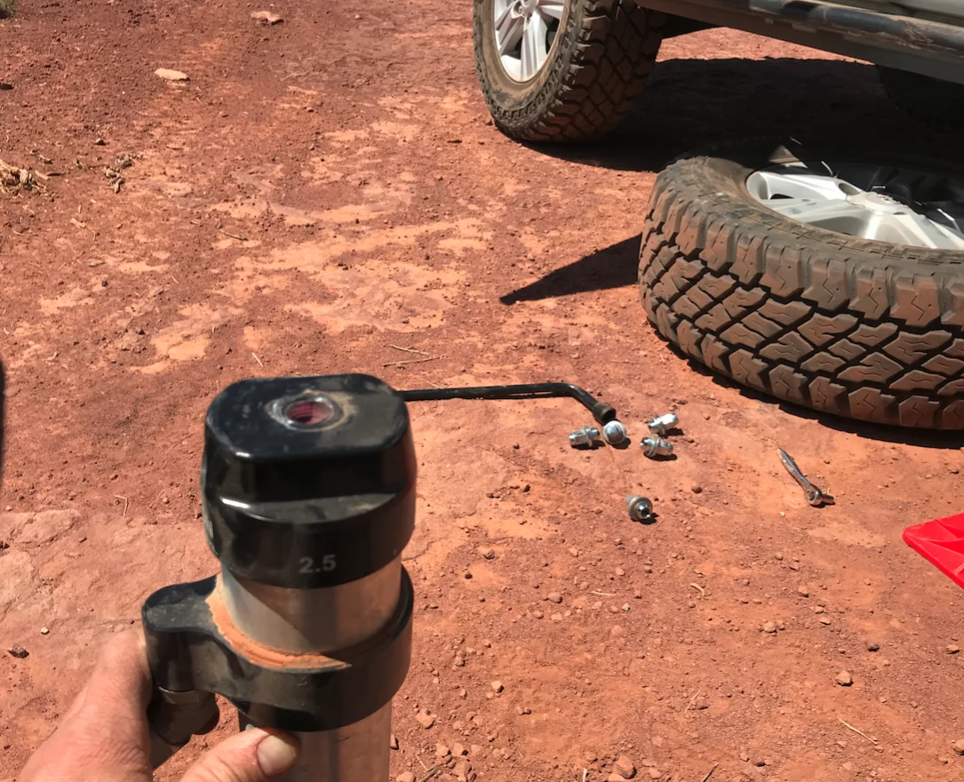

Yep, Lockhart Basin Trail, 2018. Happened to me. Top stud was cross-threaded at the factory. In fairness, defects happen and Icon had a new set drop shipped to a UPS store in Flagstaff for me to pick up. Was a long three days with BOTH rear shocks inop! Which some may say 'why even consider rebuilding'? Aside from this defect and the early wear-out, they actually perform very well on my truck.
