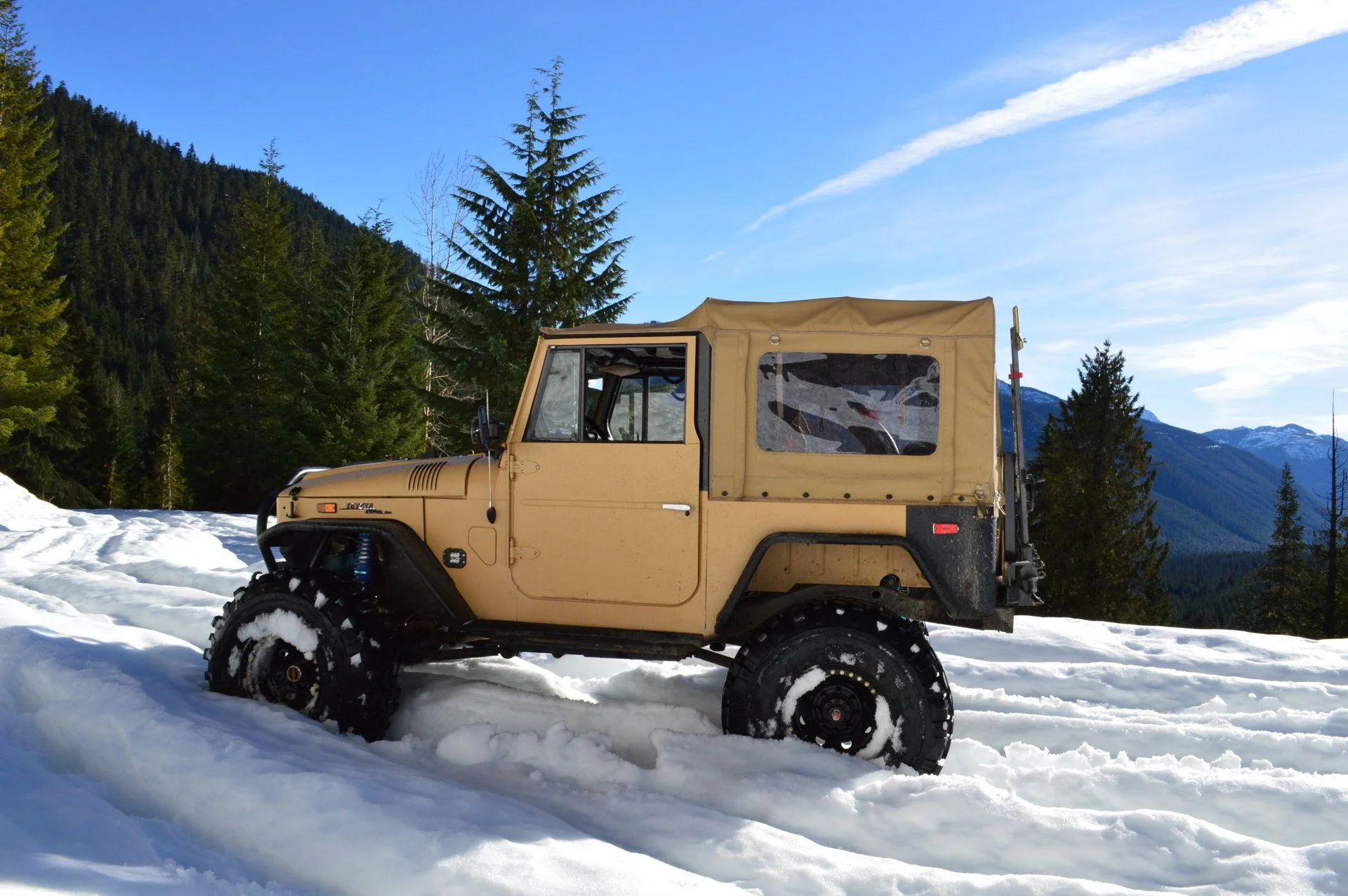

This continues to be the best response to the trolls - and it's funny, someone was telling me you can't wheel in the snow with swampers. This is the picture I responded with....
You just need bigger rocks. Mine is about 115" wheelbase and I'm pretty sure I can flip it over backwards
I've also heard that you can't snow wheel with stickies... I'm planning on testing that out this winter. LOL!
