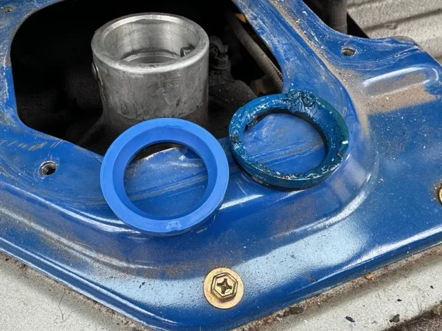

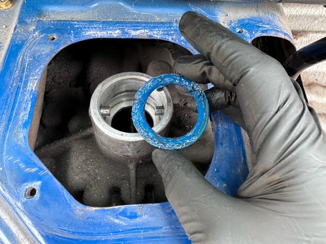

Got the new shifter seat / bushing and it totally fixed it. The old seat was falling to pieces. A few notes for others who need to do this:
- The part number for the shifter seat is 33505-60011 and the part number for the dust boot is 33555-55011. Both are available from Toyota.
- I think you could do it without pulling up the carpet by accessing the four screws that hold the shifter boot in place.

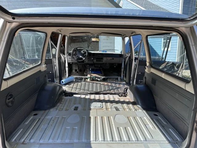

- I removed the carpet and ordered a new carpet from dnp. I've wanted to replace the carpet for a while and used this as an excuse.
- My dust boot was also toast and I think it's worth replacing regardless as a new one is $15 from the dealer.
- There's a special tool to remove the shift lever but it's not at all necessary. You just need to push down and turn. Not much force needed.
- I pulled the rest of my carpet to get ready for the new one. Pulling it is easy. Replacing sounds like a full day job.

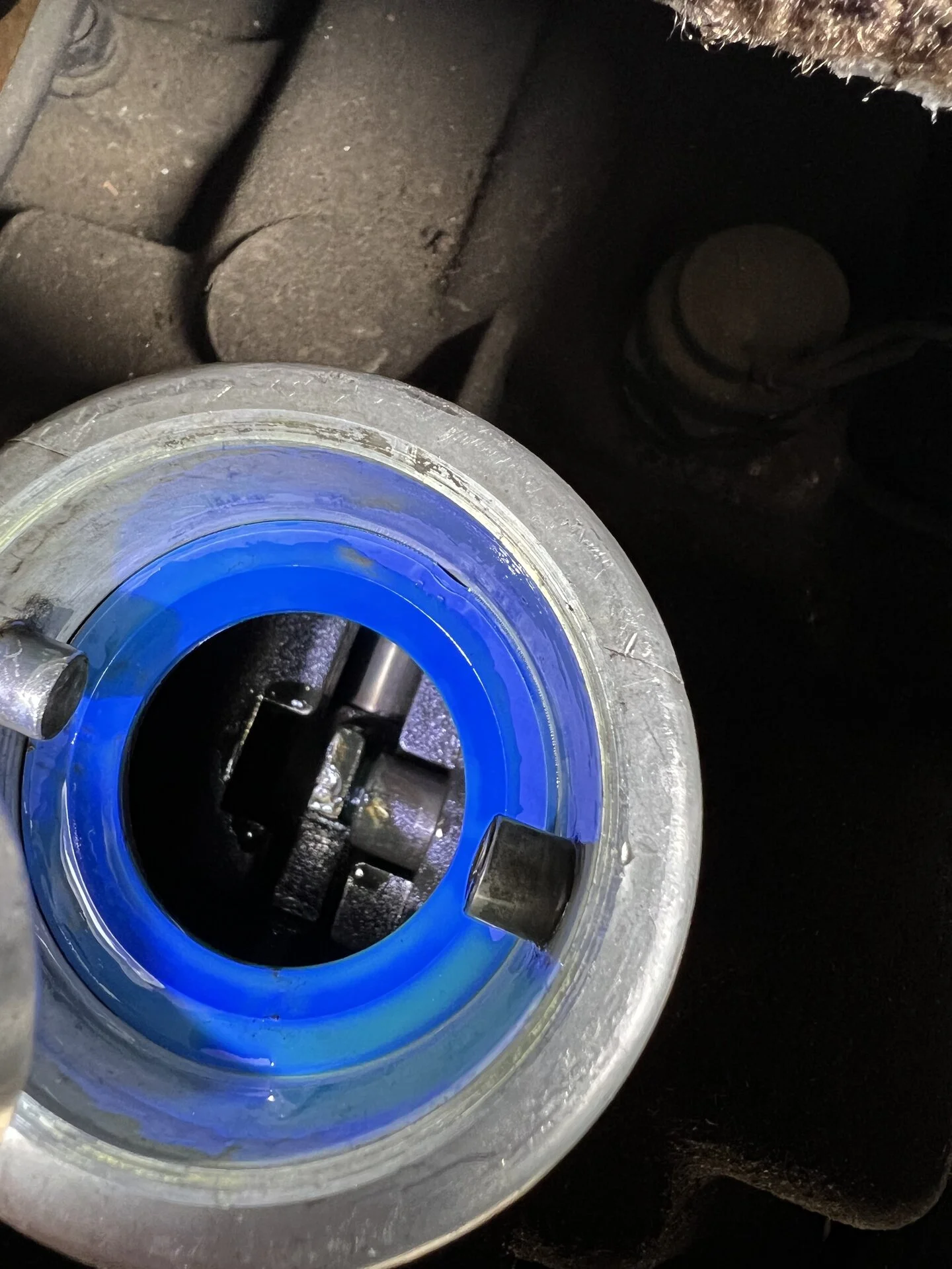

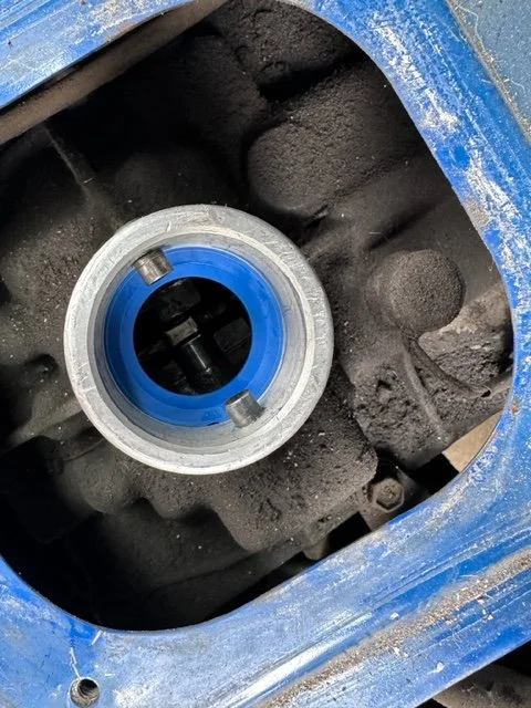

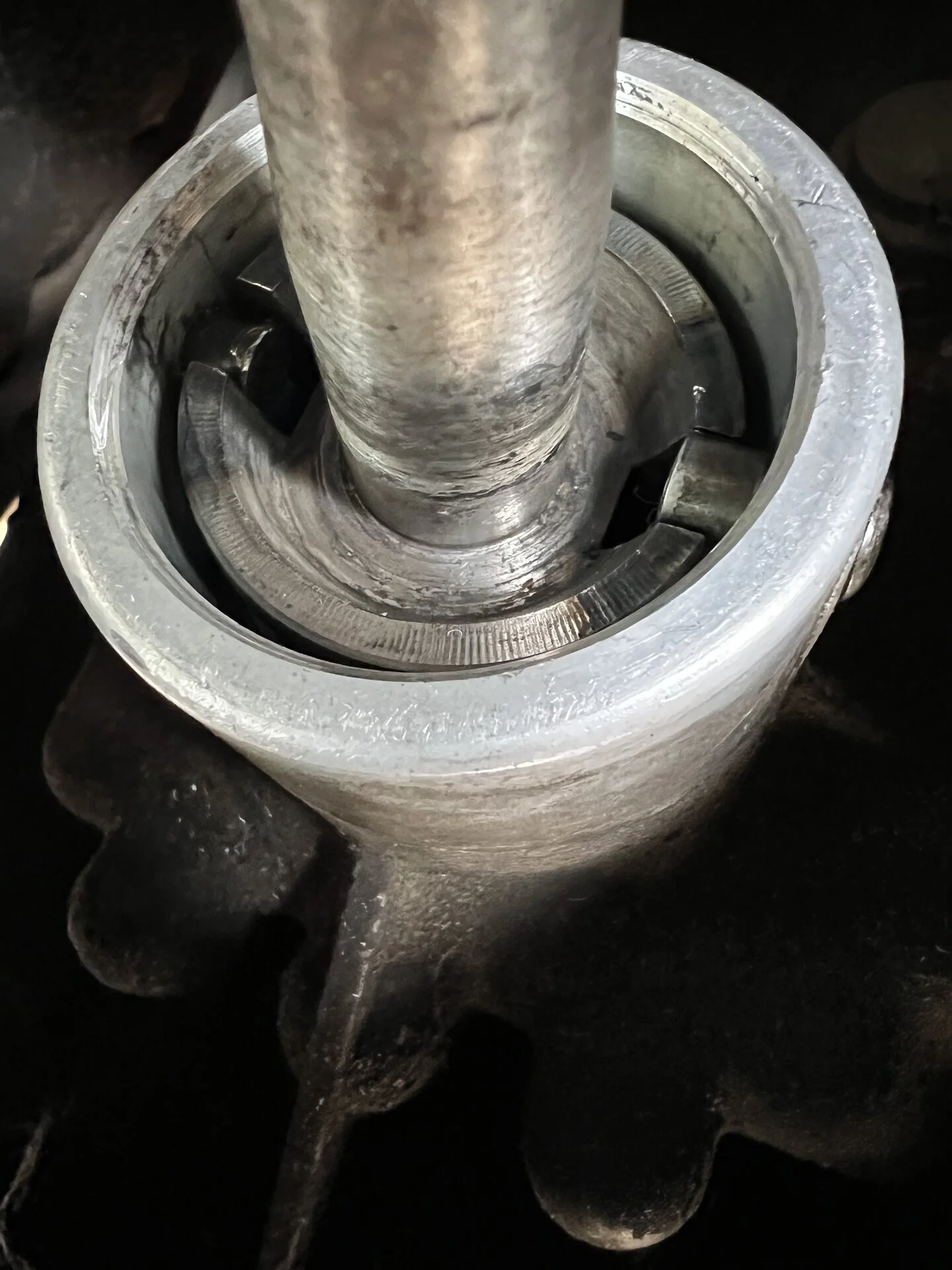

Photos in no particular order.
Inner boot slides right on. Super easy. I used gear oil for lube as whatever you put on there would just get washed away by gear oil anyway as the shift mechanism is exposed to the oil from the gearbox.
The two riveted side pins can get loose and allow too much slop in the shifter as moves across the forks.
